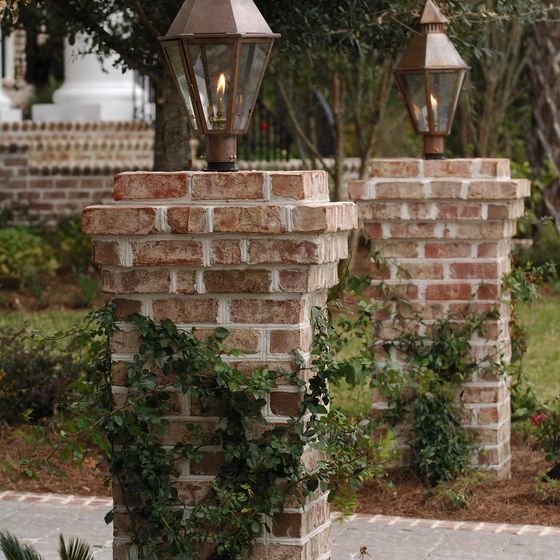

How difficult is it to build 2 pillars at drive entrance?
I understand foundations has to be dug and these have to be level as drive is on a slope.
Any advice would be great.
What I did.... (as DIYer so pleas correct me).
Note that I have no gates, so no lateral forces.
Dug dole for foundations 50cm deep (for my area), and 5cm wider (on each side) and filled with concreate, so concrete level 5cm below soil level, with two two rebars sticking out of concrete into air (two were used as was one re-bar cut in half).
Mine was two bricks by two bricks on each side. So needed 6 bricks per layer.
Left interior empty.
Built up bricks with mortar, so there was a hole in the middle of pillar containing the re-bar.
Let mortar set.
Filled middle of pillar with concrete (in two goes so that concrete pressure did not push out bricks.
Put on a capping stone on top.
No-one has been able to push this over, incluidng when car slowly hit it.

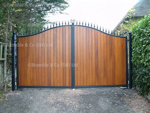

Do you have any pictures?
I am looking something like attached and hope to put similar gates on them.

hi
have worked it out going to build approx. 5 ft high pillars 25 inch width x 33 inch depth so I have worked out I need 252 brick per pillar, this be correct?
I am going to put block down for founds and build pillars on this.
how much sand and cement would I need for this as in bags of cement and can get some sand delivered?
any advice would be appreciated.
Brickwork pillars alone are unlikely to be strong enough.
We concrete steel posts into the ground then brick around them. The posts have elongated welded hooks on them to deal with the brick surround. The whole lot is set up (gates and all) prior to concreting.
I am intending to install a sliding gate so the gate pillars will sit behind the brick pillars, only thing on the brick pillars will be wired lanterns as I will have a stand alone post box
was planning on installing 4 re bars at corners of each pillar as well
