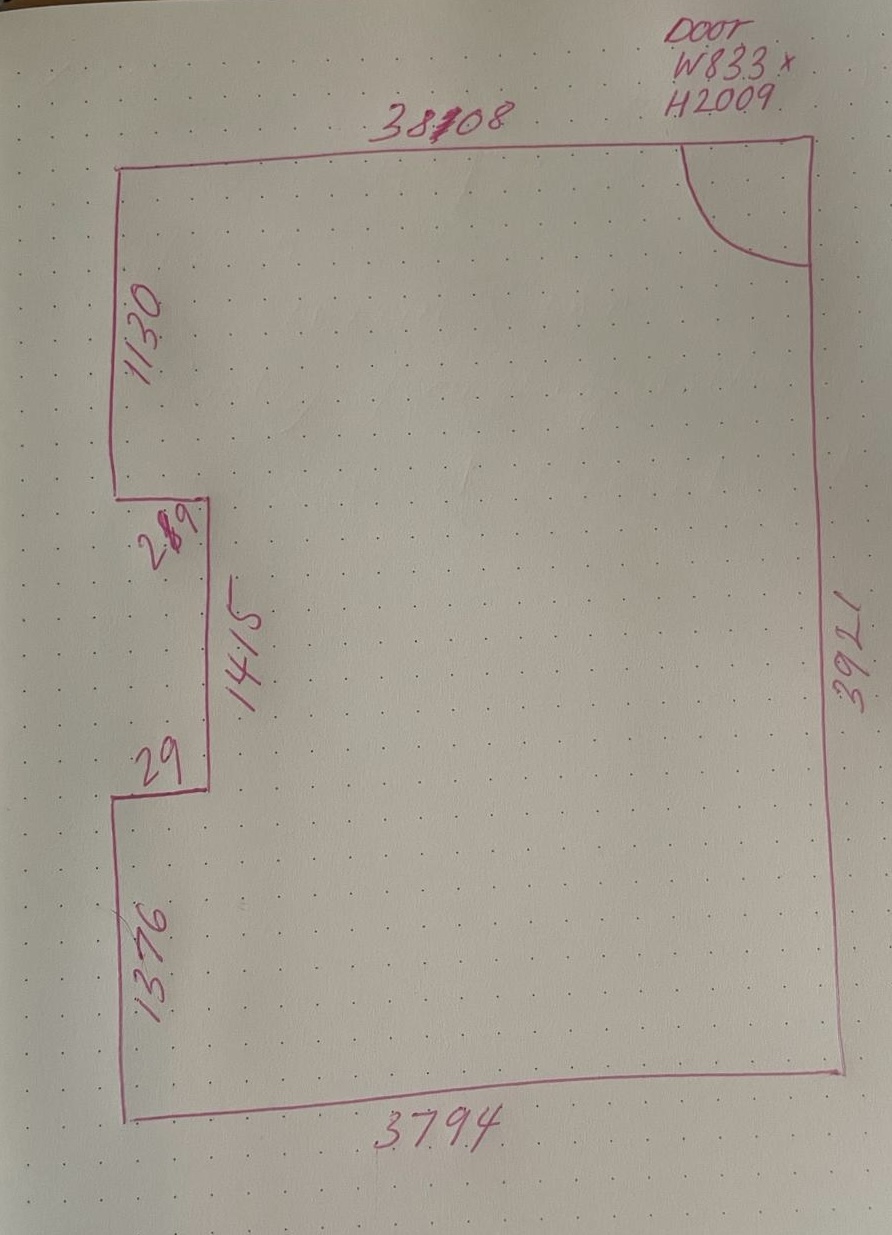

Hi Guys,
I hope you are well.
My current ceiling is concrete and I would like to drop my ceiling to so that I can add spot lights. I will be adding 2x4 around the perimeter and then add 2x4 joists 40cm a part. My only concern is that I my room size is 380.8cm x 392cm. I live on the top floor so I do not think I can get a 4.5m 2x4 pieces of wood up here.
Could i get a 3m 2x4 pieces and then cut a smaller piece to make the difference?
If so, how will I join the 2 piece of 2x4 to make the distance of the room?
Will this create sag?
Also what is the best and safest direction to run the studs.
I will only be putting plasterboards that weigh 28kg per board and 9 spot lights.
I have attached the room layout for reference.
Thank you in advance! :)

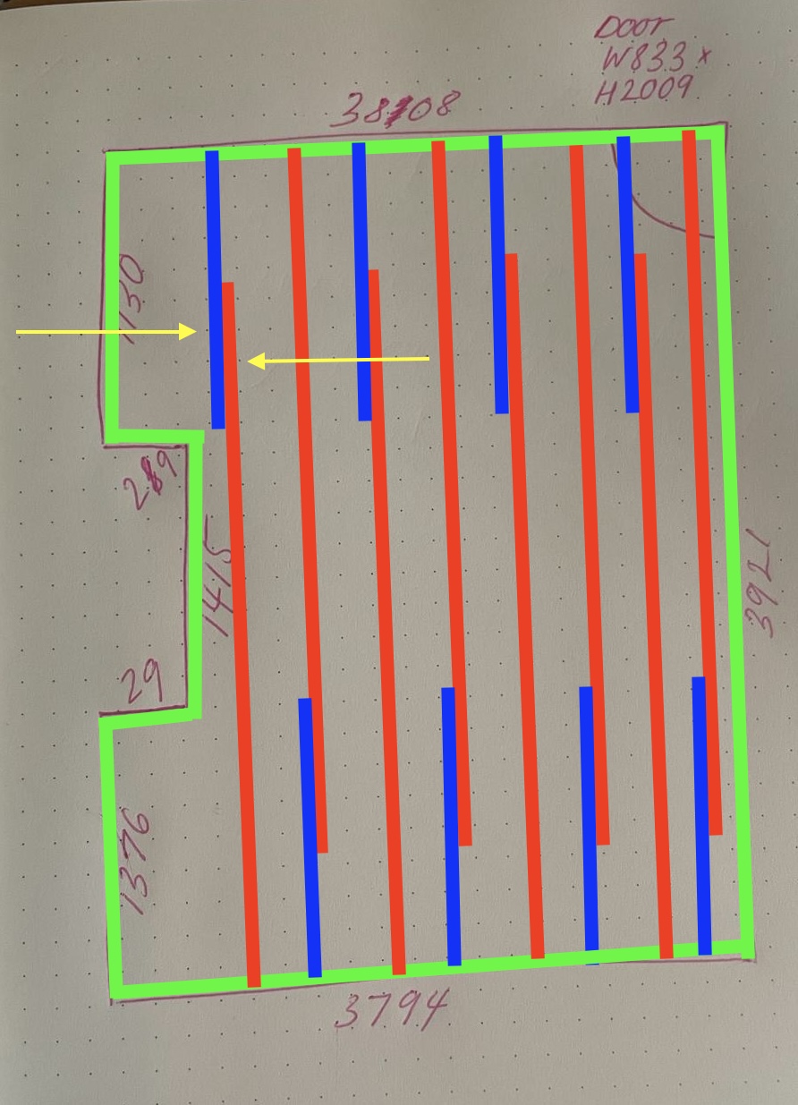

yes you could do that, you would need to screw another piece alongside the joists, say a piece 1.2 long so you have 0.6 either side of the join
I would use timber lok screws to pull them together
you need a driver bit for them as well
join them before putting them up so you can screw at 90 degrees, put a pair of screws at each fixing point, but not directly one above the other -stagger them by say 75mm. maybe total of 8 screws per joining piece
oh an I would do the joins alternate ends as well
you could use joists hangers, if so Id suggest fitting them before putting up your wall plates

Thank you so much for your help.
This is what I got from your message:
The green lines are 2x4 pieces of wood
The red lines are the 3m 2x4
the blue lines are the 1.2m pieces.
Yellow arrows: showing 8 screws staggered on each side

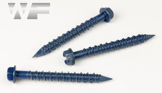

Does anyone live above you?
You could just fix the timber straight to the concrete using angle brackets and this type of screw.
You could also use 2*1 timber battens for ease of handling, counter batten with the same, and you could use low profile downlights to save on lost headroom.

Yup, pretty much like that
A metal suspended ceiling is a good option too, if you can screw into the ceiling
