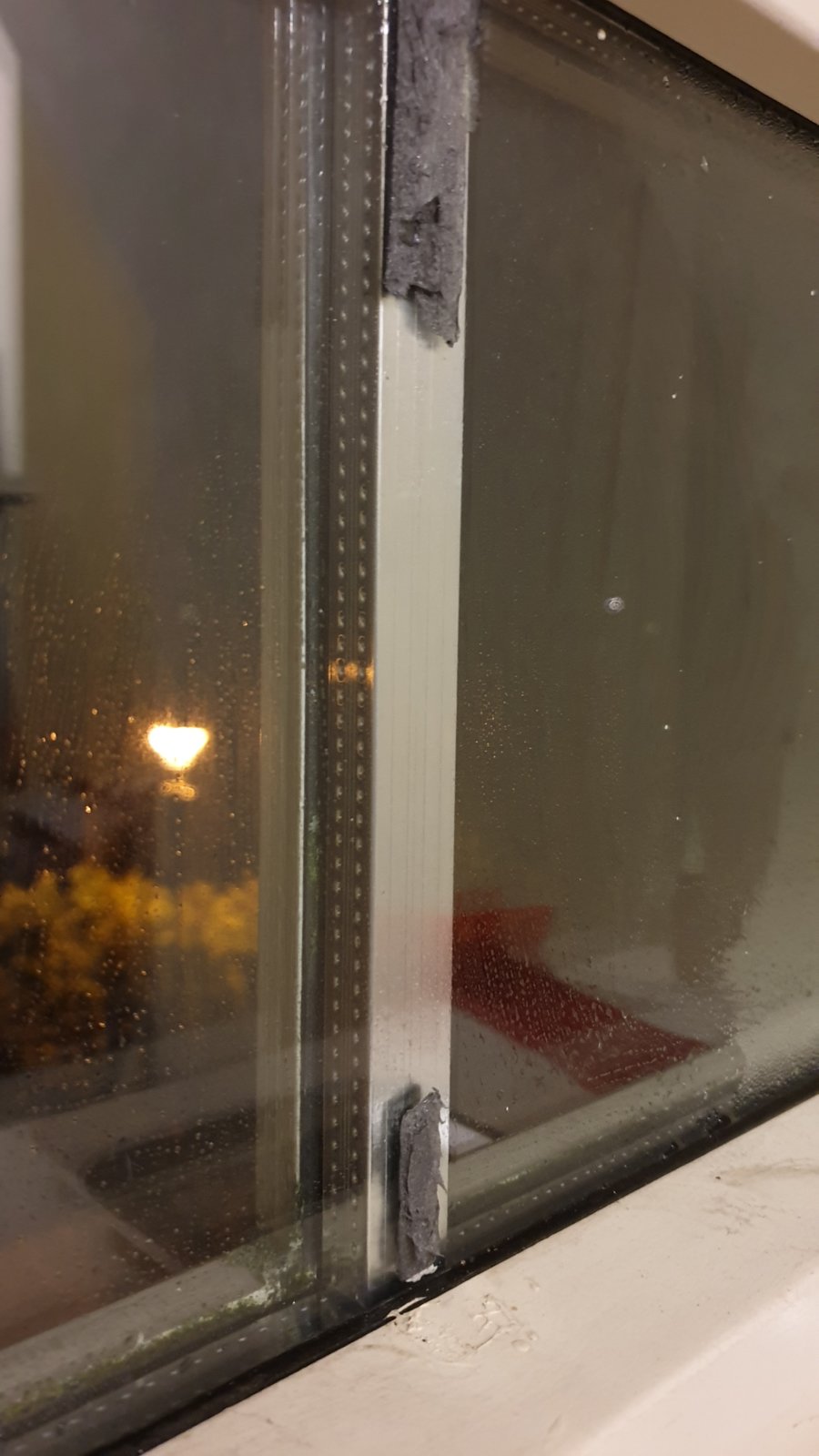

I've attached a photo of the type of glazing bars which were in the older glass which were replaced (approx 10yrs old), due to issues with the original installation. Does this provide any indication of what the older type of bars which were used?
The new bars are definitely duplex, which when the astragal bars are removed, you can see the two invidiual bars running parallel with each other to the centre piece.

Well the old one is one solid piece so I can see why it doesn't rattle. The newer ones will be two separate bars, back to back, I find it hard to believe that the way they are glazed would cause the problem. Honestly I am at a loss as to why yours are rattling'

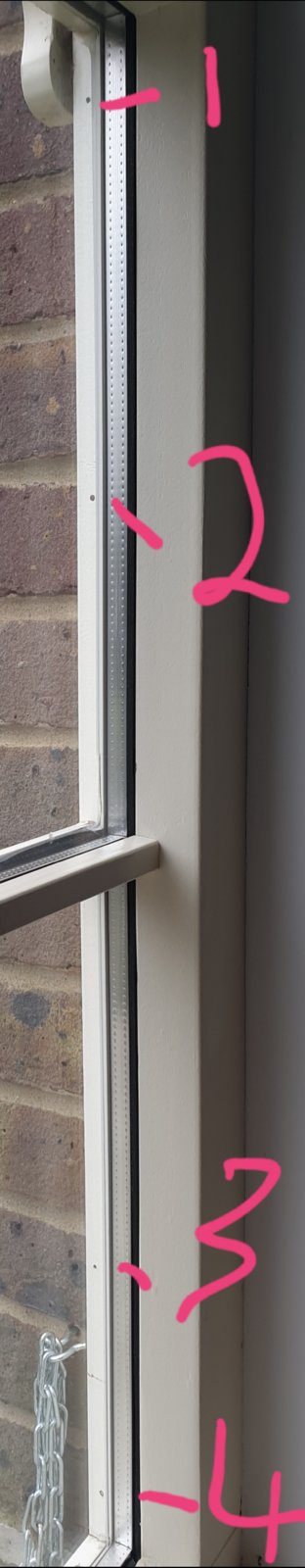

Would the number of nails along the external slips of the windows make the glazing anymore stable and less prone to vibration?
I have two windows of the same size in two different rooms, one with four nails down the vertical slips holding the glazing in place (attached), which does not rattle as much as the one with only two nails (top and bottom).
In theory it should make no difference to the glass unit as the sealant will hold the pane of glass to the spacer bar. I would get more nails ( sheradised pins ) on though, as unless that is a very short bead then that would not be enough to glaze with. As a rough guide, I'd say a 600mm bead should have 4 pins...stops the bead from contracting and expanding too much. It does make me wonder whether maybe its the actual bead making the noise, would all depend on how it's glazed
