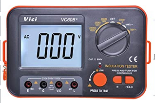

I have in a hurry used a multi-meter to try and find faults, and some times it has worked, but a meter like this
costs £32 yes not as good as a mega, as no low ohm scale, but it should find the fault, I bought one when I mislaid my mega, and when I found mega the results matched.
You know you have an earth fault, and it has not been found with trial and error hunting, so now either you buy a meter, or you employ some one who has one.

Thanks Eric I will get one of those.

Before the meter came I did another check with multimeter in the loft and was getting approx 1.3. I split the circuit in the loft into upstairs downstairs and isolated fault to upstairs which had nearly all wiring for in the loft.
Went round all connections and wiring and lo and behold the fault cleared. So not very positive as it could be in a hager downlight terminal box which was installed when we had the bathroom re designed and the sparky who did it reconfigured everything in the loft and the box is jammed out with cables. Leaving it for now but at least I have an idea where to look next time ( hopefully never ) and I have got myself an insulation tester.
