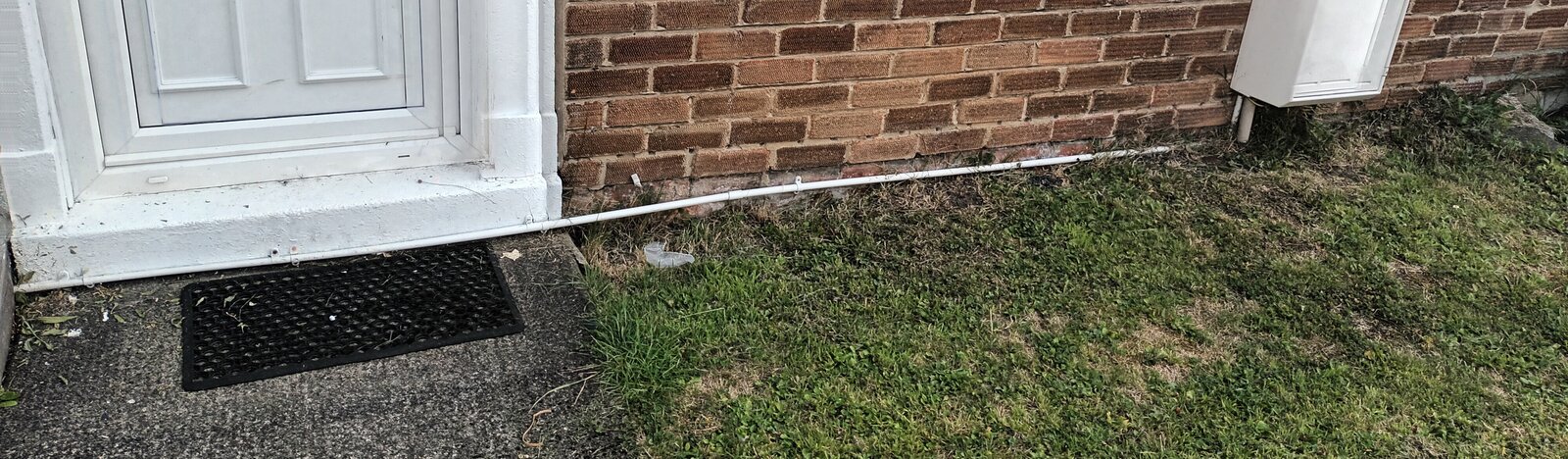

Hello
I am wondering if this is safe
My gas box is connected to my electric box via the earth grounding cable which is above ground in a plastic tube. Please see picture below. Should this be under the ground? No other houses on my street have this. Thanks

The part that you have shown in the picture looks safe. The plastic tube gives the cable mechanical protection which will help to prevent it from being damaged when you cut the grass.
There is not requirement for it to be buried, and it looks OK to me.
There's nothing wrong with the cable, per se.
However, as for regs regarding main bonding, I suppose it's possible that 'outdoors' may be the "nearest practicable point" to where the pipe enters the property, but I rather doubt that would usually be the case.

The gas bond is frequently made in the meter box, especially on new builds and of course esential if there is a T-piece within the box and 2 pipes emanating from there.
It certainly doesn't need to be buried but I have to say I think it looks vulnerable and terrible, it appears it's already had to be repaired under the threshold.

It does look cack, somebody hasn't got a bending spring.
Can see why the op has mentioned burying it, anything would look better than that rubbish.

Yes it looks ridiculous, it Is a 1950s property that was previously owned by a landlord (ha ha) . How do you suggest I get it buried or repaired so that it isn't an eye sore? You can actually see the earth cable peeping out under the box as well.
There are two initial choices. Run it outside or inside. I suspect it was done externally so as to avoid damaging the decoration inside.
So that leaves burial, assuming there are no gas, water or waste pipes or electrical cables in the way.
