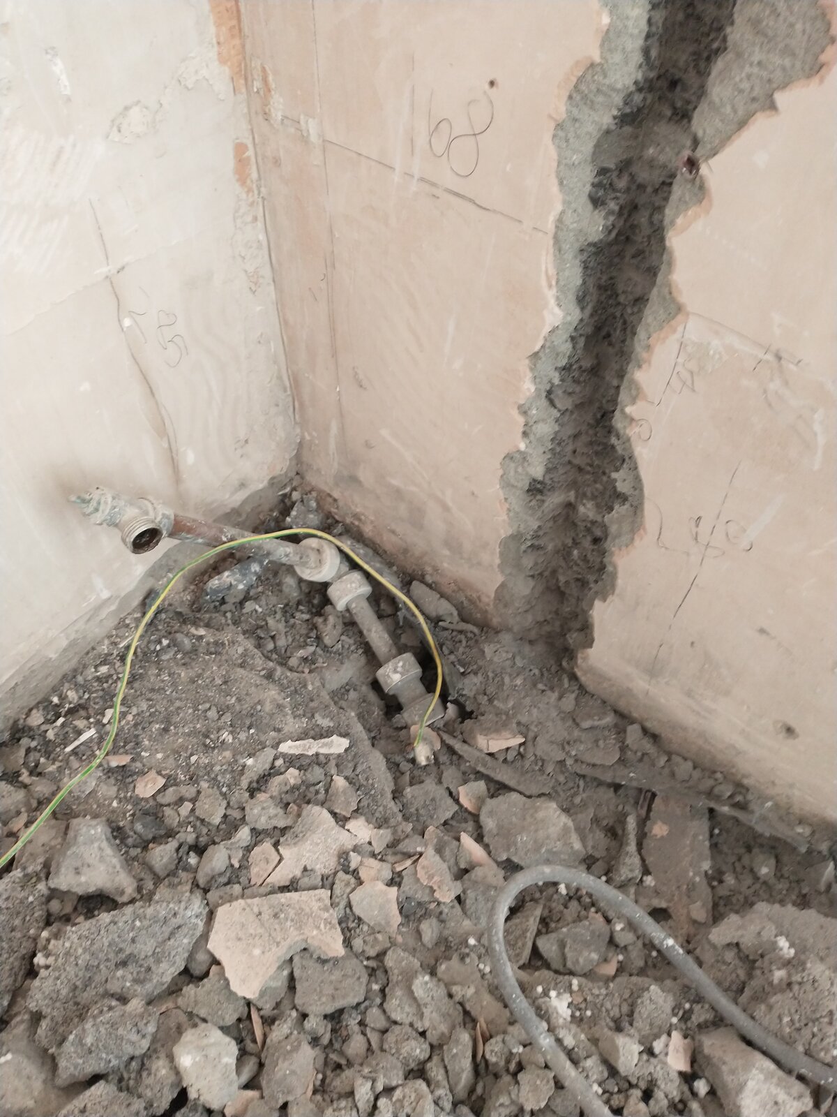

I pulled out an old radiator in ensuite and replacing it with a towel rad. There was an earth wire connected to the old rad. I've opened up the floor to expose the pipework. It's done in Plastic under the screeded floor and coming up in copper.
I was going to come up the wall in copper again and connect to the plastic piping under the floor . Will this need earthing with the already installed earth cable. Just as I write this, I've been in many a new bathroom refits and can't remember seeing and earth wires attached to the towel rad. Maybe they are earthed inside the wall which has crossed my mind. Is this essential.
As you say the radiator might be earthed because of its heating element (unless Class II).
On a general note, normally radiators themselves do not need "bonding" - i.e. connecting to other metal parts to ensure they are at the same potential in the event of a fault - but the pipework might if it is in substantial contact with the ground. Obviously plastic pipe does not require this as it does not conduct electricity.
Personally I'd suggest maintaining the plastic as far as the rad/rail to do away withthe earth doubt, unless of course you want chrome or polished copper.

It's more a question of equipotential bonding than earthing.

2008 the regulations changed, two things, the bird on the power cables does not get a shock, as no ground, same idea with shaver socket, so bonding everything is not always best practice, and second is plastic pipes break the bonding, does not even need to be a pipe, a connector is enough.
So as long as a 30 mA at 40 mS RCD is fitted, bonding can be omitted, however this means all circuits in the bathroom, including the lights.
