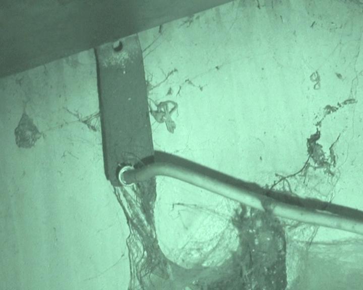

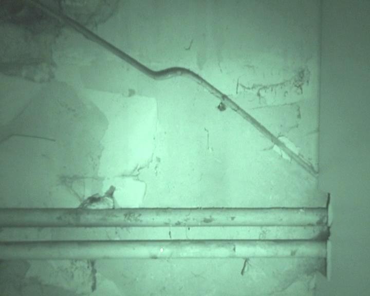

Appreciate your replies guys but it's not what I expected lol. Thought you were both going to say something like, no problem, just snip it and leave it as the laws for grounding sinks are no longer in effect :LOL:. However, to clarify, I'm fitting a ceramic sink and also, I have attached 2 pictures of the cable here:
One end of the cable connected to the stainless steel sink >>>
And the other end of the cable running behind the back of my new kitchen cupboard, seem to recall connected to some sort of mesh box or something, I can't remember exactly (but now, no access whatsoever without ripping out all my work)>>
But the problem is, I'm very weary where electrics are concerned. If I snip the cable, it won't leave the sink live or something will it? Or should i turn off the mains supply just to be on the safe side? If I do snip it, is it crucial for me to sort of connect it to the cold pipe below?

IF you already have equipotential bonding in place elsewhere to the incoming cold water main, then you needn't worry about this extra cable and can happily snip it.
Well, I presume so, but everything is hidden and not accessible. The plumber is coming to replace the main stop cock soon so I'll ask him also to check if there is bonding elsewhere. Thanks for your reply.
There should be a 10mm² earth conductor attached to the cold water main near the stopcock. If there is not, get one fitted.
They are right, but if you don't know what the position is, and don't want to take out the units to look, or to go to the trouble of fitting a good main bond, I really think the best thing you can do is to attach the wire to the the metal cold water pipe under the sink. This has a fair chance of doing some good, but snipping it off won't.

Thanks JohnD, will do this. What I'll do is I'll snip it round about where it connects to the sink, and take the end and bond it to the cold water pipe below. You're right, no point in leaving it dangling. Will look out for a cable clamp. Thanks again for all your help.
