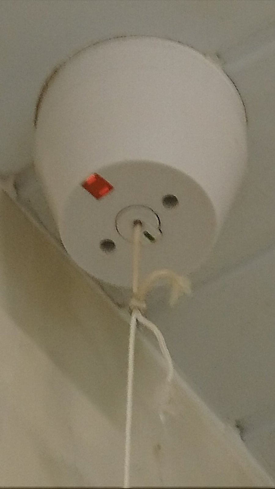

Our shower pull cord won't pull this morning. It was stuck in the off position but it has a tiny green button on it and if I press that the power switches on. If I pull the chord to turn it back off it doesn't go back on again.
Why does the green button turn it back on? Why does it keep sticking? Will I have to change the chord unit?

They're not really designed for general switching, but merely isolation during servicing. The green button sounds unusual though - do you have a picture?
I don't know how to post pictures on here - my daughter did it for me last time I posted some and she's not here til the end of the week o_O
The green button is what looks like a little black line inside the ring where the pull cord comes out.
It's pushed in now and flush with the surface. If I pull the cord it pops back out and the switch won't pull again until the button is pushed again.
It's not a button, it's a mechanical indicator flag to show when the isolator is in the on, or off position.
In the event of a power failure and the light isn't working it will show which position the isolator is in, so it can be left in the safe (off) position.
From what you describe, it would appear that the switch internals are worn causing the mechanism to stick and it should be replaced.

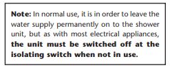

Most electric shower manufacturers will have a statement in their instructions about its use. Triton for example:
And when it is replaced please make sure the little plastic insulator is in place. It is a safety device.
So why does the switch work when I push the indicator back in?
Replace it with a Crabtree 50A pull switch, that's what you appear to have.
Most other makes are a different shape, which would make replacement more difficult.
You notice the switch and wire ends are burnt - if they are you will have to re-strip the cables back to nice clean copper and sound insulation.
Yet another example of manufacturers instructions being wrong. Not only does it NOT need isolating when not in use, there is no requirement for the isolating switch at all.
What makes you think there is no need for the isolation when the manufacturer thinks there is?

My Mira Sport instruction booklet says that the isolator is required by the regs. and the electrician who fitted it was equally adamant that it is a legal requirement.
