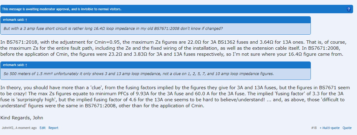

In BS7671:2018, with the adjustment for Cmin=0.95, the maximum Zs figures are 22.0Ω for 3A BS1362 fuses and 3.64Ω for 13A ones. That is, of course, the maximum Zs for the entire fault path, including the Ze and the fixed wiring of the installation, as well as the extension cable itself. In BS7671:2008, before the application of Cmin, the figures were 23.2Ω and 3.83Ω for 3A and 13A fuses respectively, so I'm not sure where your 16.4Ω figure came from.
So 500 meters of 1.5 mm² unfortunately it only shows 3 and 13 amp loop impedance, not a clue on 1, 2, 5, 7, and 10 amp loop impedance figures.
In theory, you should have more than a 'clue', from the fusing factors implied by the figures they give for 3A and 13A fuses, but the figures in BS7671 seem to be crazy! The max Zs figures equate to minimum PFCs of 9.93A for the 3A fuse and 60.0 A for the 3A fuse. The implied 'fusing factor' of 3.3 for the 3A fuse is 'surprisingly high', but the implied fusing factor of 4.6 for the 13A one seems to be hard to believe/understand! ... and, as above, those 'difficult to understand' figures were the same in BS7671:2008, other than for the application of Cmin.

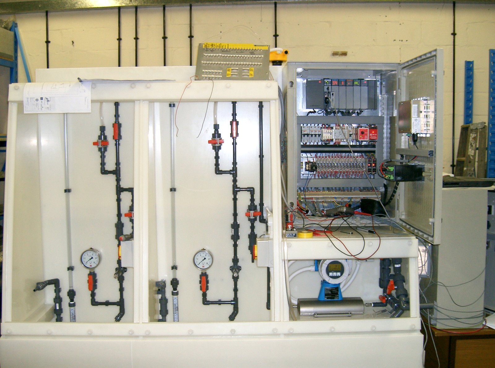

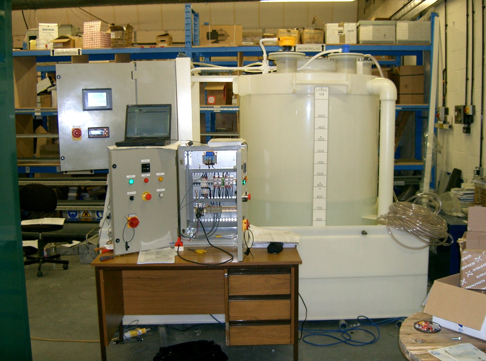

I did some subbing for a controls company who specialised in water treatment, we had a green 'cabin' in the workshop, this sort of thing:
Their own electrician, as opposed to controls wireman, had wired in a 5KVA 110V isolating transformer feeding 4 16A yellow sockets each with their own 16A MCB in a seperate ('110V') CU. It was powered by a C20 MCB in the 230V CU.
I instantly spotted he'd used SP MCB's for the 110v and queeried it with him. I was told to mind my own ******* business and go back to my 'little toy wires'. Bearing in mind I was only temping there and hoping to continue I dropped it until the following day when the the Contracts Manager came to the workshop and pointed it out to him. He advised it was normal and done by the qualified electrician so it must be OK. After that I spoke to MD who asked what the problem is, but he didn't understand.
I got a long (20m sort of length) piece of 1.5mm singles from the scrap bin and poked it in the 'E' & '-' holes of a yellow socket and waited. The MD switched it off when things started smoking and called the Contracts Manager for a demo. Then they called the electrician and asked him to come in, He wasn't happy as it was Friday and already finished for the day.
We all sat in meeting room to discuss the installation where electrician again insisted it was OK and a number of sketches were made. We then went to the W/S to demonstrate the problem and he was instructed to put it right which included rewiring and replacing heat damaged plastic trunking.
Following week they started a program to go round the previous installations to change to DP MCB's. My name was **** amongst the site staff but managers seemed to be OK with it.

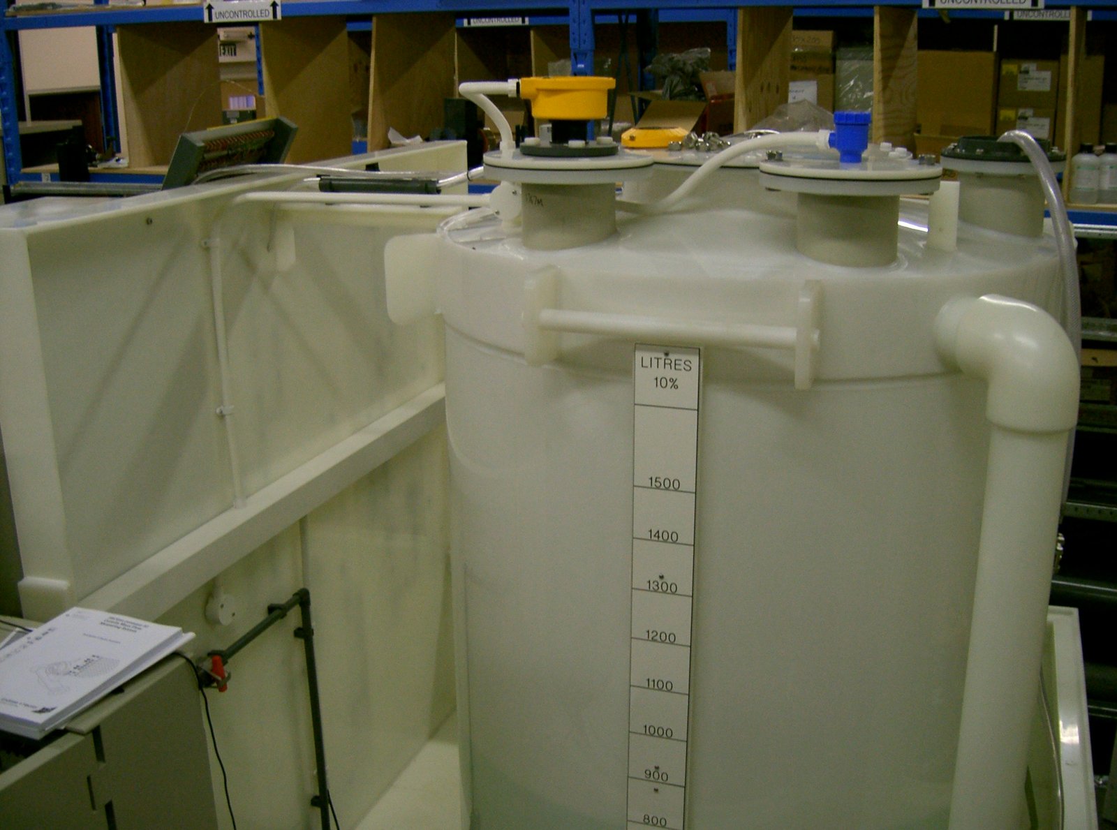

It meant I had a fair bit of work there while they completed that. And I learnt a lot about water treatment plant includung equiping a 1500 edit LITRE acid storage tank in its bund with all of the dosing kit, plastic welded pipe etc on top of the controls panel and wiring that I was expecting to do and the pump skids that went with it... Oh and I did the electrical bits too which didn't go down well with the electrician who thought he had the company sewn up.
