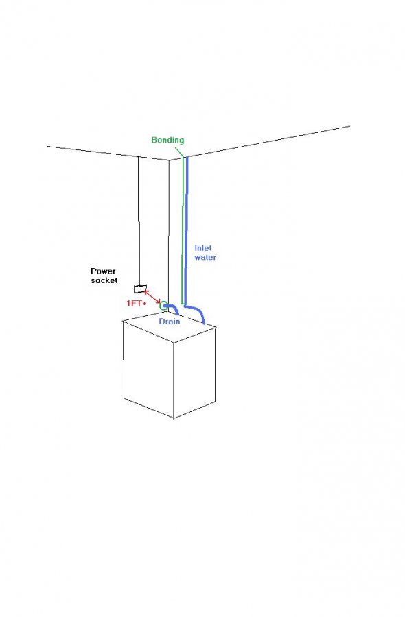

Hi,
I have to do some work before a builder, plasterer and electrician start.
1/ From the image, is it within the electrical regulations to have a power socket appr 1Ft from the water inlet for the washing machine?
2/ I presume the water inlet needs bonding. What size bonding cable is needed?
3/ What size bonding is needed for a 9.5Kw shower? (Inside shower quadrant)
Cheers, Camerart.
1 it's fine
2 no it's not needed
3 if you have RCD protection <30mA on all circuits passing the bathroom then you don't need bonding. Otherwise it's min 4mm, possibly 6mm.

Hi J,
1 Good
2 Good
3 There is a 30mA RCD upstairs also a similar main one.
Thanks, C.
3 so any circuits at all not RCD protected in the house? If so then fine.
OK no need for bonding in the bathroom then. Just make sure the main bonding is present where necessary eg incoming water and gas supply if metallic

As you are aware, there are a couple of other requirements for omission of supplementary bonding. Firstly, not only does main bonding have to be present (if necessary) but any extraneous-c-pc in the bathroom must be 'effectively connected' to that bonding (per test criteria specified in regs) and, secondly, that all final circuits in the bathroom satisfy the Ze requirements for ADS (which they always should do, anyway).
Those two additional requirements will nearly always be satisfied, but I suppose one should not pretend they don't exist. The problem with the first I mentioned is that it theoretically requires a measurement that a good few DIYers would probably not be able to undertake.

Hi J,
On the old basin there is bonding, 3-4 mm outside plastic. I presume it goes to the bath as well. Does this need to go to the shower pipes?
I don't know what (shown in red) mean: "Firstly, not only does main bonding have to be present (if necessary) but any extraneous-c-pc in the bathroom must be 'effectively connected' to that bonding (per test criteria specified in regs) and, secondly, that all final circuits in the bathroom satisfy the Ze requirements for ADS (which they always should do, anyway)."

Hi J, On the old basin there is bonding, 3-4 mm outside plastic. I presume it goes to the bath as well. Does this need to go to the shower pipes?
If the requirements for omission of supplementary bonding are
satisfied, then nothing needs bonding.
In this context, an "extraneous-conductive-part" is essentially any metal pipe etc. which enters the bathroom from somewhere else. The second bit relates to the wiring etc. having a low enough impedance for the MCB (or fuse) protecting teh circuit to disconnect the electricity within the required time (e.g. 0.4 seconds) in the case of a fault. That can only be ascertained by an electrician with appropriate test equipment, but is a requirement regardless of any considerations of bonding, and will almost certainly be satisfied (unless something is wrong with your wiring).

Hi J,
Yes, that helps.
I had an electrician fit a new fusebox, plus sockets around the house, including the new shower switch, and he must have tested it.
Thanks, C.
Yes, if he replaced the 'fusebox', he should have tested all the circuits. In fact, he should have given you documentation which included all of the test results.

Hi J,
BS7671 0.4 Olay!
C
Hi J, BS7671 0.4 Olay!
It sounds as if that is the BS7671 requirement for the disconnection time, rather than a measurement on the actual circuit. Is there a column of numbers headed "Zs"? Could you perhaps post a scan or photo of the 'Schedule of test results" (with any identifying information obscured)?
