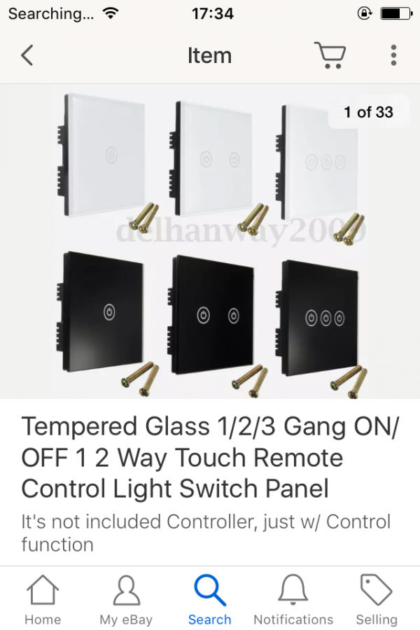

Very helpful folks thanks. I'm planning on getting 6 spotlights in the ceiling. In terms of the switch I'm getting one of these switches. Silly question but would I need more than one if I ha 6 lights.
