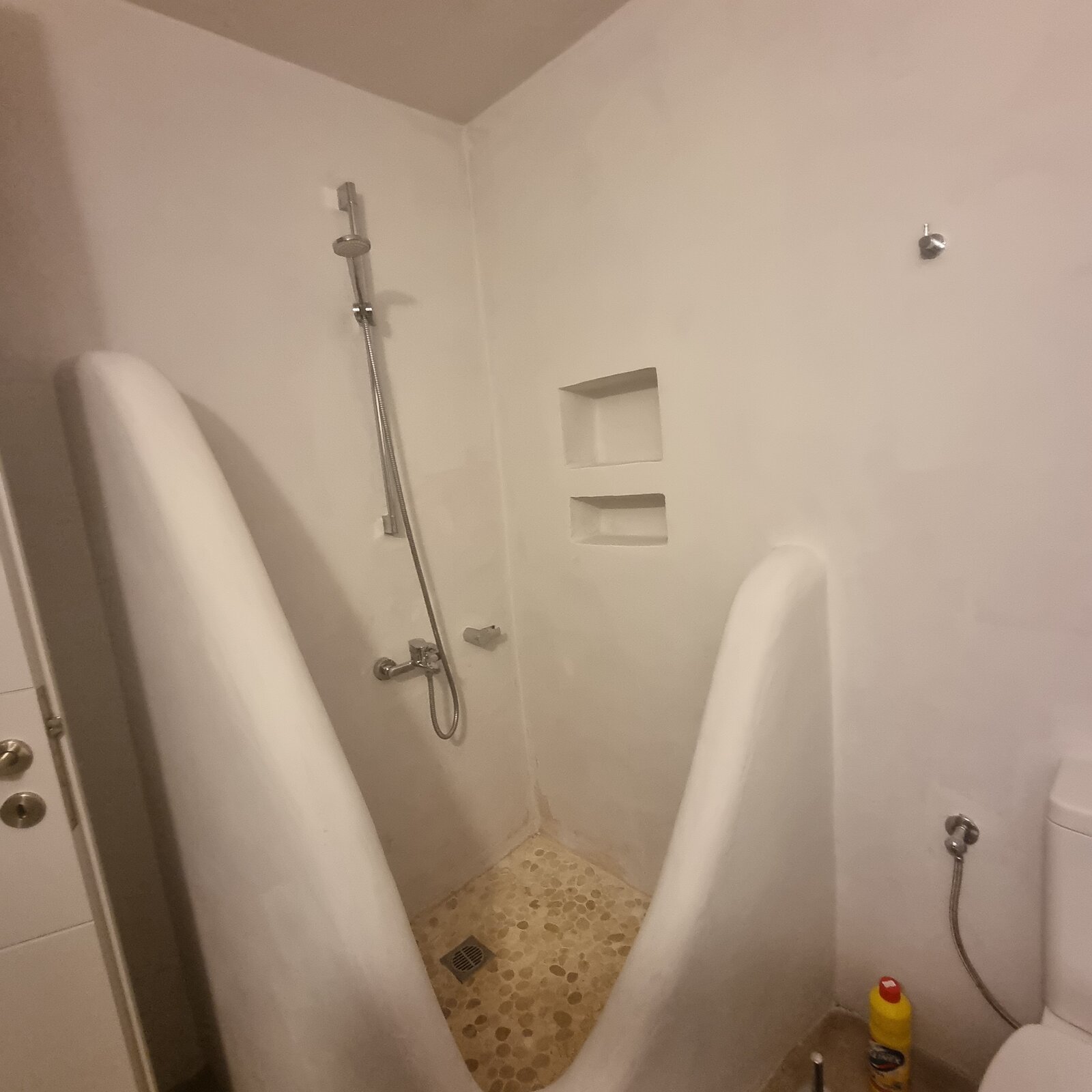

I'm sorry if this is a really silly thing to ask but painting over a horrible paint job in a new property we purchased in Greece.

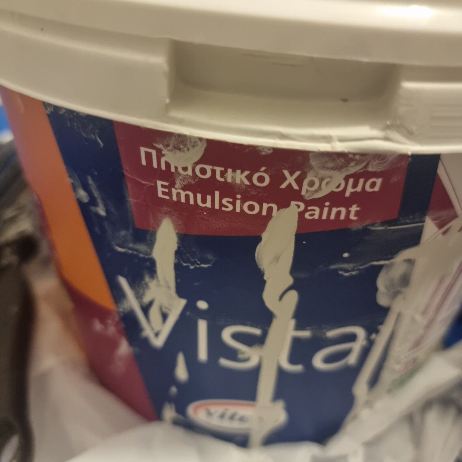

I've been given an emultion which I had to add 10 percent water too, here's a photo..
Is this all going to wash off the second i use the shower?
Any advice welcome thank you very much

I don't think it'll wash off immediately but I think constant exposure to that level of moisture will make it go ratty quickly; seek out a paint intended to cope with regular drenching, like a masonry paint
Side note, probably best not to use an email address as a visible user name on forums
Quite typical for the med, I'd say, to have internal walls that are rendered like we render external ones..
