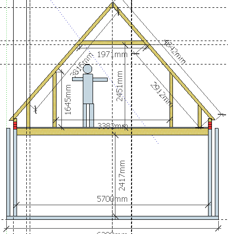

I'm starting to plan out the building regs on my new extension. I have two rooms that have 5250mm clear spans, and I'm already struggling for head height so don't want an excessive floor (joist) depth.
I'm almost outside of the standard span tables, but might just scrape a 72x220 at 400cc (which are good for 5362mm if less than .50 kN/m2) That would be 32 joists in total : £500.
Initially I thought I'd put a steel half way across the span with a timber bolted in to the webs to get the floor depth below 170mm, but then I thought I'd get a quote from one of the leading engineered joist suppliers to save myself all the bolting/fixing/faffing time. I was expecting it to be a bit more, but fell off my chair at £2000.
Is that the going rate, or should I keep plugging away for quotes from elsewhere? My mistake might have been that I specified metal webs rather than the OSB webbed ones, on the basis that I could also run a soil pipe through if required. I could probably adjust the design to avoid that if it would make a big difference.

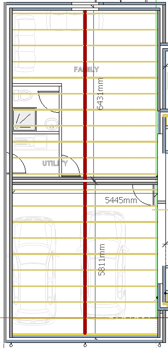

Having looked at costs again, the 75 x 220 beams would cost me more like £900 I think.
It's a 12 metre length spread over two rooms, so if I was to divide the span using a steel in each room it'd look like the following, needing 20 beams at 600cc or 32 at 400cc.

I'm not sure what's the on the side wall, but is it possible to run the steels across the room rather then down their lengths
Yes I could do - I didn't think there'd be much in it. Fewer joists to bolt in though I guess?

If you take the beam across the room, it may just work out smaller, and more stable, the joists will be less than 75mm wide, and the costs less than the OSB joists. Yes it'll take you longer, but I'd say it was the best compromise, and I think you'll forget the extra time, and be pleased that you achieved what you really want to.

:) It's this kind of thing I have going on above, and with the PIR insulation I'm going to need in the roof and below the rafters, the floor depth may make a big difference to me (in the garage if not the actual bedrooms)
Good point - we'll be in the house for a long time. Rotating the steels around may also give me less wastage out of a 4.8 or 6M timber. I note that at the moment to do the clear span of 5445mm in 225x75 I'm going to have to cut 600mm off the end of a lot of 6M timbers.
Taking the steel across the room should allow you to use 200x50, so to me, it's a no brainer. I don't know whether you could get down to 175x75 at 400 on a 3.2m span from the central steel beam. Have you got an SE to do the calculations, or are your just working this out yourself.
I'll have an SE doing it all in one go, but need to give him a brief/design to work to. I have a couple of ensuites above so need to give some thoughts to the joists with regard to running services too, before I get the SE input.
