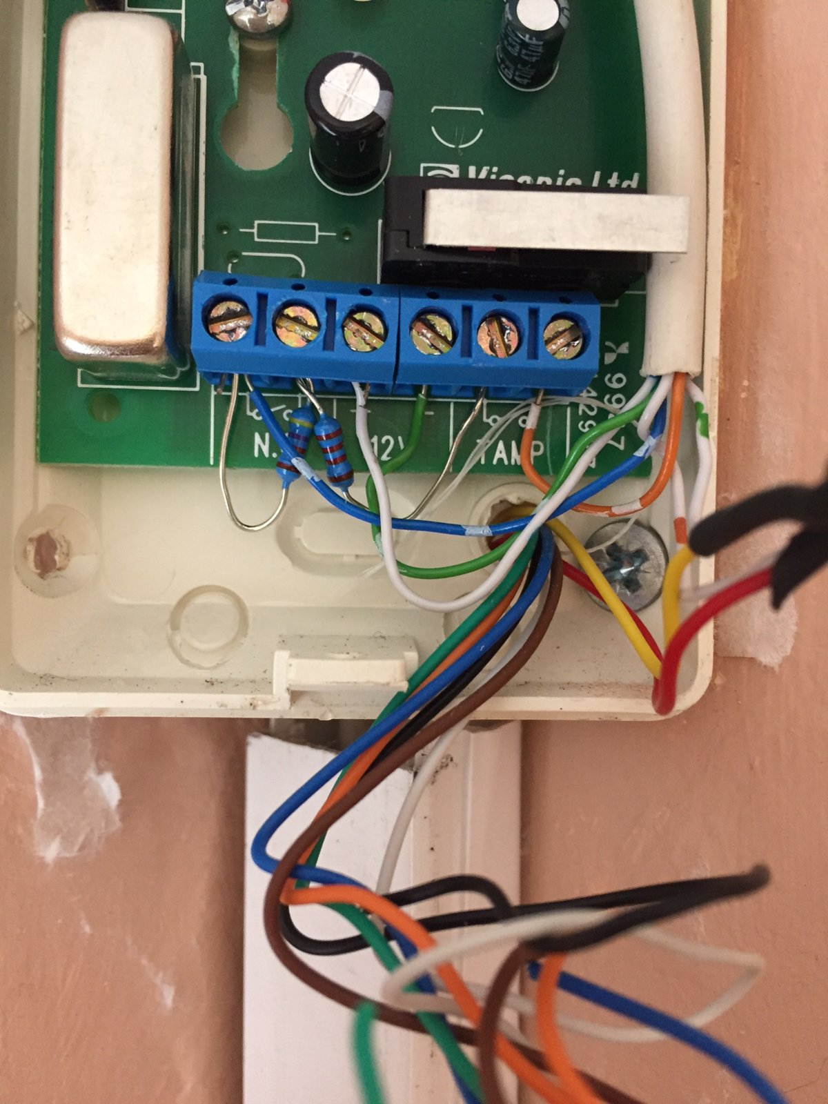

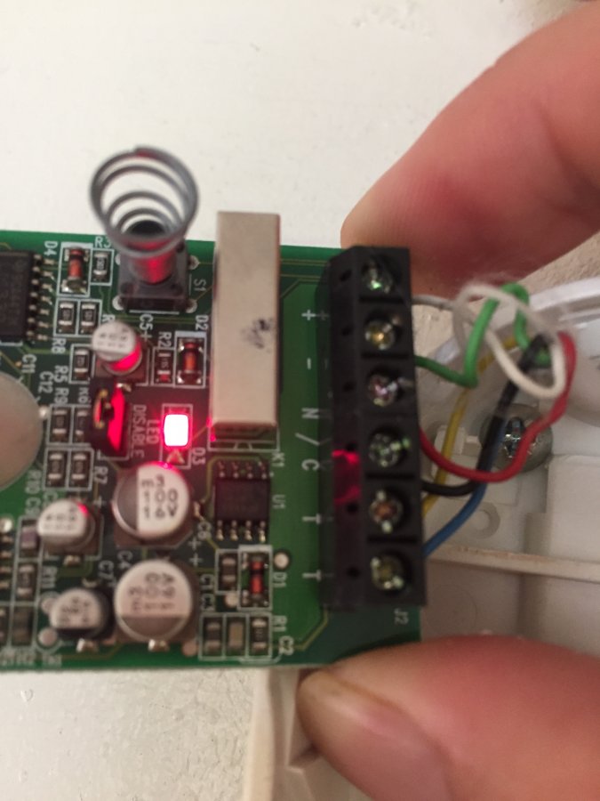

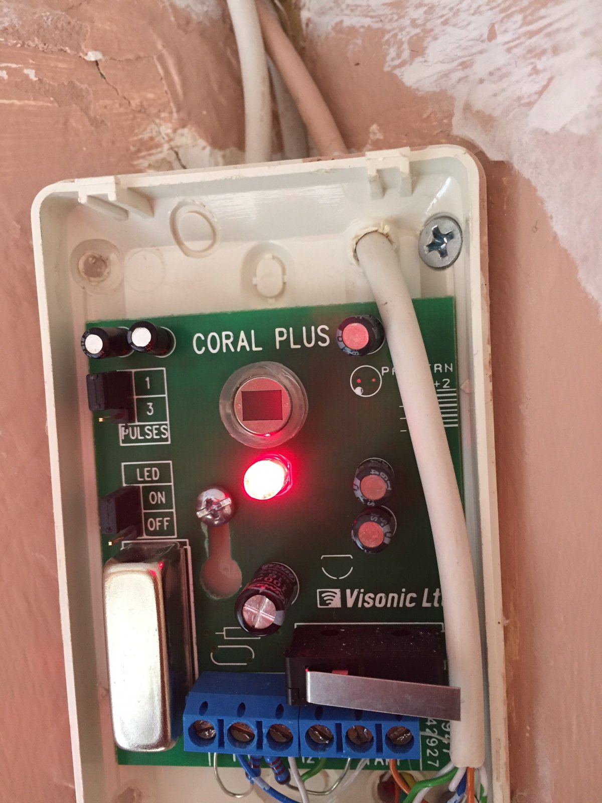

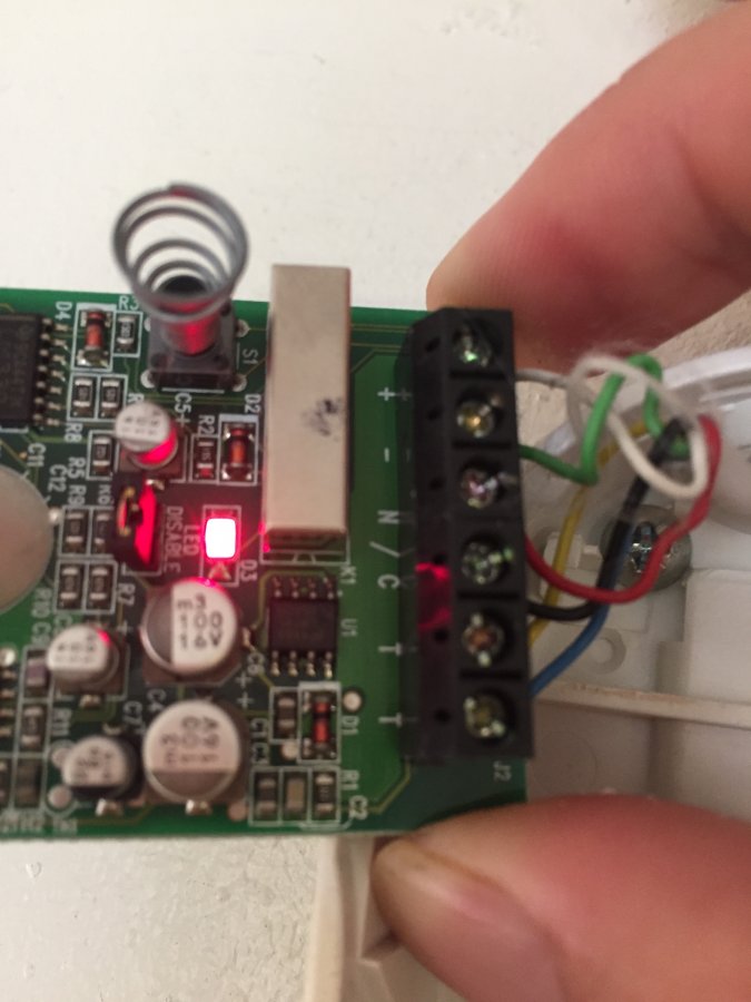

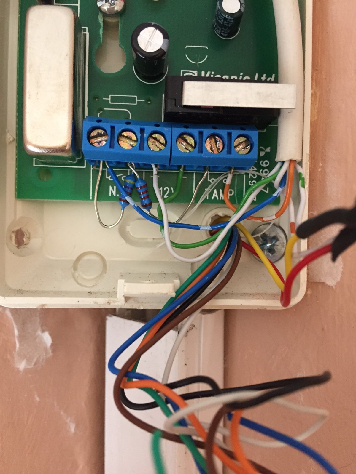

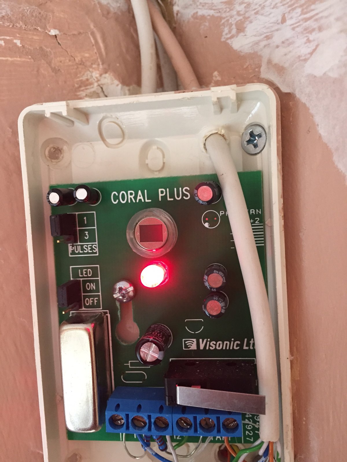

The PIR is a Visonic Coral Plus, i want to change to a Pyronix KX PIR like the rest of the house now is, when i have opened it, I have the wires from the Door Contact going into it (only 2 connected) and 2 resistors, now the new PIR has what looks like built in resistors so can i use the caps supplied instead of the actual resistors?
I have attached the pics.
If its too complicated then I'll just have to wait, but thanks in advance.

Thankyou, am i ok to split the 2 wires from the door contact and re wrap when i've changed the PIR? what is that stuff called as ill need to buy some
possibly that then...... didn't think that would be used on alarm wire
