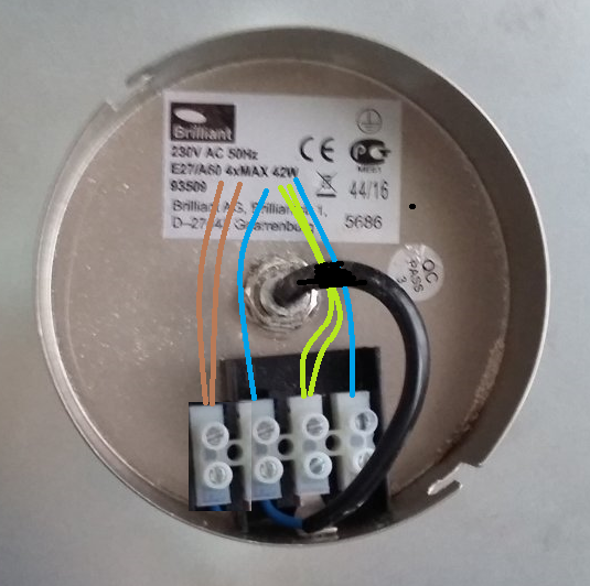

Ok fair enough. I was just trying to visualise how an extra connector goes into that layout. The black surround has side walls so there's no room for extra width unless the 3 way is moved somewhere else and a single connector placed there. Or if the black surround is adapted.
But ok, if it's not simple to add the extra connector without shifting things about too much, I'll get someone in.
NO NO NO. Do you still not get it? The middle terminal of the 3-way block is CONNECTED TO THE METALWORK OF THE LIGHTFITTING by the metal tab. This is what is providing the earth connection. You must leave it where it is.
Get an additional single terminal for the loop wires. There seems to be plenty of space for it.
Yes I do get that the metal tab needs to connect to the metal. What I'm really struggling to see is how I go from 3 connectors to 4.
If you're saying add a single connector and terminate the loop live into that, then it makes sense.
But then I'm gonna ask if wrapping it to the rest of the connectors with insulating tape is sufficient to secure it. Then someone will say that's crazy... So I'm going to leave it there.

As long as you keep the stripped parts of the wires inside the terminal block, and the terminal blocks within the metal bulge of the fitting, and the sheath is only stripped back within the fitting (and technically clipped to the joists above the ceiling) you needn't worry about extra protection for the terminals.
Buy this: http://www.toolstation.com/shop/p88321 for 38p.
Cut one of them off and use it to join the loop wires.
Put the other wires into the correct terminals provided with the light.
No tape, no moving of existing connectors, no adapting the light fitting, no adding earth terminals, nothing else at all.
It's not a 'European Light Fitting' either. It's exactly like the majority of light fittings you can buy today.
Or just re use the connecters from the light you took down, surely that had at least 3 connecters plus you said a seperate earth lug
Sometimes you can replace a terminal block of 3 with one of 4, but in this case, the plastic backplate seems to disallow this. Adding a separate block as described is perfectly fine as long as it is enclosed within the "rose".

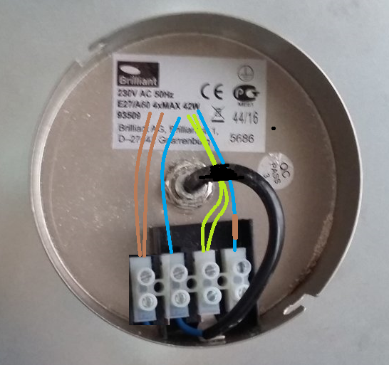

Just managed to squash it in:
