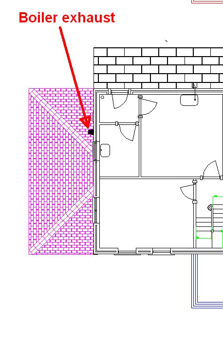

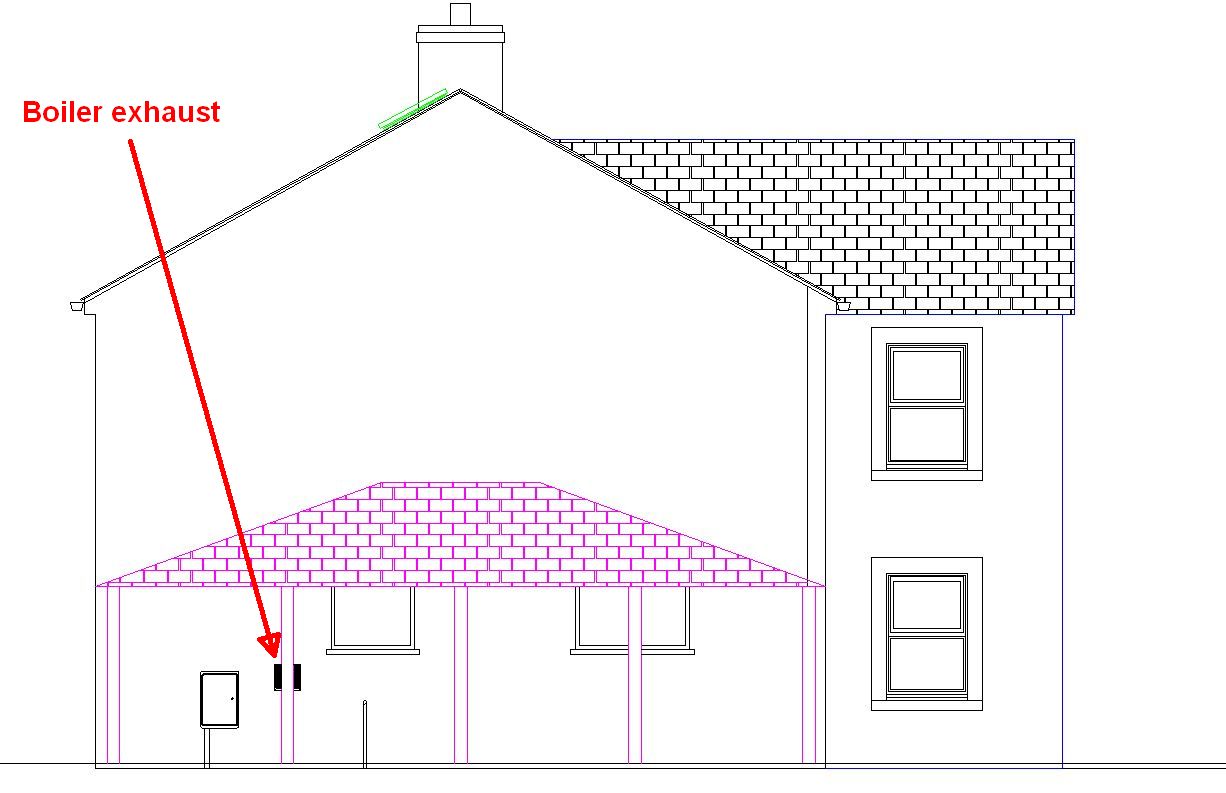

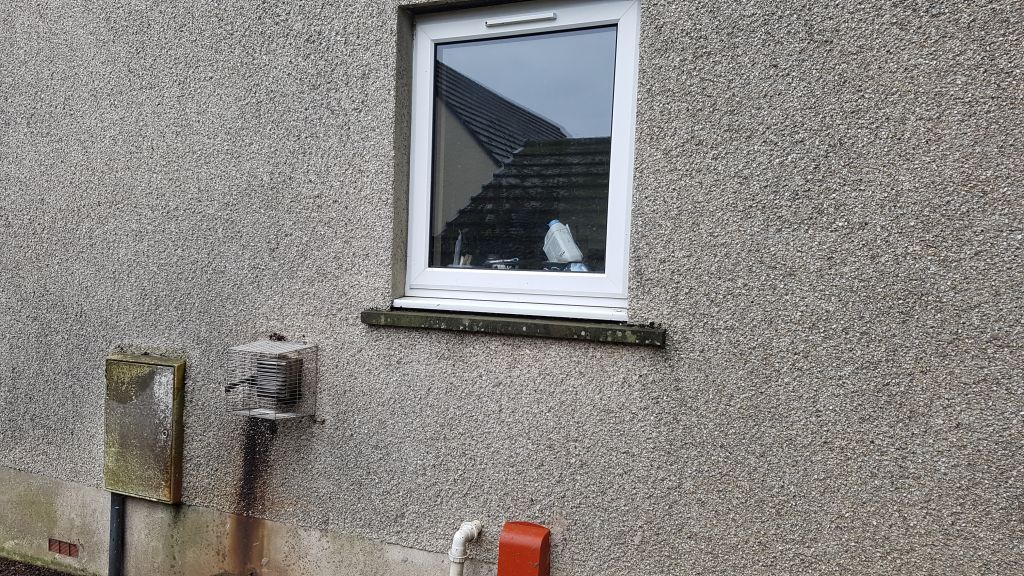

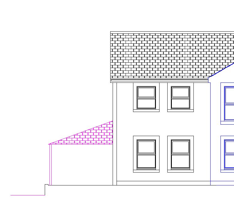

I'm wondering about putting a car port on the side of the house. It would be open on three sides. The only problem, is that it would cover and area above the existing boiler flue, which comes through the wall. The boiler is an oil-fired Worcester Heatslave and has (what I assume is) a balanced flue.
Is it possible to extend such a flue so that it goes up vertically through the carport roof, please?

Download the manufacturers instructions it will give guidance on flues in car port’s
Thanks. I found one online. It just says discharge into carports or narrow passageways is not recommended. It does give a load of flue options (vertical or low-level), but doesn't really say anything about extending an existing low-level flue vertically up the wall for a few metres. There's something about only using 15 degree bends, which makes me think a 90 degree bend added to what I've already got, would be a no-no?
That's ancient, no chance you'll get any flue for that any more
I feared that. 1995, the boiler was commissioned. Are these flues not relatively standard parts, then? It just looks like a double-skinned round bit of pipe?
As above its obsolete its well in overtime at 27 years old
If you want the carport new boiler time .
I wouldn't recommend any oil boiler that starts with a W
I think that might put the project on ice then. It's been a good boiler, to be honest. Still works, so I think I'll have to wait until it dies. No gas where we live, so I guess it would have to be another oil one. Are new ones significantly more efficient?
Yes current condensing oil boilers are more efficient than yours into the 90%s bit less for a combi,.
Could even consider moving the boiler totally and fitting a external model.
Manufacturers warranties extend to 10 years on some models.
No, modern boiler flues have a plastic exhaust duct, which would get a bit melty if connected to your boiler. The exhaust gases on your boiler are around 250°C. A modern condensing boiler has exhaust gases around 60°C as they recover more heat from the combustion process
Thanks, but surely there are enough older boilers out there, that need flue work?
Maybe so but as a manufacturer would you rather continue manufacturing a flue for a 30 year old boiler, or stop manufacturing it and thereby hope to sell a whole new boiler and flue kit in this situation? There are no such thing as generic flue systems in the UK, the regs say that only the boiler manufacturer's own flue system may be used.
Ah! That last bit is interesting. If that's set out in legislation, then it really does put the tin hat on it. We had a hard enough time a few years ago, trying to find an expansion vessel for it!
Both Hounsfield and Grant flue systems are stainless steel
One of several reasons we won't fit oil boilers beginning with a W !
Mine is stainless! (Well, the bit I can see from outside the house is). But I'm fairly certain the bit coming out of the back of the boiler is metal (I've a feeling it's black painted mild steel, but can't really remember).
