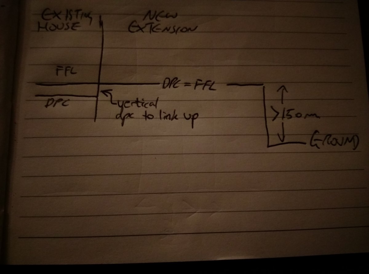

Pouring concrete for my extension footings soon and plan to pour 6 or 7 courses of bricks below dpc.
I can't have a screed as I'm keeping a very thick old layer of concrete so only got room for insulation and slab.
Existing house, dpc is about 2inch below finished floor level, but if I go with finished floor level at same height as dpc ( as per loads of great advice on this forum) it means extension dpc is a but higher than existing house, which I was hoping to just link vertically when doing the brickwork up to damp.
If there's any chance anyone fancies sanity checking the above, it would be much appreciated as always! (y)

Why dont you scan a rough sketch of a section view of whats existing & what you propose? Include the external ground level.
Thanks vinn see pic

Thanks for the sketch.
So the existing concrete slab surface is level with the house FFL?
This "old layer of concrete" will then have been bridging the house DPC - level means bridging.
Presumably the slab doesn't have an existing membrane (DPM) below the concrete?
And the plan is to dig out and build foundations around the footprint of the slab?
No, the old concrete is 200mm below existing floor level (and new floor level)
I should have included it on the sketch sorry.
It's where your hardcore would normally be.
Bco has ok'd dpm and insulation straight over it. Then new slab on top.
It sounds like your house has a timber floor, where it is common for the DPC to be lower than it.
And new dpc should be at the same level as the new floor, and lapped over the existing.

Thanks Woody
When you say dpc lapped over the existing do you mean run it up the wall and chop it in to the existing ? (only about an inch or 2 different between new dpc and old)
I would prefer a screed but I only have 200mm to spare above that existing concrete so I only have room for insulation and slab.
How can you be running DPC "up the wall"? It will run along the wall and then down 50mm and then over the existing DPC.
200mm would be 120 or 130 of Celotex and then 80 or 70 screed.
Thanks Woody that's answered the question I was trying to ask. Sorry I am not great at explaining things on here.
I still need to pour a new slab, I can't just insulate and screed it. So it's 100mm insulation and 100mm slab.
