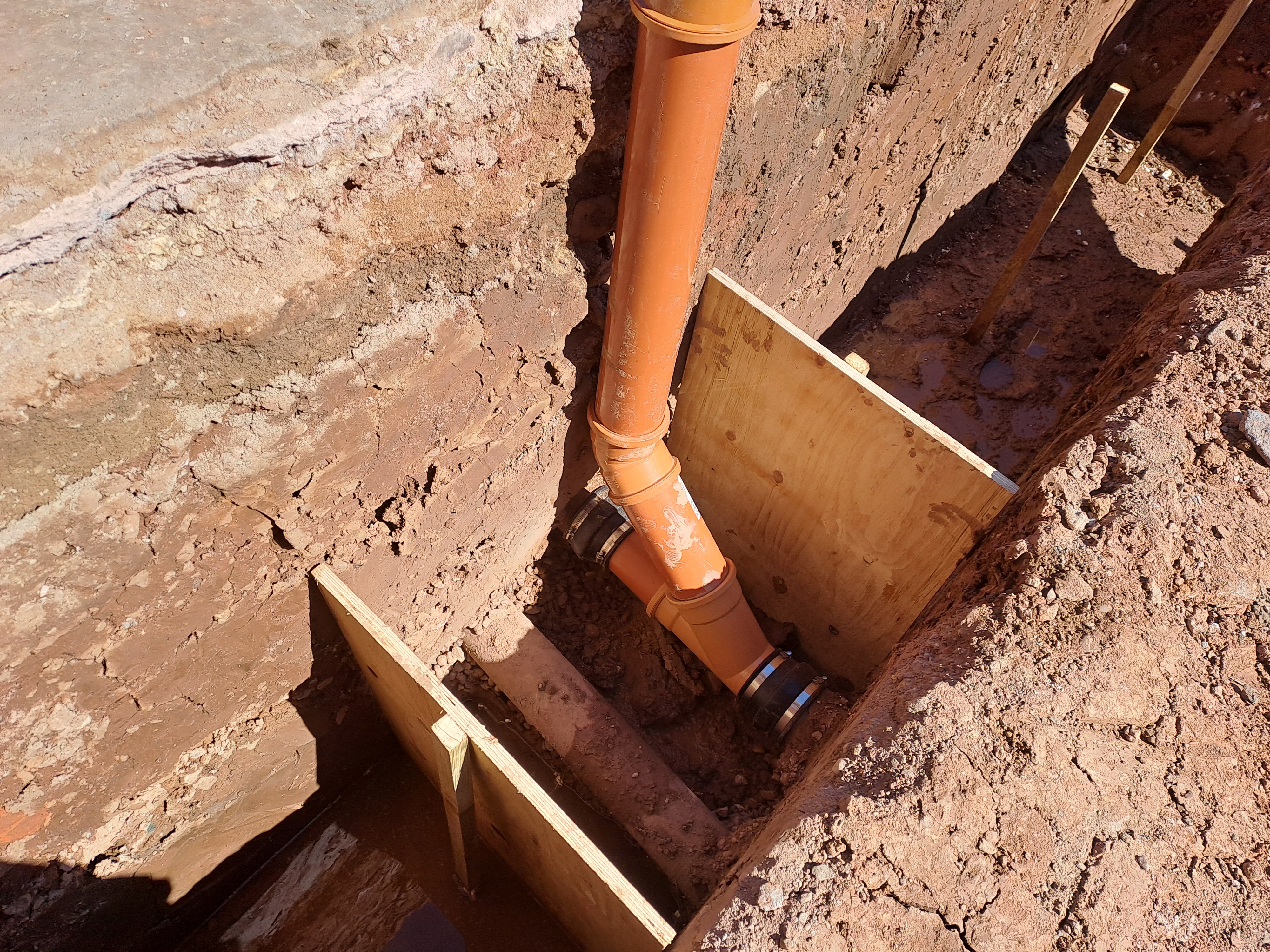

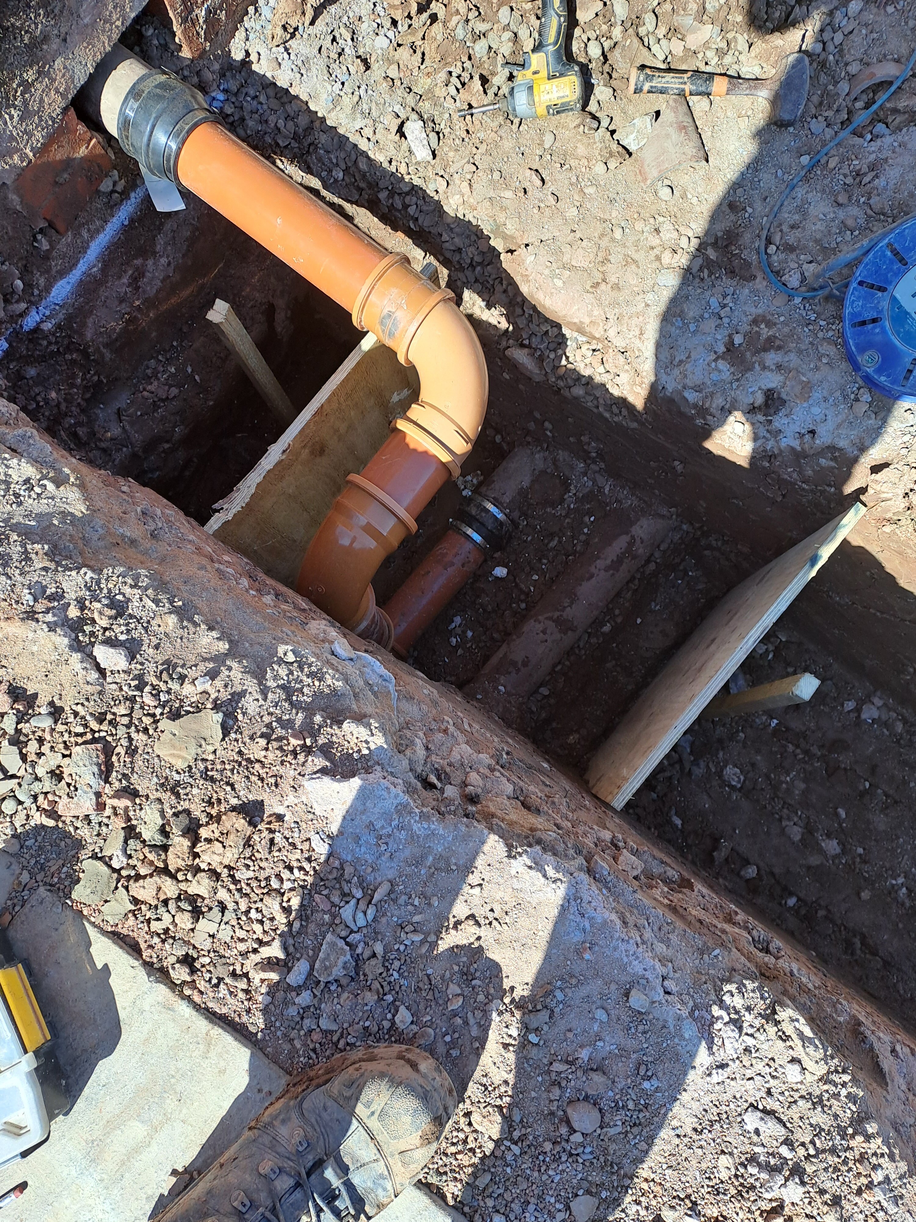

As a rule, any sewer pipes require 150mm protection as they pass through foundations.
Or if you can, move the IC out of the building footprint....
Great photos.
The question does not related to the foul run protection when passing through a foundation. The 300mm exclusion zone with lintel bridging detail is fairly standard and covered within the NHBC standards.
