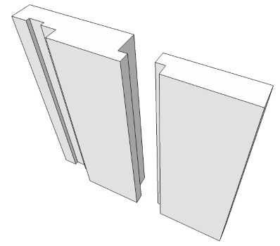

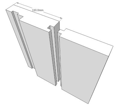

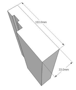

There is anither, easier and cheaper way to approach this, namely starting with a standard rebated fire door casing kit like the 110mm wide kit I illustrate below (see note below about terminology) of this sort of section:
you machine a rebate onto the inside edge of the legs and head using a router, portable saw or possibly even a power planer (so long as it will allow you 8 to 10mm depth of cut). You then take some 22mm thick planed stock, saw it to the required width (plus the depth of the rebate) and rebate one edge of that to match, fir two legs and a head. This is called a lining:

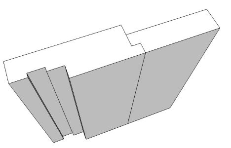

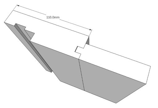

The two pieces are joined to the made-up door casing kit by glueing and skew nailing from the rear to form a single, wider casing of the desired width. The "leg extensions" can simply be butt-jointed and nailed or screwed to the "head extension", although a housed joint in the header is neater (albeit slightly more difficult to perform):

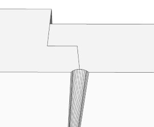

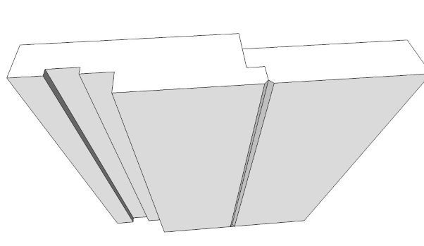

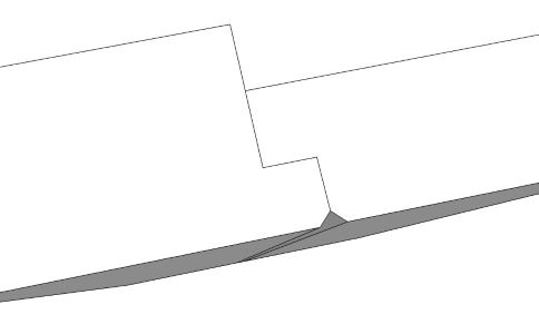

In order to make a less noticeable joint it is best to chamfer the mating edges of the two components where they abut, thus:

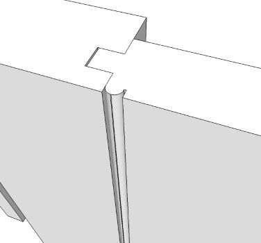

as this allows you to either flush fill the V-groove with 2-pack filler or alternatively to "wipe" a blob of flexible filler down the joint before decorating to create a shallow "rounded" joint which is relatively inconspicuous once decorated:

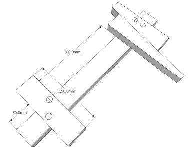

Yes, not only biscuits, but also Dominos, loose tongues, dowels (although that would take a bit of care to get the dowel holes to line up - loose tongues, biscuits and Dominos all have a bit of "shimmy room" making them easier to position correctly as there is some slop in the fit in one direction), etc. One thing I did miss out is the need to glue these joints together and cramp them until the glue sets. That would require no less than 8 cramps, but even there you can make adequate clamps up with some 2 x 1in (44 x 22mm) PSE softwood, like this design (there are other ways, as well):
I've been making these up for years on fit-out jobs - especially useful when you are doing stuff like wrapping a box around a 10 ft or taller column (or more likely 4 or more of them), and you really can't carry enough sash cramps (which we don't use in any case as they are a workshop tool - now you know how we fit column boxings :)). The one I sketched there has a capacity of around 200mm, although the wedge only allows about 20mm of leeway on the capacity (but you can always move the screws). The wedge and it's stop block are tapped with two hammers simultaneously in opposite directions to pull up the workpieces. I've made these up to 10 feet long before now and whilst they aren't sash cramps, they do work adequately.
