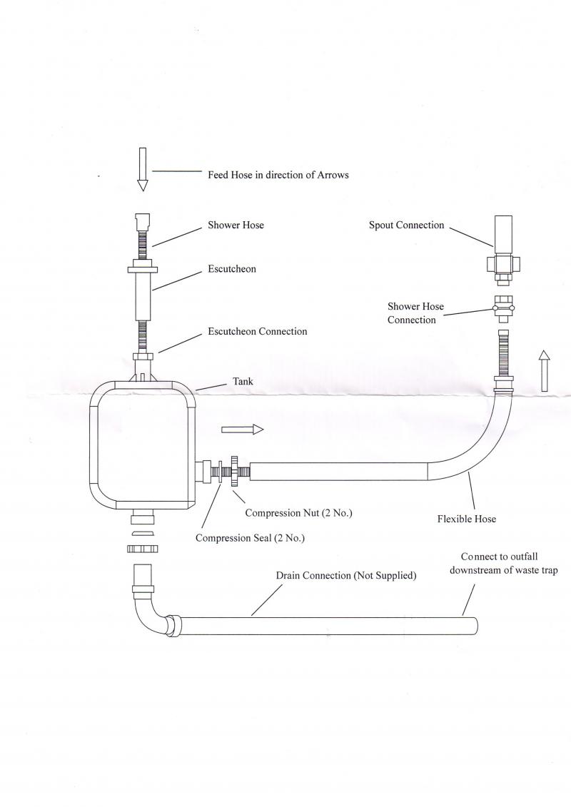

Some time ago I bought a new bath suite complete with 4 hole taps. ie main mixer taps plus a separate hand held shower fitting.
I have fitted many bath taps in the past but just opened the box and never seen fittings like these. It includes a plastic tank and the attached "instructions" - totally baffled!
Anyone fitted one of these?
Steve
the tank go's under the bath.
if you just had the hose come up through the bath any water running down the hose will puddle under the bath.
I see - Its because the hand shower isnt sealed - hence water can get down the feed hose.
So looking at diagram which end is the hand shower? Top right? With water flow indicated by arrows?
Cheers
by joe you got it
