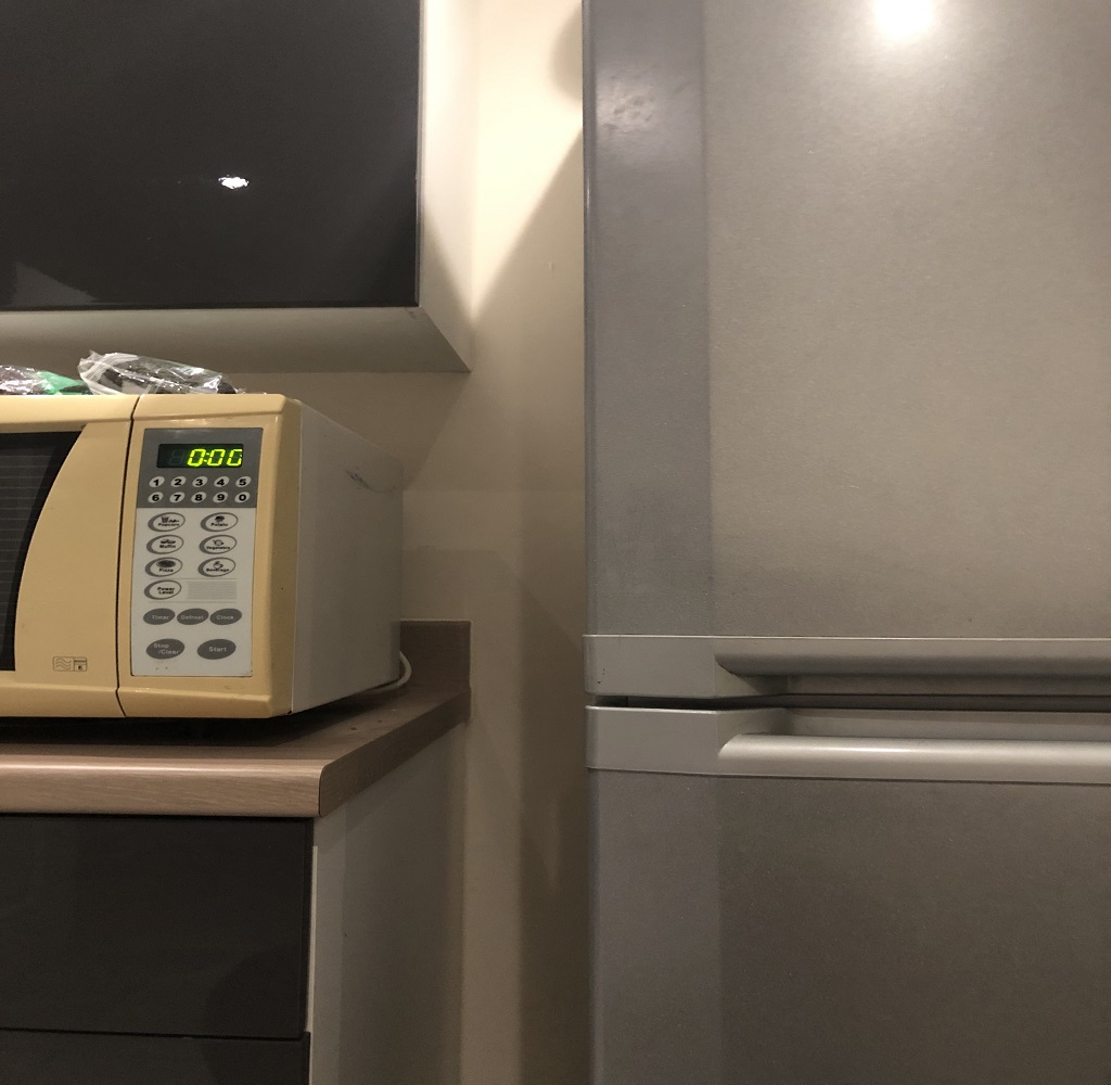

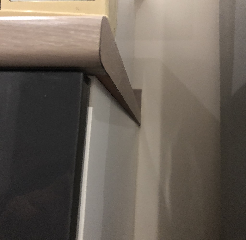

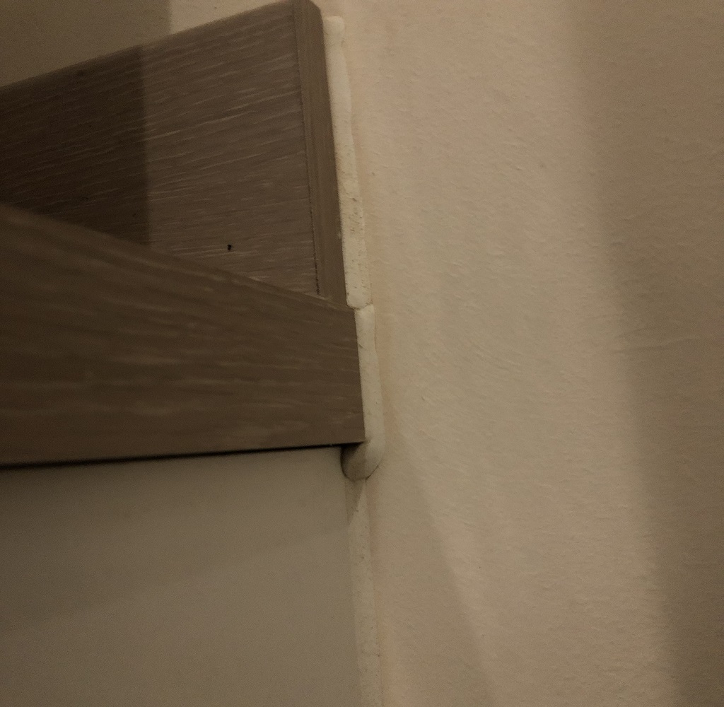

Hello,
I am looking to fit a full length end-panel to my existing kitchen units (similar to the photo 4) in order to add a pantry/larder unit. The existing laminated worktop and the upstand overhang the base unit by around 10mm (see photos) which would prevent the end-panel to sit flush against the side of the base and wall units.
I was wondering what the best way is to overcome this issue?
Do I need to trim back the worktop and the upstand and if so, what is the best method to do that to get a clean cut?
I would appreciate if anyonw could throw some light on this please?

Nothing easily done there to trim back in situ. Messy job to remove worktop too.
Is the wall unit flush with worktop or end of bottom unit? If former then perhaps add 10mm of white trim to front edge of lower unit side panel to fill void under worktop and fit new tall end panel as you want to.
No the wall unit is flush with the bas unit so the worktop edge has to be trimmed back
Or fillet pieces fitted in gap between full end panel and the two units.
I just can't think of a way of cutting that worktop neatly in situ. You could try a circular saw with fine tooth blade but it'll stop shy of the back due to the frame of the saw. You could then finish the last bit with a hand saw.
Can't you just use a shorter end-panel with its base scribed to sit on the worktop, albeit supported by only 10mm of worktop? The worktop end would then be inside the larder and could have a batten attached for additional support of the panel if desired and/or to support shelving.

I was thinking of cutting the excess with a router as far back as possible and then as you suggessted, Hand-saw the last peice?

Yikes! I would take the edging strip of and router it if possible, getting a clamp on the back edge is going to be a challenge thought.
