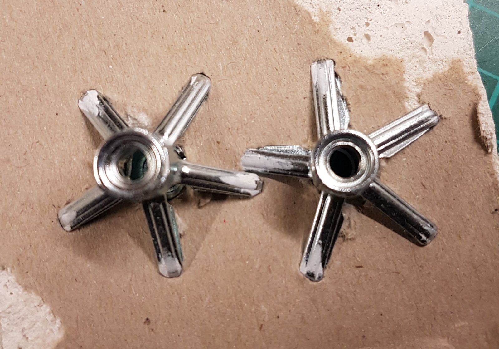

Yes, this type are the best when the screw holes need to be close together, they have the smallest drill size, so don't weaken the boards as much, right where you want strength.

Brolly type - metal flange sticks out a tiny bit and you ought to buy the setting tool for them, so more initial cost.

Look at the back of this offcut of plasterboard I did a test on ages ago.
See how great they spread the load over a large area, even when two fixings are needed very close to each other...

Scroll down in the eBay listing I linked to, to where it says "Grip Range" in red letters. 60mm is the initial length of the anchor, 65mm is the length of the screw. But when it scrunches up, it suits a wall thickness of 31 to 38, which is bang on what you need.
