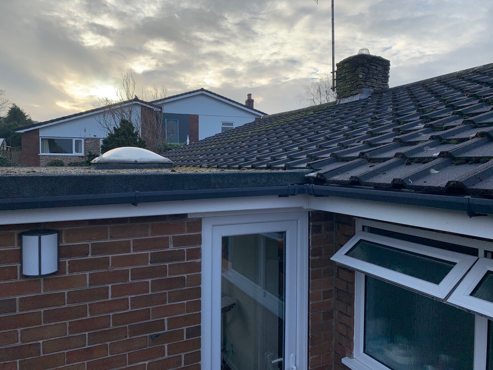

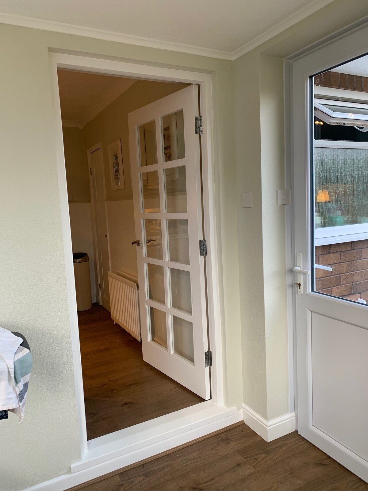

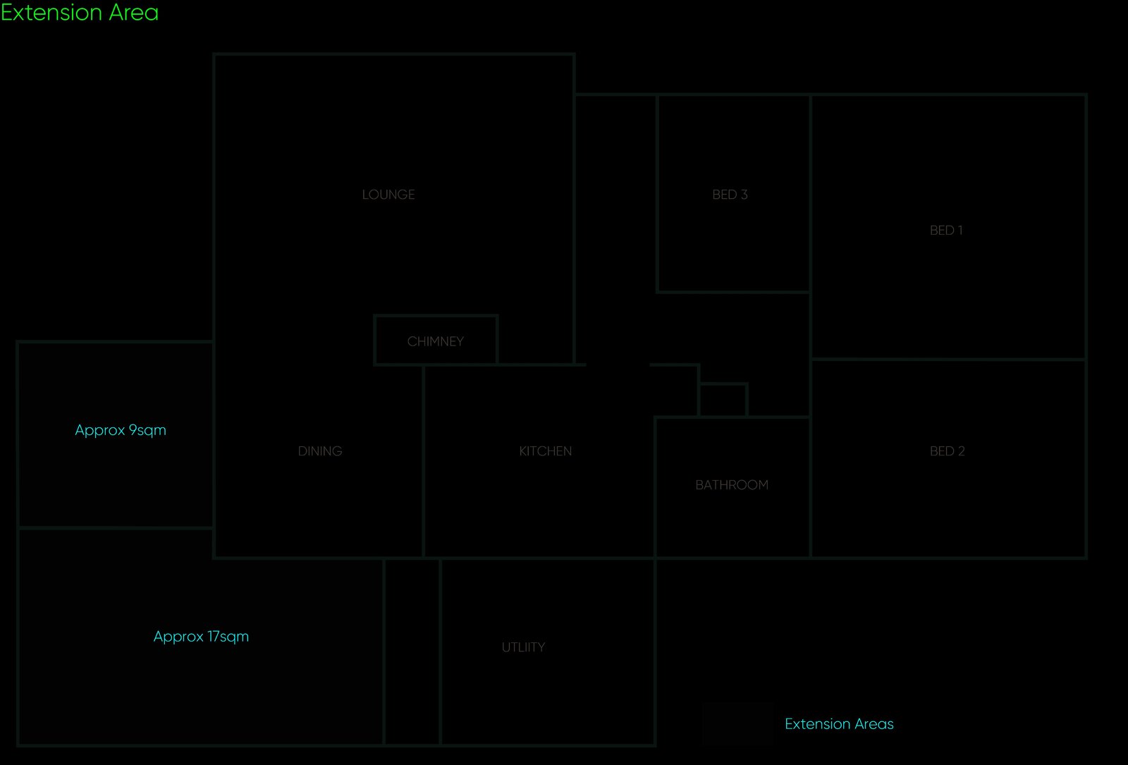

Hopefully someone may give alittle knowledge, not after full structual help just an opinion.
We are looking to add a small extension which will use a section of an old extension fitted maybe 20 - 30 years back.
The problem we have is the bungalow has a very shallow pitch, the current extension i believe is fiited to the eves/ceiling joists.
This means the ceiling is lower than the other rooms and the floor drops down.
We would like to extend over to the conservatory on the pictures, higher the floor to match the house and raise the celing to match.
Do people think this is possible?

It's standard and possible.
There was a recent post in here or the roofing section about this arrangement.
Is following that very low ceiling height a good idea or are you just trying to keep it within permitted development?
Sorry we would like the same height as the original so the extension and new extension roof needs
to go up around 300mm.
Im not very good at searching on here, if you come across the thread let me know please.

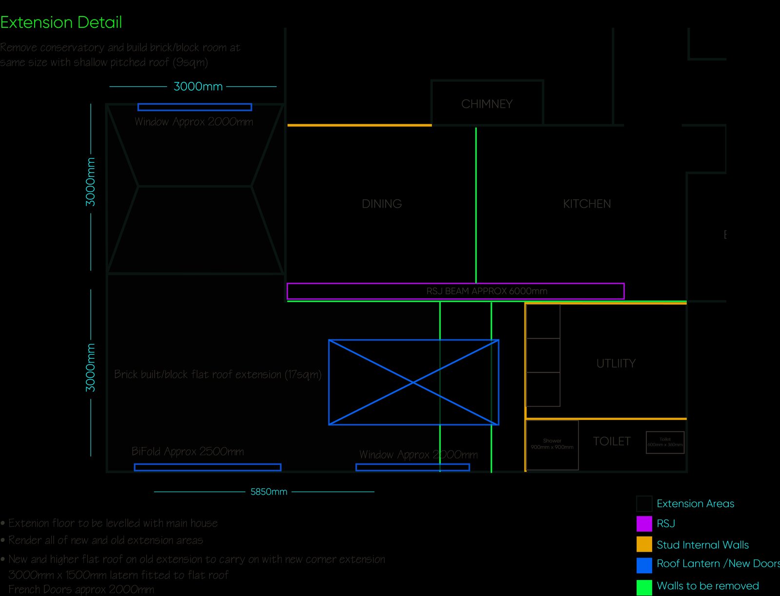

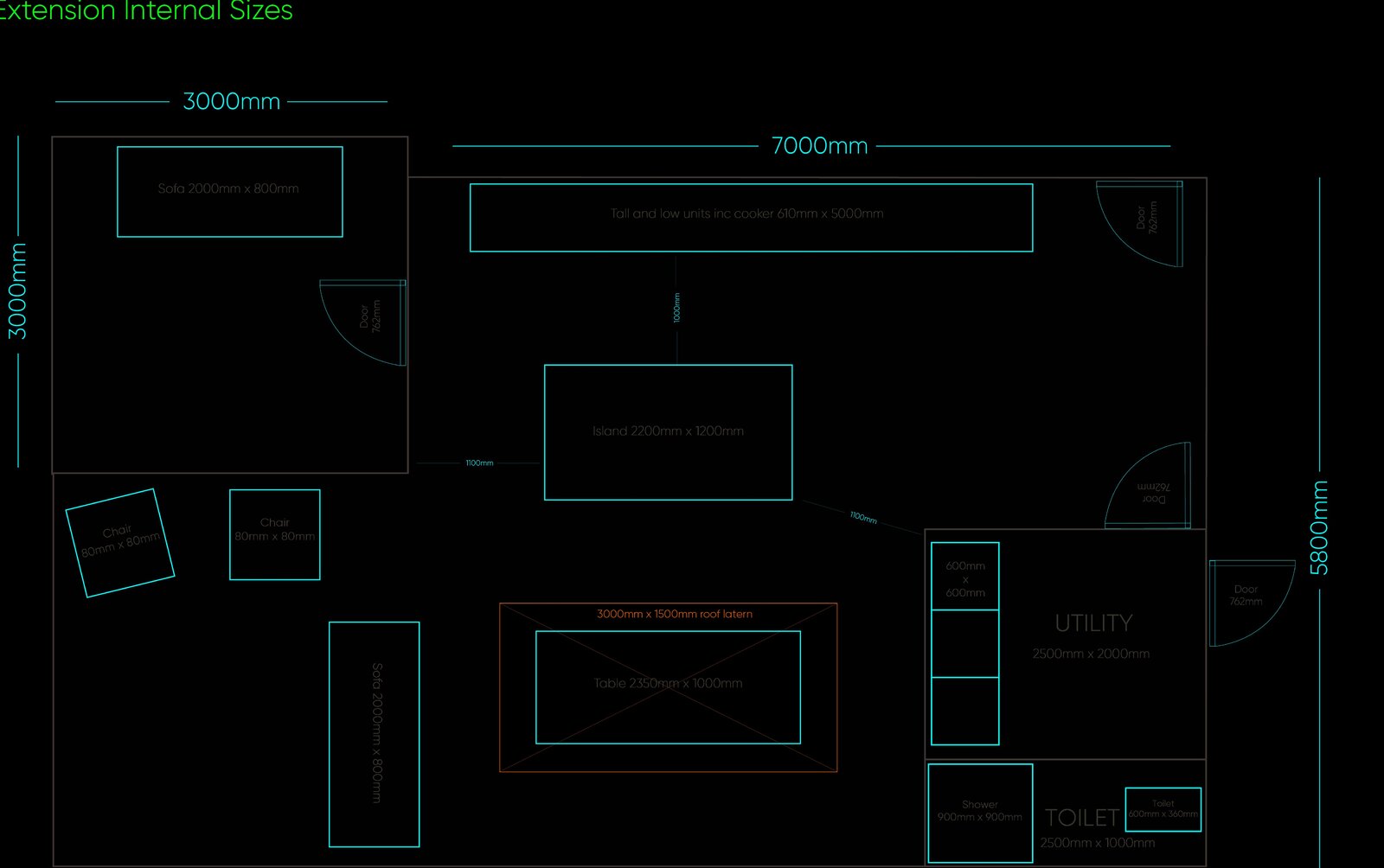

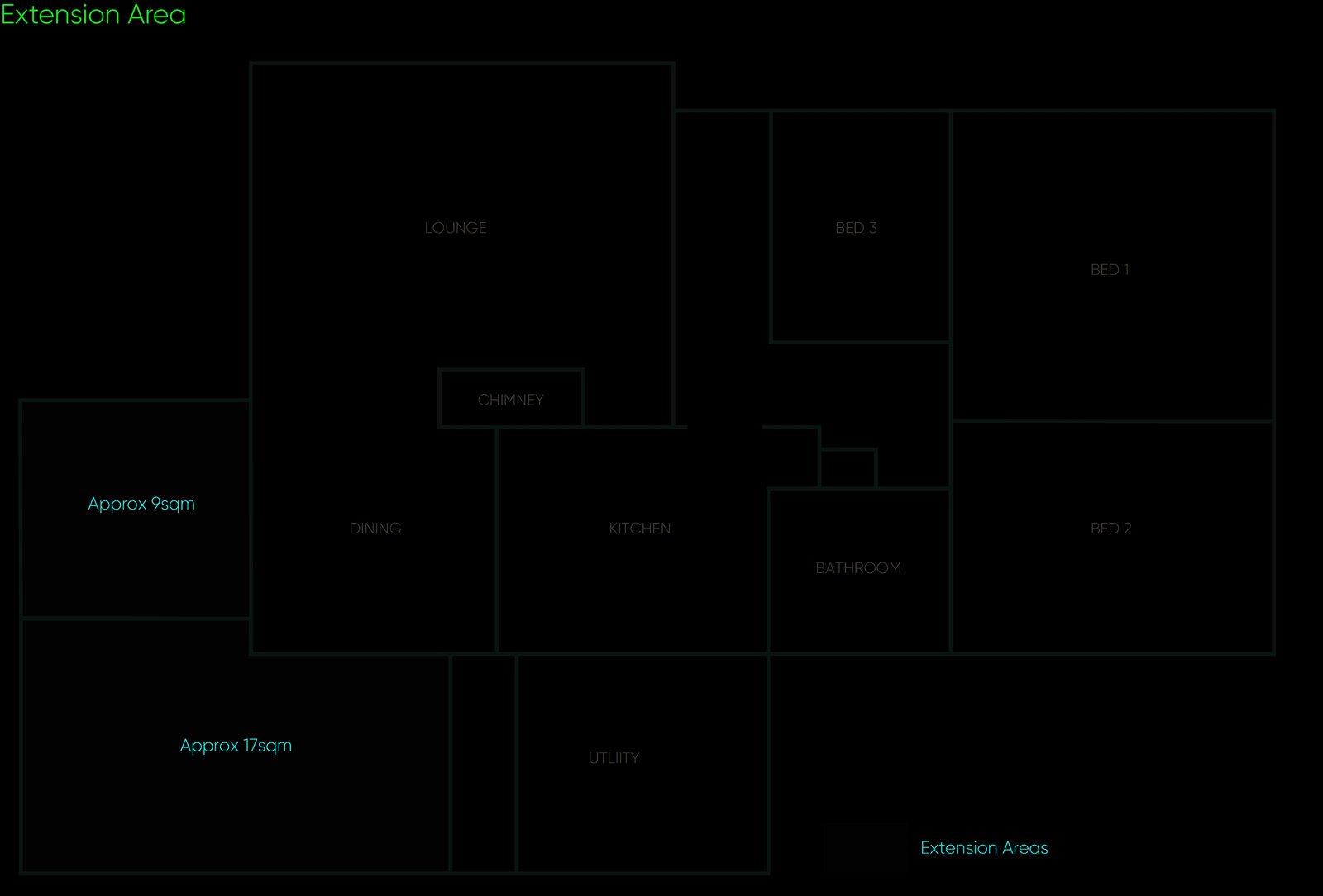

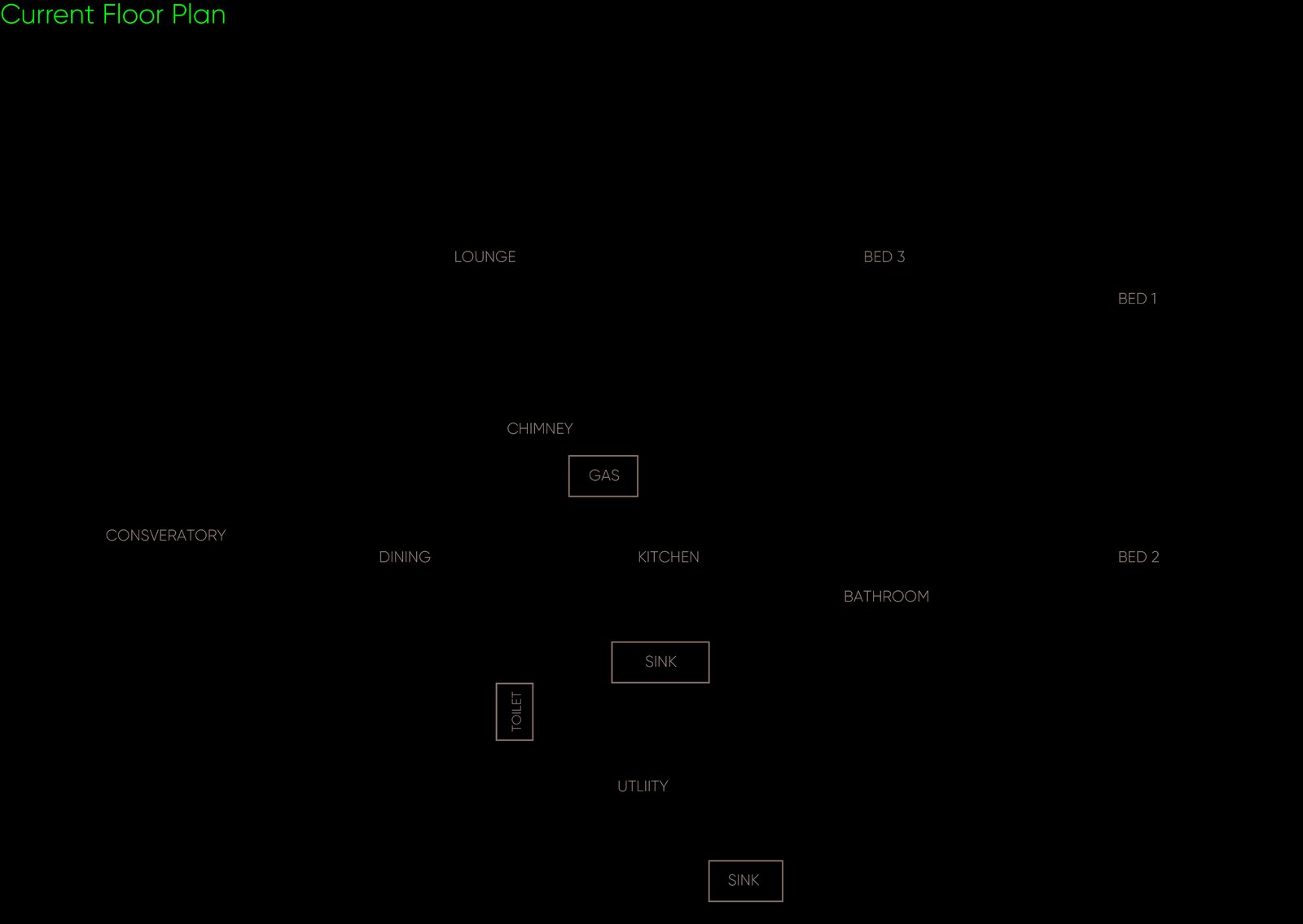

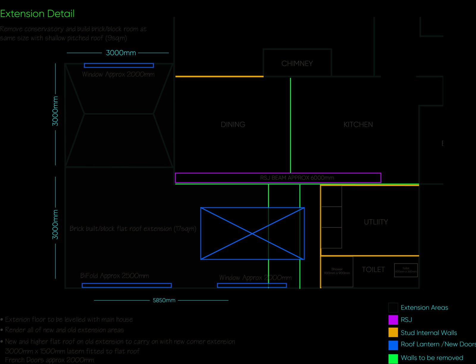

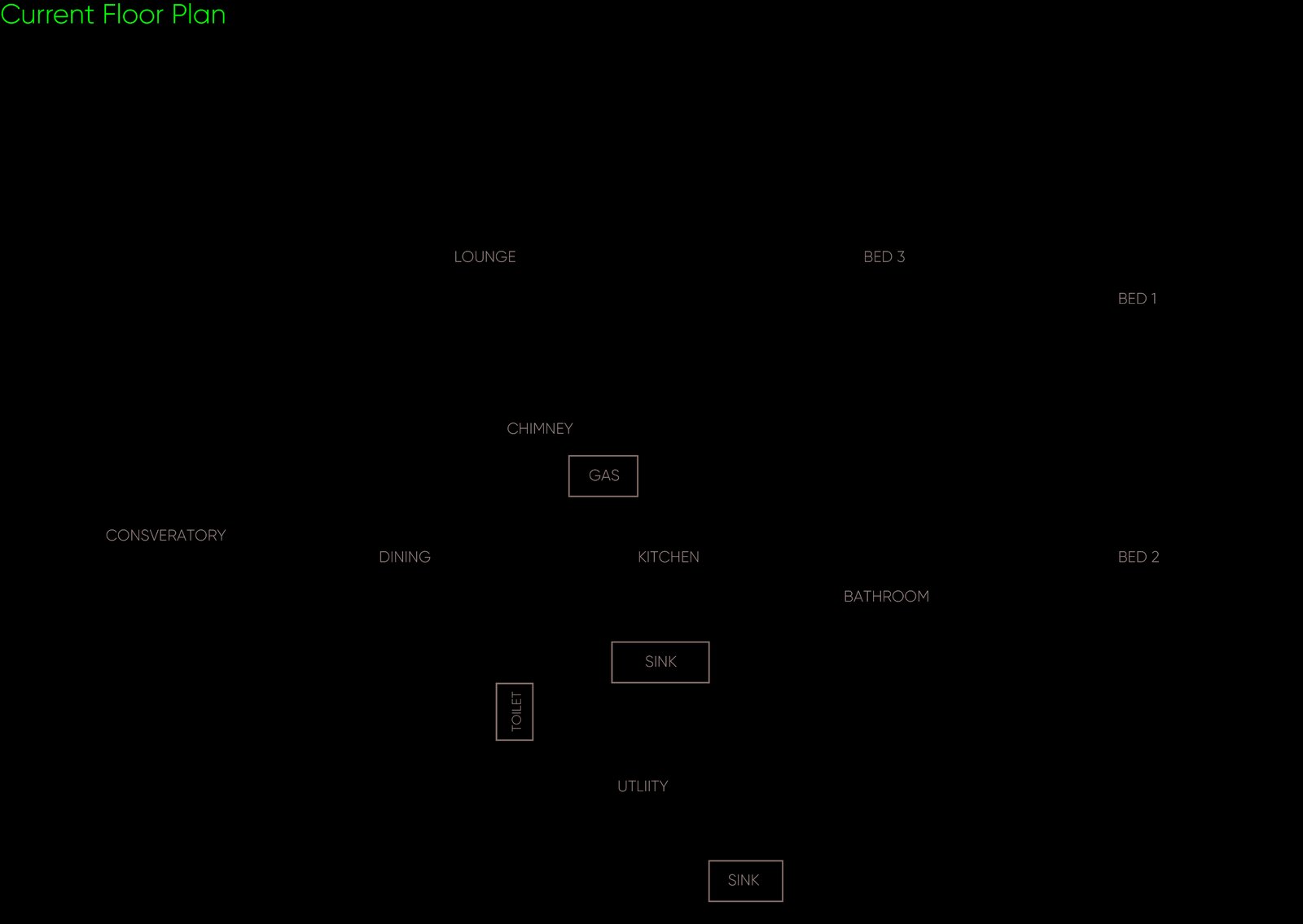

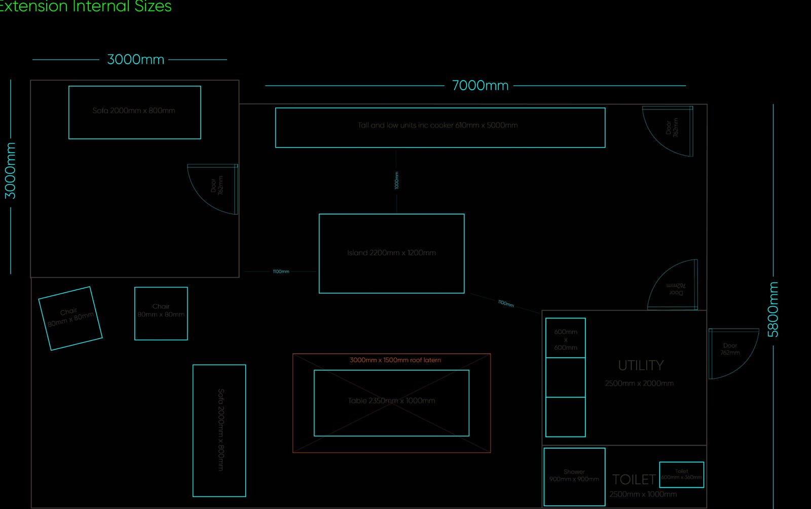

Thanks for the replies, my very simple drawings are as below.
Sorry we hope to knock the conservatory down rebuild to a brick room and then extend to the edge.
Its going to need some steels alright, does it look possible still?

It looks to me like the existing extension connects to the original roof about where the external wall is.
To get a higher roof it simply requires more tiles to be stripped off further up the roof, then connect the new flat roof joists to the original rafters.
The flat roof membrane, epdm, grp whatever....then runs up the pitch and then tiles are dressed back down over.
Bear in mind the goat roof will probably be a warm roof and the pitched roof will be a cold roof....so care with the detailing is needed.
