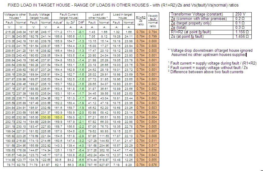

I think I'm now fairly convinced ....
Mathematically, that approach will only give the exactly correct answer if the ratio of supply voltage during fault to supply voltage without fault is exactly the same as ratio of (R1+R2) to Ze, and will become increasingly inaccurate as the difference between those two ratios increases. ........ it is (the small extent of) the quantitative effect which has surprised me, and about which I have yet to convince myself. An ~1,500% increase in the load on the network only seems to increase the 'error' in PFC estimation from ~0.9% to ~8%. I'm going to look at bit further at these figures and make sure that they really do 'add up', and that it's only my intuition which is 'surprised'!
See the simulation below. It's essentially the same as one you've already seen, but I've extended the range of the 'loads', and have added those two ratios I mentioned above - (R1/R2)/Zs and the (during fault)/(no fault) supply voltage ratios.
As you can see (and as we've seen and discussed before), when the total load on the network is extremely small (below about 3.3A) those two ratios are identical. (R1+R2)/Zs obviously remains constant (at 0.794), but as load increases the other ratio progressively increases a little, but even over a range of total loads from ~3.3A to ~836A, that ratio only increases (from 0.794) to 0.876, and over a more realistic range of loads, up to ~370A, it only rises to 0.830, at which point the error in underestimating true fault current is only ~4.3%.
It therefore seems that those ratios do, indeed, remain pretty close over a wide range of load currents, such that the 'conventional' method will give a pretty accurate estimate of true fault current (mainly with less error than likely measurement error of Zs) - and, as previously discussed (and explained), what small errors occur are all in the 'safe' direction (under-estimation of PFC).
Kind Regards, John
OK, I think I can now at least partially summarise:
The “true” fault current (PFC) is equal to the supply voltage at the premises divided by the (R1+R2) at the point of the fault (worst case = furthest point in circuit).
With TN-C-S and no loads (in target house or any other) on the network, then the ‘conventional (per regs) method of calculating/estimating PFC will give exactly the “true” answer. That is because, in this very simple situation, the only current which ever flows is the fault current. Hence, the no-fault supply voltage is equal to the transformer voltage (say Vt), and the during-fault supply voltage is equal to:
Vt x (R1+R2)/Zs
The “true” fault current is therefore
[ Vt x (R1+R2)/Zs ] / (R1+R2)
= Vt/Zs
Since the no-fault supply voltage is equal to Vt, the ‘conventional’ calculation of fault current will also give PFC as Vt/Vs - which is the “true” value.
When there is any load on the network the supply voltage (with or without fault) will be lower than Vt, and that results in the estimate of PFC obtained by ‘conventional’ calculation being slightly lower than the true figure (i.e. error is in ‘safe’ direction), increasingly so as the load increases.
I need to think and play a bit more to satisfy myself as to why these errors are always pretty small, even at very high loads, but the fact is that such is the case.
With TN-S, if there are no loads, the situation is identical to that with TN-C-S. No current ever flows in the neutral feed, so it can be ignored, and Zs relates to the only loop which carries current. Conventionally-estimated PFC is therefore again exactly equal to the true figure. If there is some load, then the conventional calculation will again result in an underestimate of true PFC. However, since the loop determining the supply voltage is now different from (and usually of lower impedance than) the loop carrying the fault current, the situation is more complicated than in the TN-C-S case - and, without checking, I’m not sure whether the ‘errors’ would be greater of smaller (for a given load) than in the TN-C-S case (I suspect greater).
With “pure TT” (i.e. the TT electrode represents the only path from MET to true earth), there is really no hope of the PFC being high enough for ADS (even with a B6 MCB), so the question is moot (but mathematically analogous with TN-S).
I would add that I make no apology for having raised this issue because the reason why the conventional method of estimating PFC gives ‘almost correct’ answers is, I would say, far from obvious when one starts thinking about it. Indeed, I strongly suspect that nearly everyone ‘thinks’ (because they have not thought deeply enough!) that it is just a simply matter of “Ohm’s Law”, and that the figures obtained are exactly equal to the true PFC.
