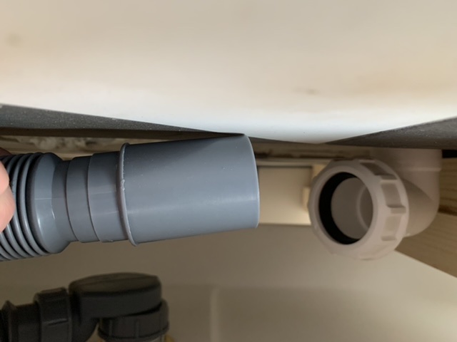

Hello, I don’t really know anything about plumbing so not sure if anything I’m describing makes sense. I’ve just got a new freestanding bath delivered and it’s currently in the bathroom sitting on top of 2 planks of wood waiting to have the waste connected. I’ve got a 40mm compression elbow sticking out the floor for the waste. The bath is pre installed with a slim profile trap and flexi waste. Only problem is the end of this flexi waste is too small for the compression fitting and slips out. It claims to be a 40mm pipe but measure at around 38-39mm. I think it might be a European waste. Any idea how I connect the 2? The bath company are not helpful and suggest I use a hepvo valve which I bought but doesn’t seem to work at all and doesn’t connect between the 2. Completely lost. Is there a reducer or adapter so I can get a 40mm compression to work with a 38mm waste? I can send photos or details of the bath and waste if it helps. Thanks!

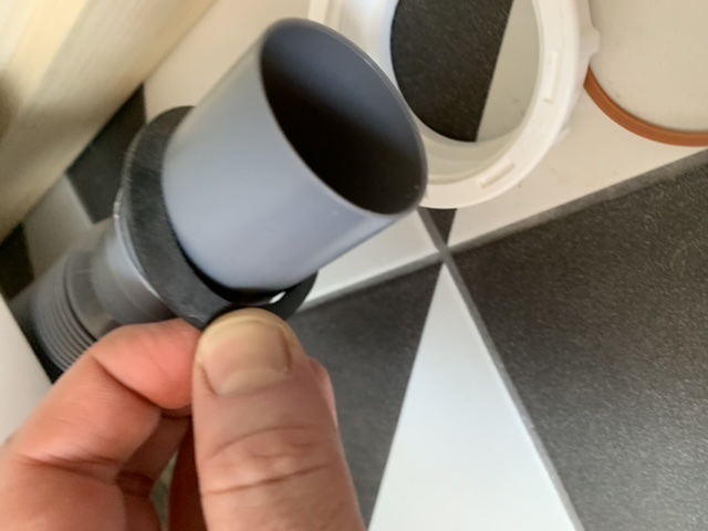

If it still doesn't fit the can you post a couple of pics with the end of the flexi with the nut, ring and rubber seal from the compression fitting on it.

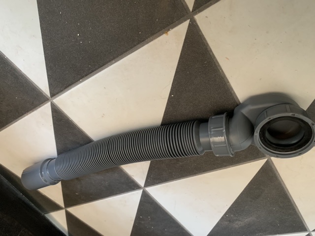

Thank you everyone for help. Flexi Waste is definitely too small for a 40mm compression, the rubber ring is loose when I put it on so won’t make a good seal. I’ve added photos. Also photos of the trap/ waste that came with the bath which I think it quite smart so would like to keep it if possible. I think the reducer dilalio has suggested would work. I take a Uk 40mm pipe from my compression elbow sticking out the floor and put that reducer on the end and connect to the grey flexi waste trap. Would that work?
I would get rid of that FloPlast elbow and go and get a McAlpine 40mm compression elbow and try that, it has a centre piece that slips inside the pipe and traps the seal in between both the surfaces and would probably grab that quite happily.
