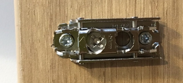

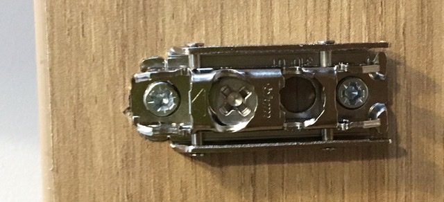

My hinges don’t look like your photo, it’s like this:

Ignore that, the big screw allows adjustment.

On the picture of the hinge I took above, you’ll see a screw in the middle of the ones that connect said hinge to carcass.
Get the door on, but remove the soft closer, you can then shim the door up and down by turning this middle screw.
When finished slide on the soft closer.
