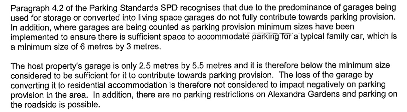

Your experience does not mean it applies to all applications with all LPA’s. I have recently dealt with an application that was approved because of others having already carried out the conversion and sub-standard garage spaces as per the attached image from the Planning Officer’s report.
Wonderful. I'll organise a national clap for DOH from our doorsteps, next Thursday. (y)
Cracking!
However, I’m glad the OP is aware that you can still get Planning even if others have done it along with sub-standard garages.
“Each application is determined on its own merits and is on a case by case basis...” Good old Planning caveats.
