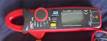

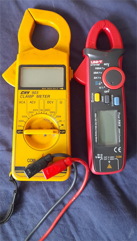

I find there is a point when it time to abandon trial and error. Look for the easy things of course, water ingress etc. But at some point you need to get the meter VC60B.jpg out and test, the VC60B shown will cost around £35, if not tripping all the time you can try monitoring the leakage 1664546414596.png but either way the meters cost around the £35 mark, and for a one off job is it worth it?

That seems to point to the RCD, and a RCD tester is not cheap, I would think cheaper to replace RCD than to buy tester.
