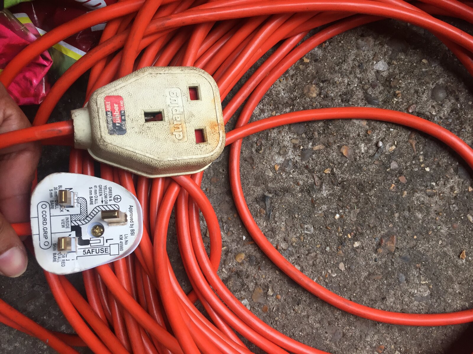

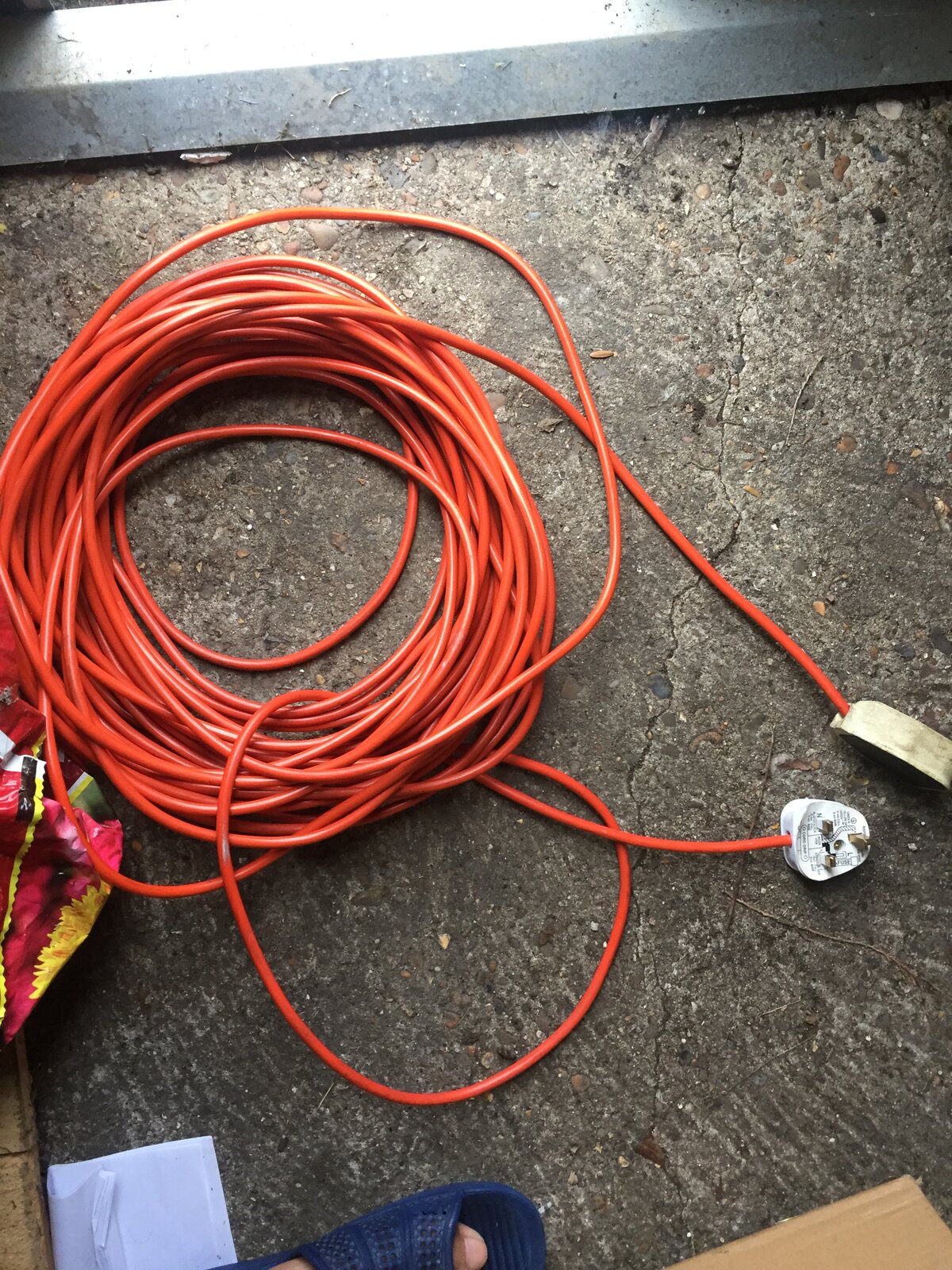

Was looking to replace my old garden extension cable , about 17m in length, its used for lawnmower n hedge trimmer, its 3 core with a similar cable costing £25.
Found a longer orange coloured on a trip to a boot market which needed a plug to be replaced only, did this and to my surprise its only 2 core with no earthing inside.
Is this always the case with external orange coloured extension cables?
2 core is only suitable for use where the socket on the end has 2 holes, and the matching plug has 2 pins on the hedge trimmer, lawn mower or similar.

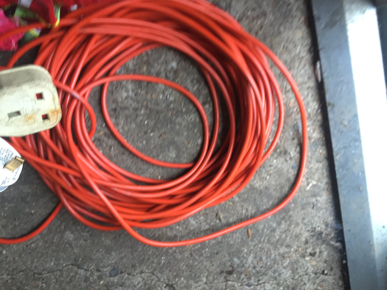

The orange extension cable was a ligit one, no cuts, its branded duraplug as well, its orange so its made for external use.
I think the clue is in the type of plug you replaced.
What was on the other end of the lead? was it a 13A socket? was it moulded or rewirable?
In my experiance moulded extension sockets are rare in the UK, so there is no way to visually tell the difference between a lead that was sold readymade and one that was assembled from components by the end user.
one end is a moulded socket, the other end had a non moulded 13a plug.

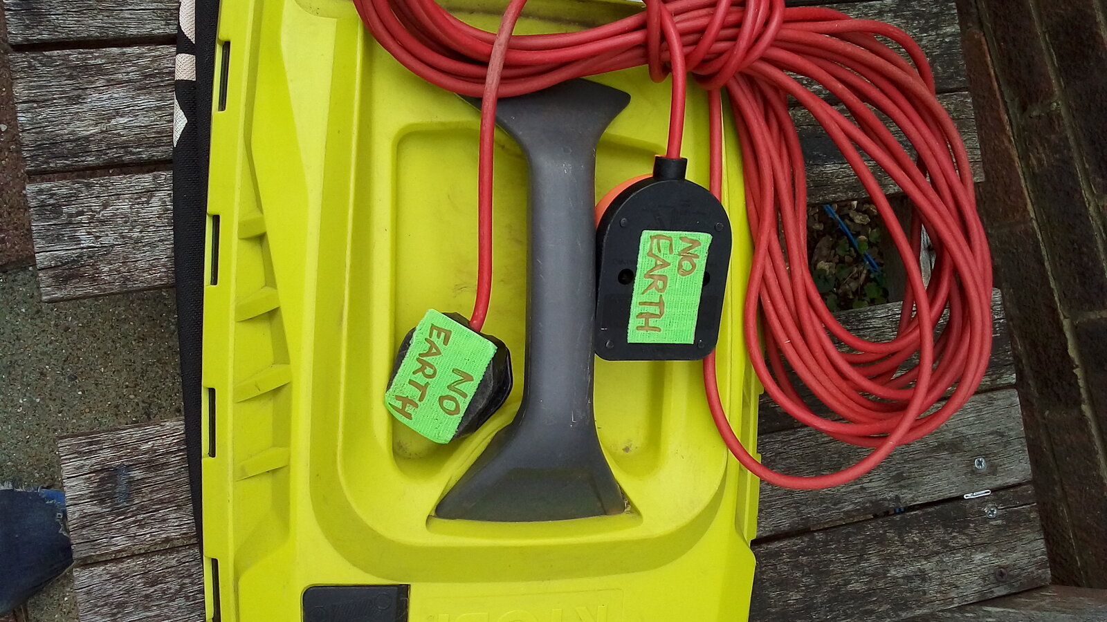

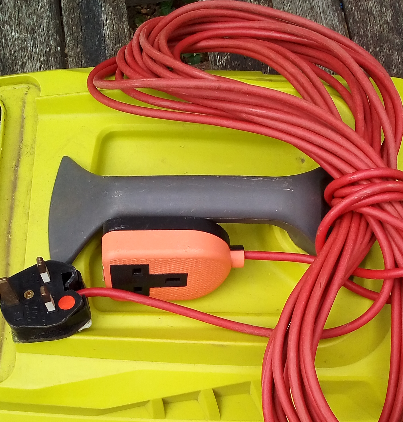

Yes the cable is like that, mine is orange.
That was one I'd PAT tested and condemmed, it had originated with a gargen tool with a different socket as the story goes. They asked me to dispose so it got dumped in the car and I've been using it since for a lawnmower.:oops: But in the pics I see its getting quite shabby sp it does need to visit the metal shop in the sky.
