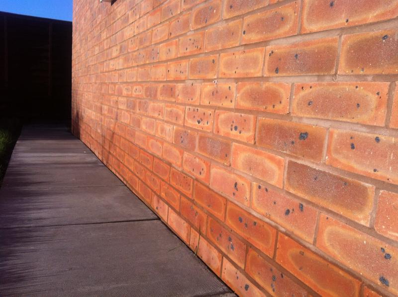

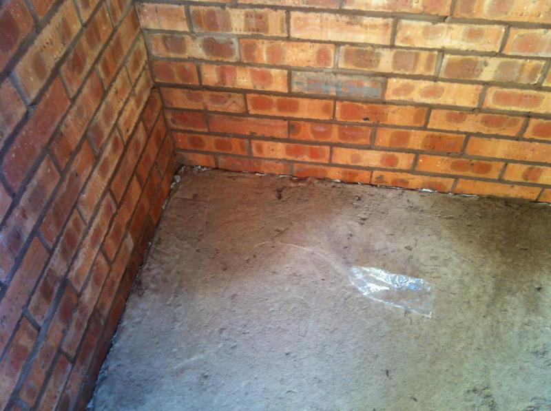

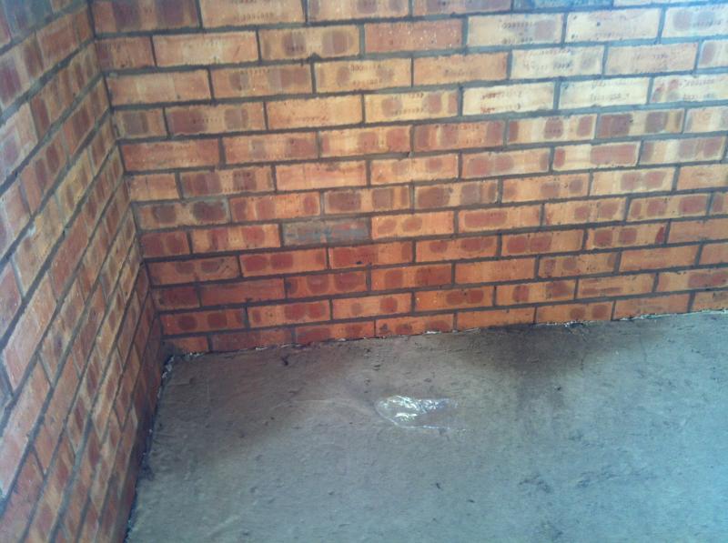

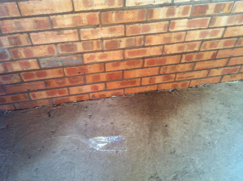

Hi all,
I'm after some expert opinions please!
I had a garage built in my back garden in the summer - i've just gone in and noticed that there's damp on the floors. We only had it built with one layer of bricks so I'm assuming the bricks being wet is to be expected, but the floor should be dry shouldn't it?
I just want to make sure I know what the problem is before calling them back in.
Many thanks if you are able to help out with some ideas and potential fixes!
Thanks,
Sunny
There is a specific reason why architects, designers, building control etc, insist upon builders using rated bricks and 3:1 mortar below dpc.
Your bricks look like very soft chalky fellas and are acting like sponges.
Did they install a dpc? I can certainly see evidence of dpm.
Well they chose the bricks from somewhere called Carvers (wolverhampton); as far as I can tell there's no damp proof core.when it was being built he did say we shouldn't plaster the inside walls as it would get damp.this is just meant to be a storage garage really so I was fine with that,but the floor shouldn't be getting damp plus I didn't think the bricks would be this bad either!
Is there anything I can do to rectify this,or is this defintely a phone call to bring the guys back in?

There is clearly a DPC, as you can see the dampness in the bottom few courses and a dead straight line where the DPC is stopping it going up further.
But, there is no use for any DPC in this single skin garage ... it's not serving any purpose at all
That garage will always let dampness in via the walls ... its single skin and that is an inherent problem

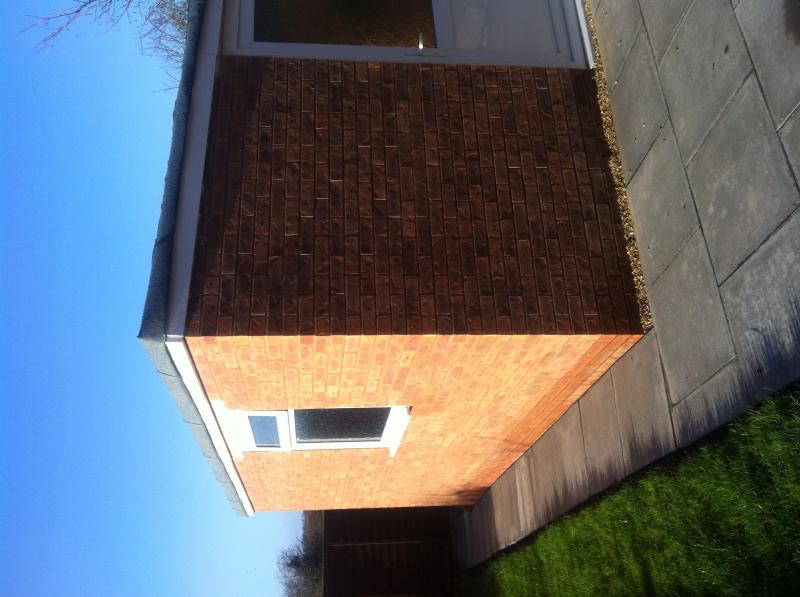

From my experience, when the garage wall exterior had not been rendered, (single skin 100mm blockwork) the floor was wet with condensation, in the winter, despite there being a dpm and 100mm ploystyrene insulation in the floor.
Since rendering the exterior there's been no damp on the floor whatsoever. Obviously there's a dpc in the wall.

If the walls are wet and the floors touch the walls then the water will bridge.
If you want a completely dry garage then you pay more for a double skin wall :confused:
