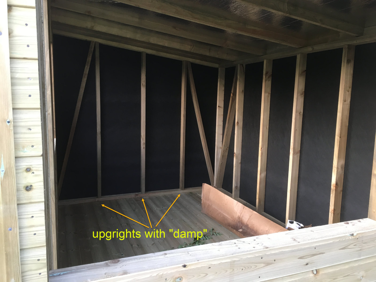

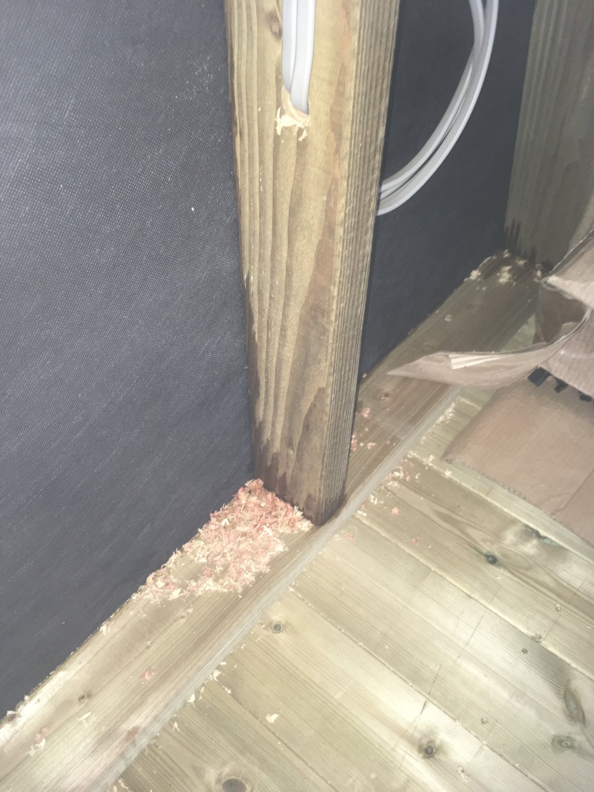

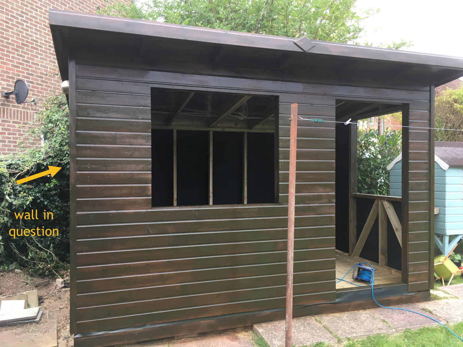

So I'm in the process of getting a garden office installed. It was put together two weeks ago, windows and doors have been in since last week and I'm currently waiting for the insulation and cladding to be done. Annoyed that it's not done yet, but also pleased because you can see things that would otherwise be hidden behind the cladding (y)

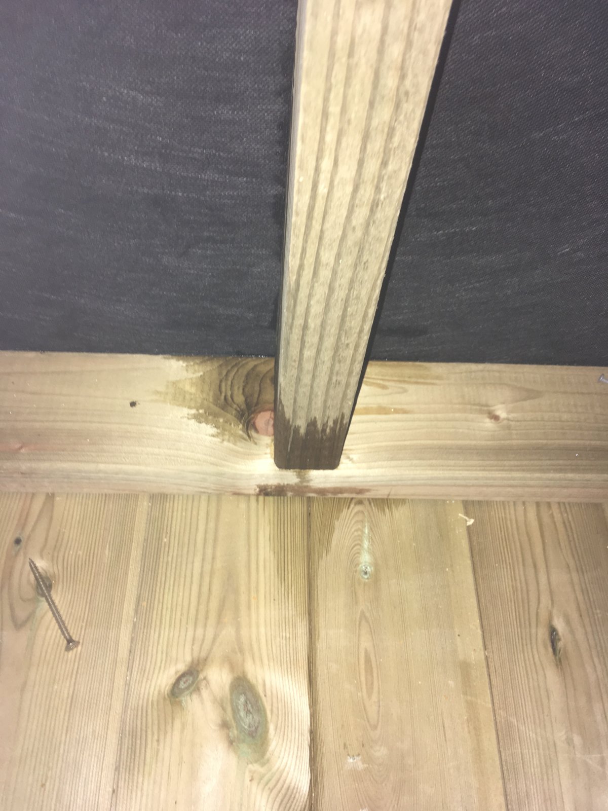

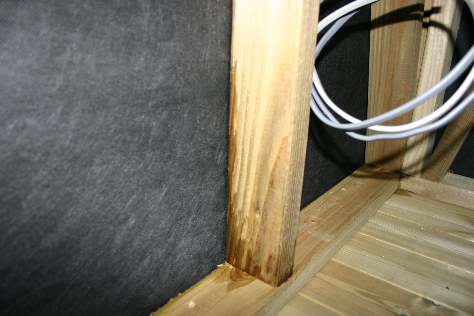

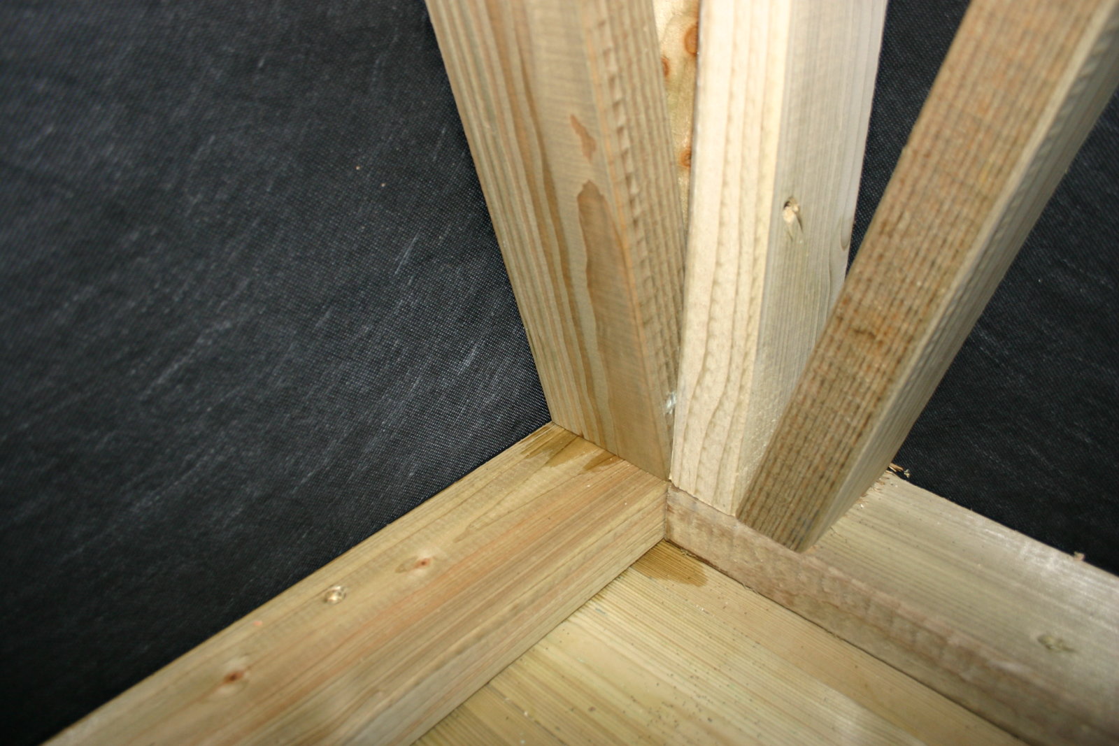

So after a day of very persistent rainfall, I notice damp around the bottom of the uprights and some floor boards on one wall only (it's the weather facing wall and it did rain rather heavily). I've marked it out on one of the photos, it's the wall to the left. It looks like it's seeping in from underneath or behind, around the uprights and also part of the floor boards as can be seen in one of the photos. Difficult to pinpoint a source since there is vapour membrane inside. After the sun came out it dried really quickly.

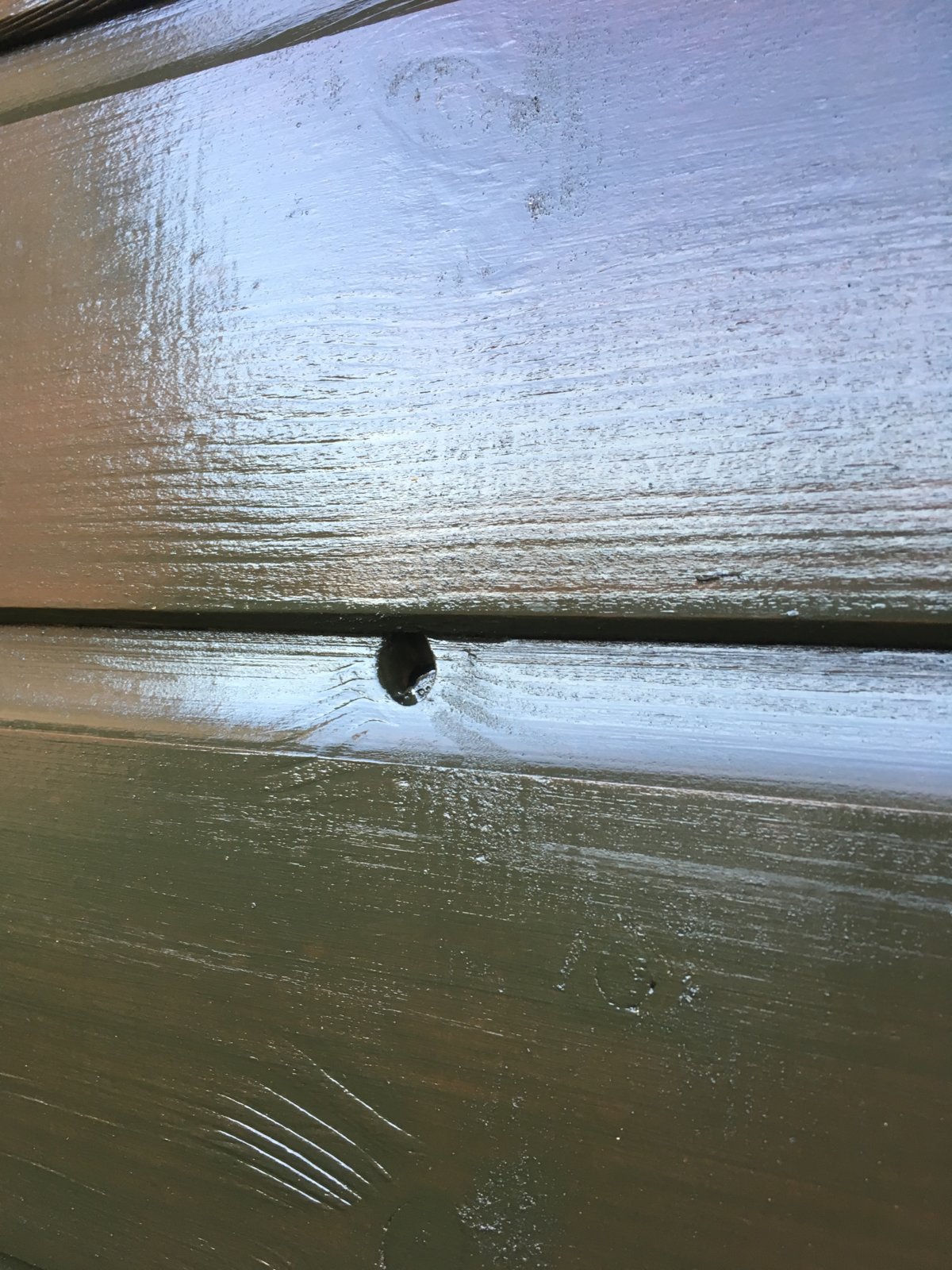

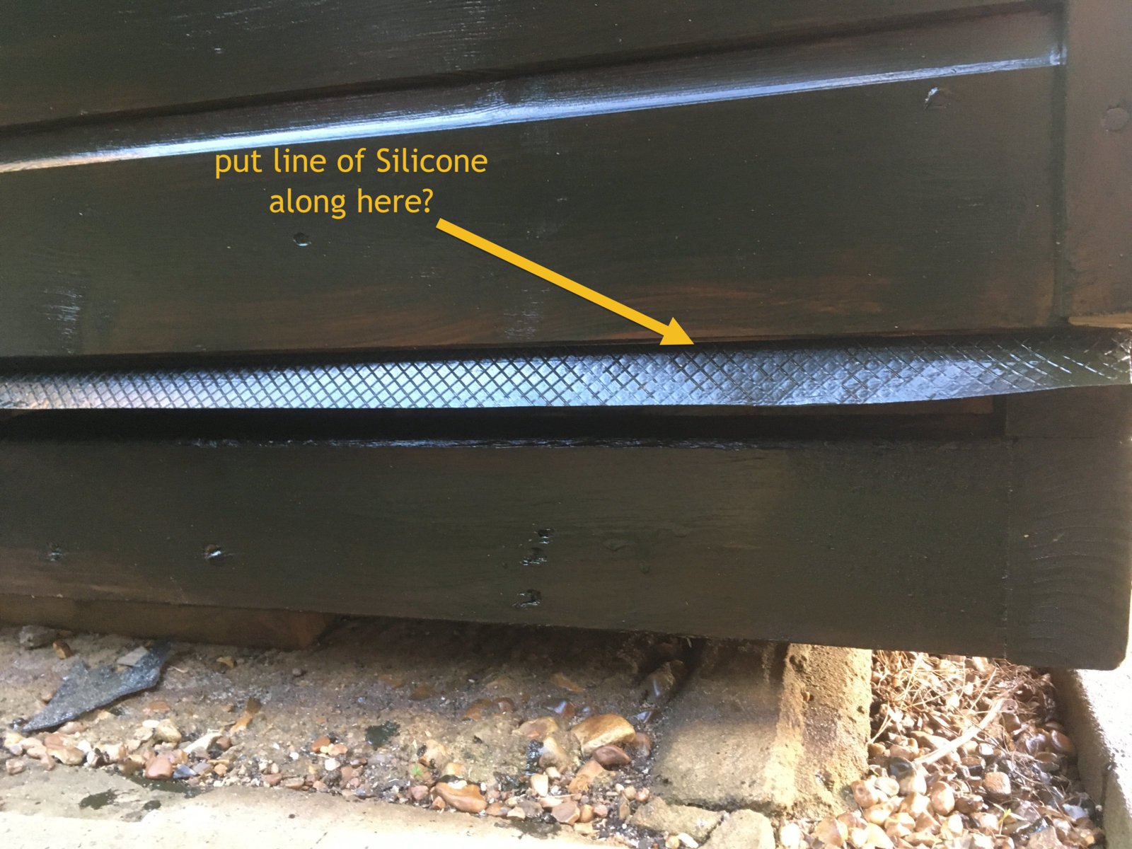

Now 1) I have pretty much done. It has 3+ coats of paint on. Guttering is attached to the back (the wall that has the issues is one where the the gutter would run down at an angle - I don't see how guttering would even work in this case nor how it would help with the issue) 2) I'm really not sure on this one...I would have assumed that if that is true, it would have affected all walls, not just a single (weather facing) one. 3) There are some knots that I can fill (knot.jpg). I'm also tempted to put a line of silicone just above the damp proof course to avoid any water pushing in and up, although I think that's a little far fetched. (dpc.jpg)

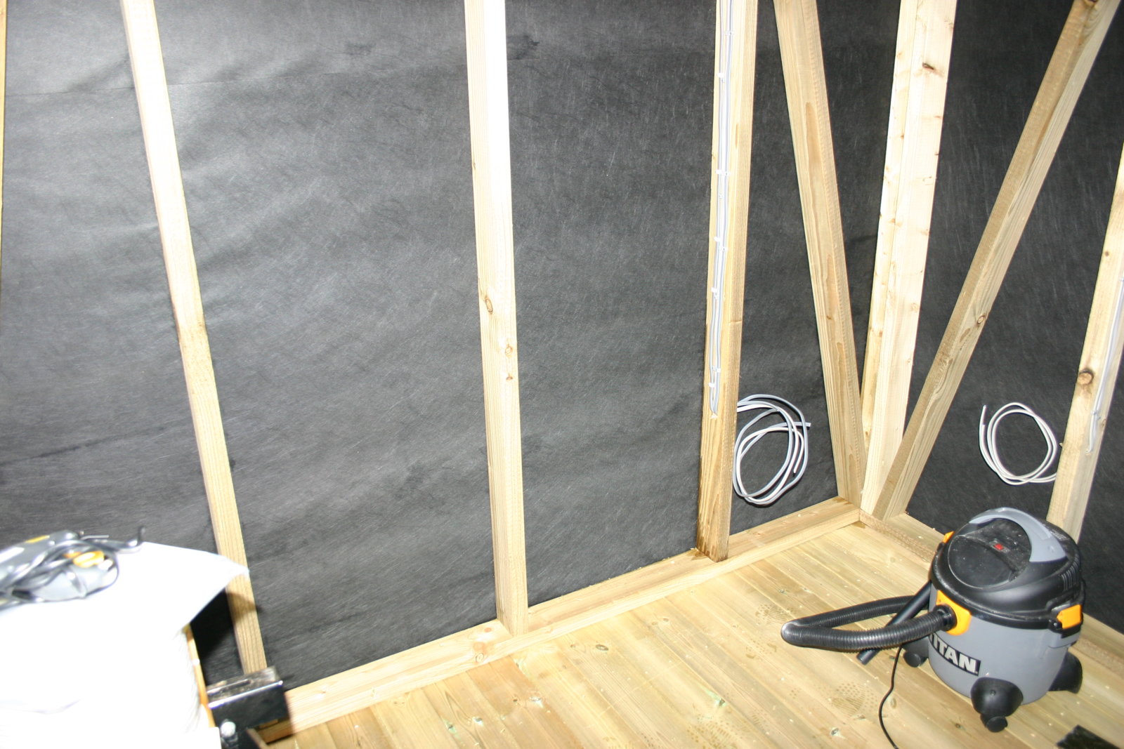

But I have a similar office and I would NOT put the bead of silicon where you suggest (above the waterproof sheet).
This is because on my office this is where the water leaves the building, and you silicon would trap the water.

Looking at your images, the fact that I can see some water stain on the floor boards, and on the waterproof sheet (I think to the left of the upright stud) worries me that water is perhaps entering from roof, of through where nail hole is attaching the cladding to the stud.

I cant see that its the where the dpc is -that is below the level of the bottom framing.
most likely it is ingress through the cladding.

Get you hose pipe out and work your way up that wall -you will see if water is getting in anywhere.
I know the membrane should stop it but it could get through where the cladding is nailed on.

Thank you both! In this case it looks like the breather membrane is fairly flush against the cladding from the inside, i.e. when when I push against the membrane from the inside I hit the cladding pretty much ASAP.
I will give the hose pipe idea a go and see whether there is anything obviously coming through, thank you! I will also fill in all knot holes and look at the nails that hold the cladding in place. Some of them seem to have been driven in rather deeply (nail gun presumably), maybe there is water coming in through there.

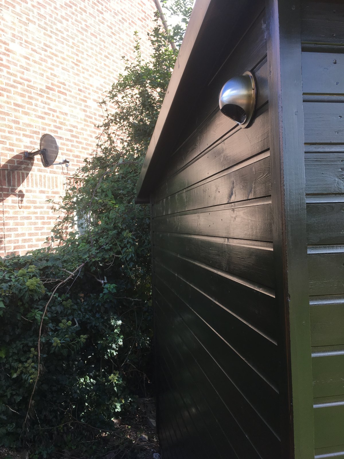

I have an air vent on that side also (see photo), will probably put a seal around this so that at least no water comes through around there also.
Out of curiosity - I have two air vents, one either side. The one on the opposite wall has been pushed through the breather membrane fully so it basically terminates in the inside cavity that will be filled with insulation before cladding. The one on the wall in question here is still sitting behind the breather membrane - pushing it inward so any air coming through would not make it through the breather membrane. I assume the first one is correct - i.e. a hole cut through the breather membrane to allow for air flow in?

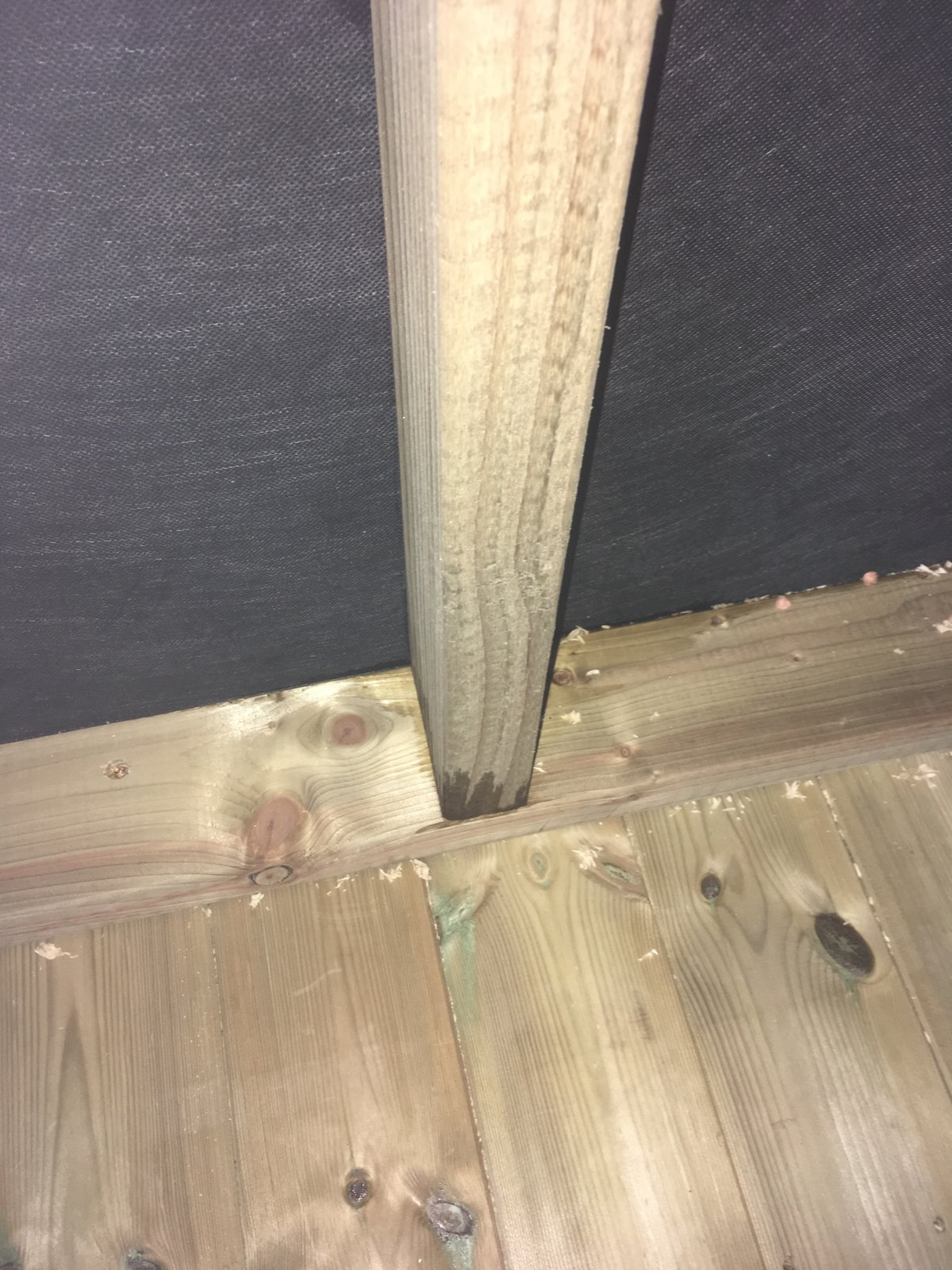

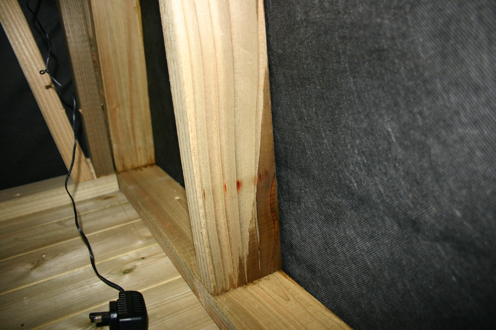

So I went around the cladding again and made sure I filled up all the knot holes, nail holes and any cracks. Another two coats of paint for good measure. There is absolutely nothing obvious outside as to where water would be coming in and of course it's been nice and dry until today.
Not so much now - this is after four hours of rain.
All exclusively along the same weather facing wall.
The cladder is coming on Monday but I'm really not happy with having this cladded and insulated in its current state. Surely it will just rot with damp like this.
I still cannot make my mind up at all and see no evidence as to whether it's coming up from the bottom and coming down from the top. The top parts of the uprights are absolutely bone dry so surely that means it all seeps up from the bottom? But what could cause that? A defective DPC?

I had a similar issue last year with a summerhouse, turned out it was rain splashing off the ground and underneath the base. I dropped a load of gravel to absorb the rain in a strip around the summerhouse and this solved my problem.
If i were you I would try to remove that DPC altogether or shove it right in past the cladding just in case that DPC is catching rain, either directly or from ground splash and sending it inbetween the building and the base.
