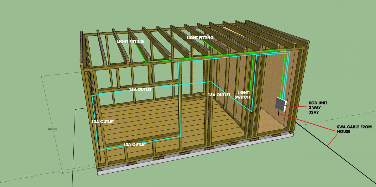

some advice needed. Before I ask advice I will be getting any wiring signed off and completed by a qualified electrician before connecting to the house mains.
I just want to save some time / money by running the cables around the stud frame of my garden office and want some basic advice if anyone can help.
I've done a simple diagram and overlaid what I've been advised is the setup for simple low-power garden office. I just need to know if I need to ring the lighting wiring like the ring main on the sockets to the RCD as well. Also do sockets need to be a certain height off the ground?
I am not entirely sure of the consumer unit required. Is this a simple 2 way i.e. one for lighting and one for mains ring?
Nothing will be high powered... maybe max just a 1kw heater needed in winter. Any advice on how this should be setup, what I've missed etc. I was presuming 2.5mm twin and earth ring for the mains and 1.5mm for the lights?

No, you don't need to 'ring' the lighting.
You don't need to 'ring' the sockets either.
If you want an electrician to 'sign it off' then you really need to employ one now and follow HIS advice.
Outside power is not a DIY job.

Never suggested it was a DIY job, but getting electrician to route all the cabling, drilling holes in studs etc will take the most amount of their time and is not a necessity in my book. Everything will be left exposed to check and nothing wired in. I was hoping an electrical might just be able to approve the couple of queries I have.

My understanding is - to get Electrician signoff you need Electrician to fit the cable (or you fit the cable under his direct supervision) - not you doing it yourself and then asking him to signoff.
Regarding your drawing, my suggestions would be:
- If fuse box is needed have it higher up the wall.
- Have more sockets.
- Have the two light fittings have two switches (you can always change to one later, but harder to change to two).
- In the side room, Have a socket near the fuse box and another socket and a light and switch.
- Have an outside light on PIR above door.
- Have an outside socket.
- Have a circuit for heating (how are you doing this, Oil filled radiators, electric wall radiators, underfloor hearing, Combined AC/Heating Unit?)
- If two rooms have Smoke alarm in each so you know if one is on fire when in the other.

Sorry I do not what the specs are for Part M - I have always tasked the Electrician to meet the required specs and so I would expect expect the Electrician to asses the drawings provided by Jonny, and then install so that it then meets all the required specs.
My comments we intended only to address where I feel the appliances/sockets/switches/etc would be better located, not the specs to do this. I felt his drawing showed the Fuse Box as being too low (at knee height) to easily access and the drawing would be better if the fuse box was at (say) face level.

However. And as highlighted above. All of the DESIGN needs to be done by someone who knows what is required, and that will be the electrician who will be asked to certify that he designed, installed and tested everything.
@jonnypron I know you want to save a few pounds. I suggest you engage an electrician and do the wiring grunt work for him. But you need to ask him what, where, etc BEFORE you try and find someone to come and cert your stuff. I can tell you that you will have a long fruitless search looking for someone who will take it on.

Thanks for the info... some helpful pointers I missed out on. The side room is just garden storage e.g. lawn mower, bike etc. The RCU is low because the SWA cable isn't quite long enough to go up to head height. Obviously electrician could extend this with a junction box inside the wall.

PS, How big is the SWA? How did youi calculate that would be big enough?
I hope that your underground SWA is buried properly?

Please see link below if you're not up to speed. This was a simple question about some time saving for wiring. The SWA cable is 32A 4mm copper wire... more than adequate for some low-voltage uses and installed by landscape company who did some work on the garden last year (and had assurances it was adequate before being laid).
I was always going to get an electrician to do the work that is required to be approved by licensed electrician, just wondered if routing the cables myself would fall inside or outside the allowed work I could do.
