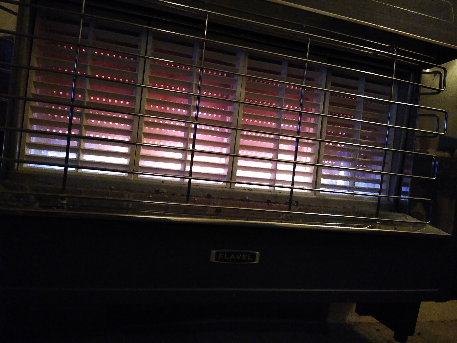

Flavel gas fire
Has less flame or heat than used to.
Picture isn't so good as it's showing heat light etc and looks ok. But its not.
Is like half of what it used to do. Used to glow hot. Now weak.
The bar on right above pilot light Is like it's quarter on.
Maybe needs clean. Maybe take out those white bars and brush. Any ideas?

Bloody good service and either the gas fitter uses compressed air or washers tge burner out.
Vacuuming the top of the burners is dumb and don't work ......tell him you want the burner washed out
