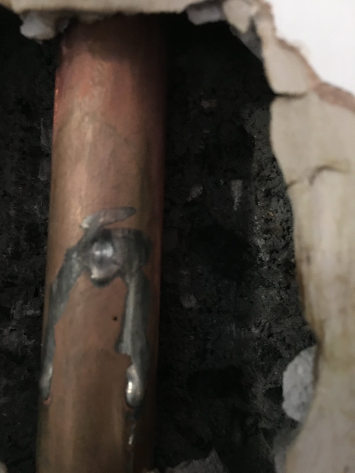

Today I managed to puncture a 22mm gas pipe, dead centre with a picture hook nail. Obviously therefore only a very small hole.
Having phoned the emergency number, and then got a registered gas safe engineer from their list of contacts, I'm rather surprised at the repair. This appears to be just soldered, no piece cut out, and as I haven't yet replaced the plasterboard, I want to confirm that this is a safe and acceptable repair.

No worries. Have managed to contact our usual heating engineer, who is coming round Tuesday am to do a proper job. Thing is one panics at the time and wants the repair done asap. Our normal Boiler Service engineer, actually knows the other guy, was at school with him, and can't believe the work done. Basically has even advised us to switch the gas off until Tuesday morning as he reckons it's dreadful. Only going to be around £60 for a proper job, which lets be honest the first guy should have done. Looks like four days of washing using the kettle, microwaved food, and the for show wall electric fire may actually get some use if it gets cold.

You should report that to Gas Safe, that's not on. Be a shame to leave it unreported then read in the paper that his work has killed someone. Needs pulling up before it's too late
Agree with the others , report it , if he believes that standard of work is acceptable he needs teaching before he does something more serious, I have seen that done a few times they call it solder patching, the solder could fall out at any time
Totally wrong way to repair copper pipe and needs doing correctly.....But...
It was common to wipe a patch on lead pipes years ago.
What makes you think it might "Fall off" ??
Phone your lead free solder welder operative and ask for a receipt for the works he carried out,saying its going through an insurance claim.
