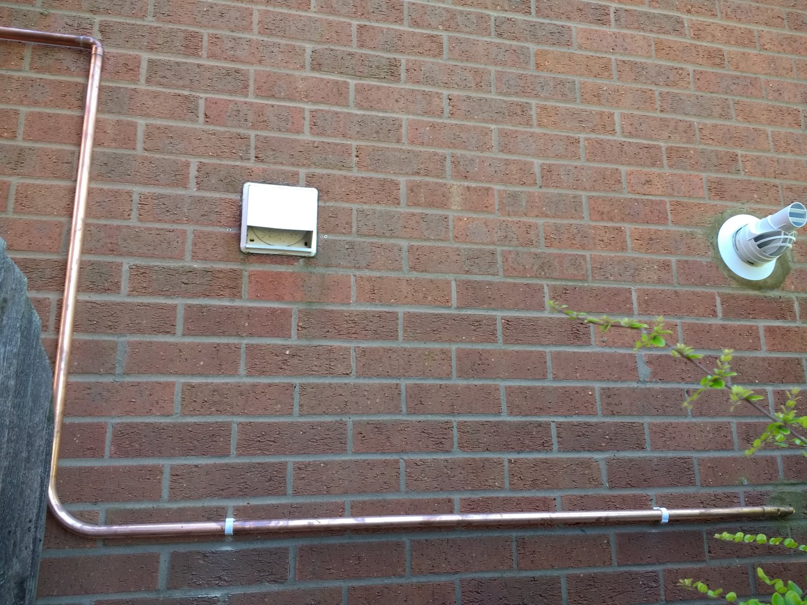

I have often wondered when I see external gas pipes unprotected.
I've also used those cheap round rubber door stops outside before.
I'm trying to work out if I've got grounds for getting the installer to come back.
In my opinion it does, but I have no experience in this area.

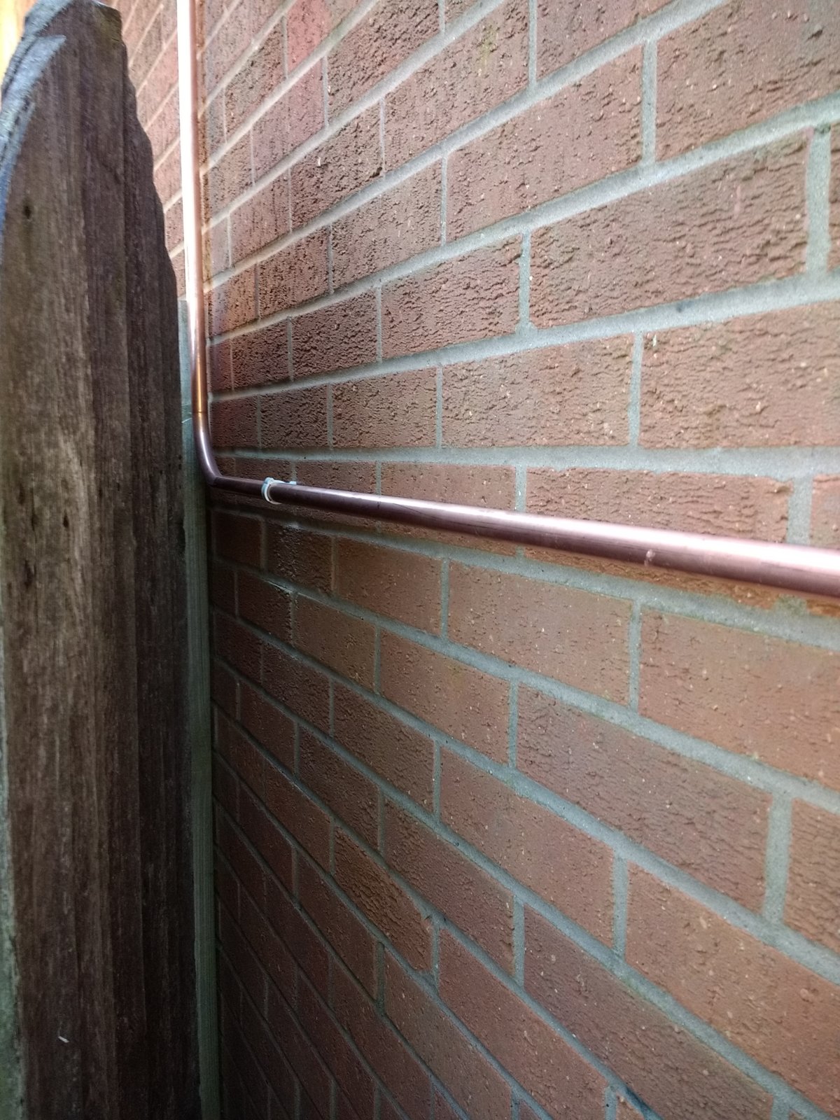

It's one thing to work around a gate if there was no other option.

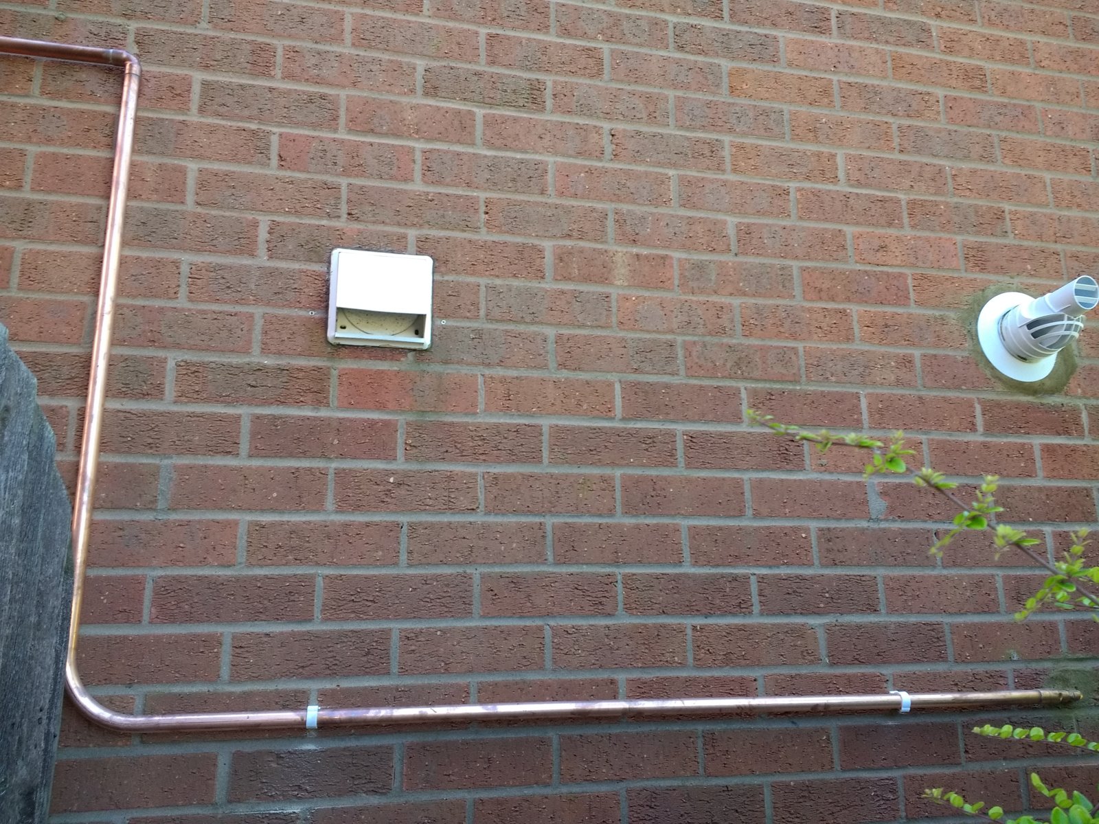

The change would be to carry on and come down in between the extractor fan and boiler flue.
Horizontal length of pipe here is 150cm.
If they'd run the gas pipe indoors and a door could bang into it this would never be accepted.
