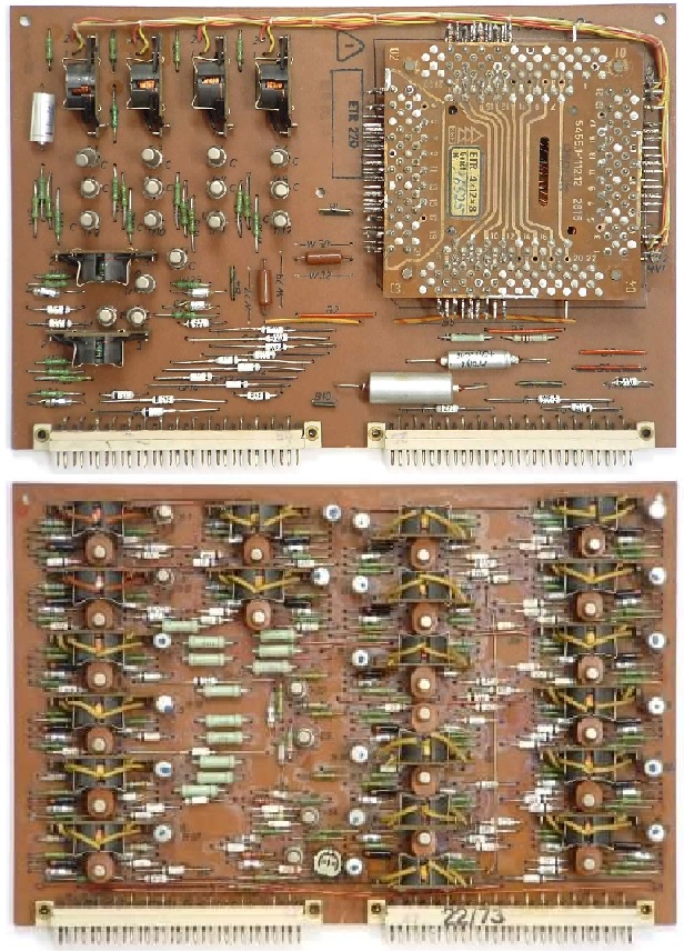

And before those days ( of the first computers ) the the effort and skill to design and build hardware was immense
These two boards form a 384 bit read/write memory for the Soemtron 220 series of desk calculators.
