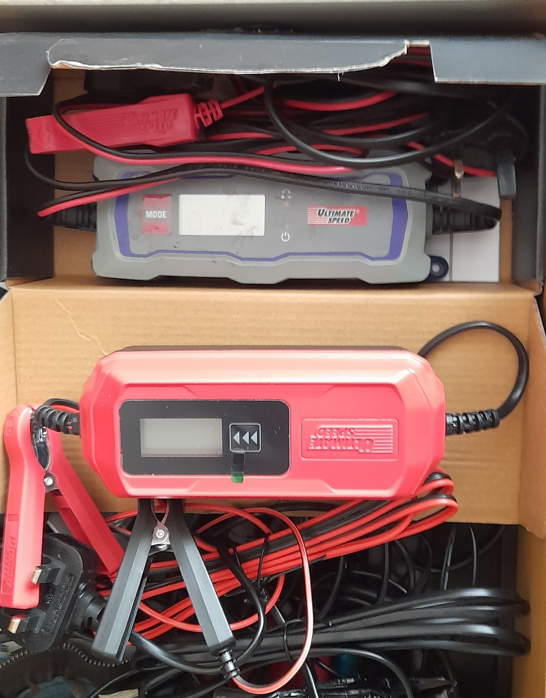

Battery chargers like these 1688713943264.png are so cheap at around £15 and charge at 3.8 or 5 amp using stage charging it is hardly worth using the 12 volt output from the generator. The problem is under around 7.5 volt they see the battery as 6 volt, so only way to charge a completely discharged battery is to connect it in parallel to a good one.

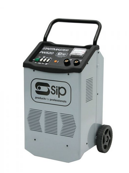

I use something like this 1688714370506.pngat work, but other than when used to jump start, within ¼ hour the charge rate has dropped to nearly the same as the cheap chargers, so in the main the cheap Lidi charger would do same job.

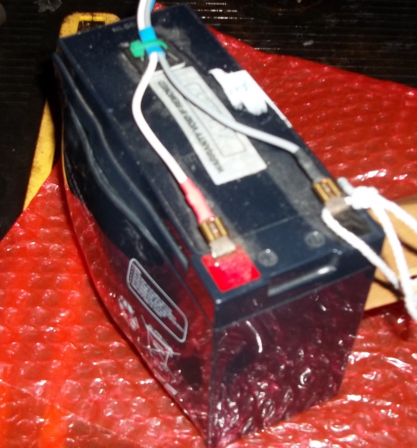

Had same with shorted cell, two batteries in series on charge, and one battery got a shorted cell and the other when as you show, and charger only 6 amp for two 35 Ah batteries.
I cannot recall the exact reason for this battery to become hot and swollen but it came close to spectacular self destruction.
Overcharging usually, I've pulled a number of 7aH lead acids out of battery UPS units over the years with a decent amount of swell on them, not as bad as that one admittedly.
