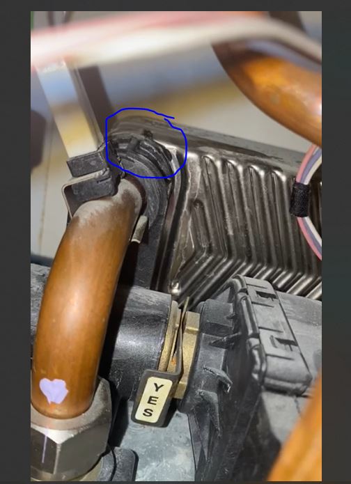

Hello,
been a few years since I had to ask for advice here, I noticed water dripping from my boiler today, called a Plumber out and hes identified the heat exchanger leaking, photo attached (not able to attach a video), he also noticed the pressure is dropping.
https://www.wolseley.co.uk/product/glow-worm-0020097179-heat-exchanger/ - Is this the kind of price the part will cost?
In the photo there is a black coloured plastic area where the pipe goes into, I imagine this part will need changing as well, even if its a precaution, what is this part called?
To change both parts, how many hours work should this be?
Thank you.
you will get a brand new set on ebay for around £30 make sure you order the complete HEX with seals, you can just buy the seals but come in packs of 10, it is just a seal that has failed.
