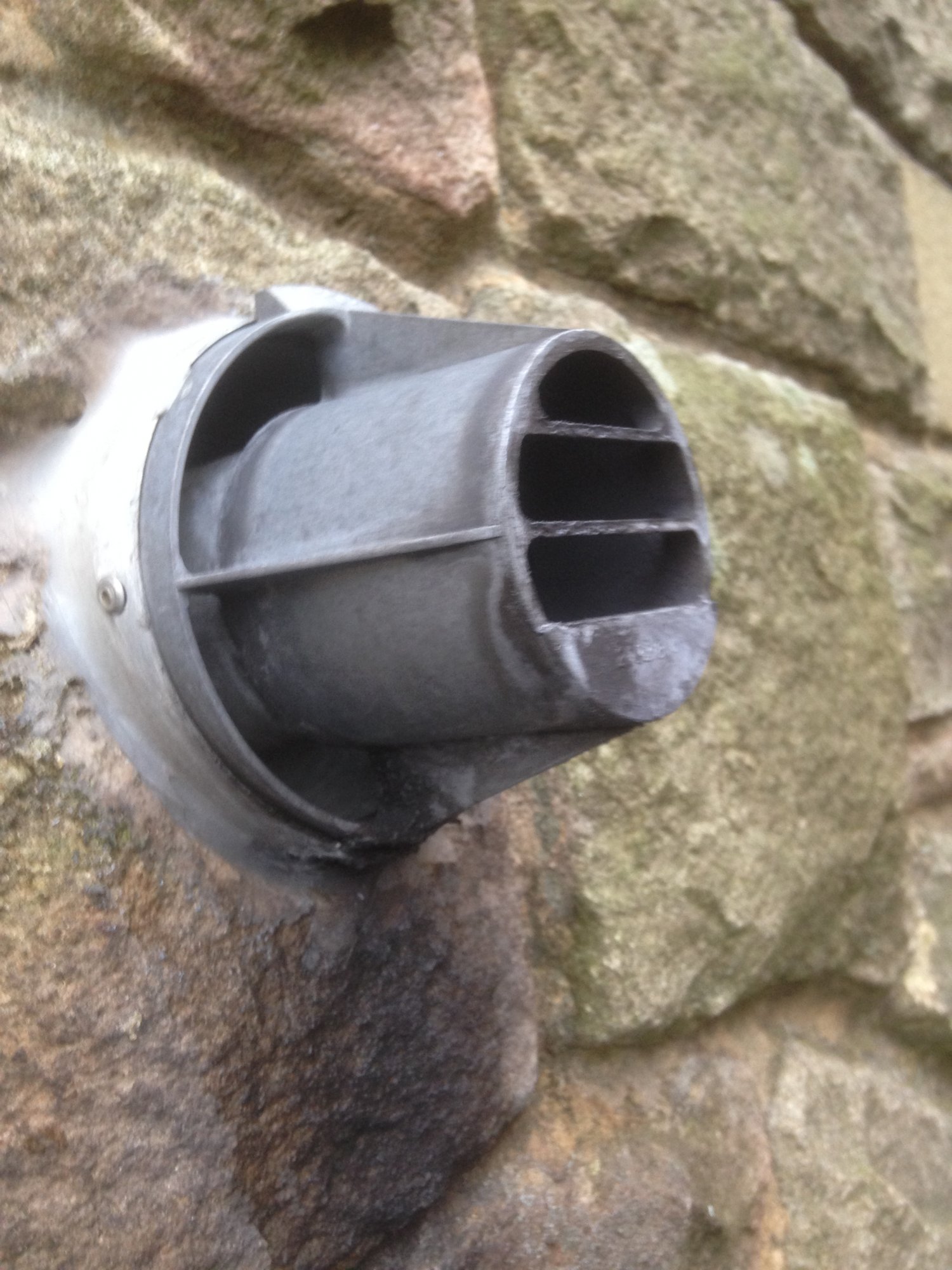

Glow Worm Energysaver flue terminal
No cover missing, lower bar outlet should be open. If it's an Energysaver than expect the leaks to from the boiler itself.
Looks like it's been fitted upside down - you must have a Gas Safe engineer to alter it .
Thanks for the replies I agree it looks like it's upside down however I've looked at it and it is marked "top" at the top!?!
