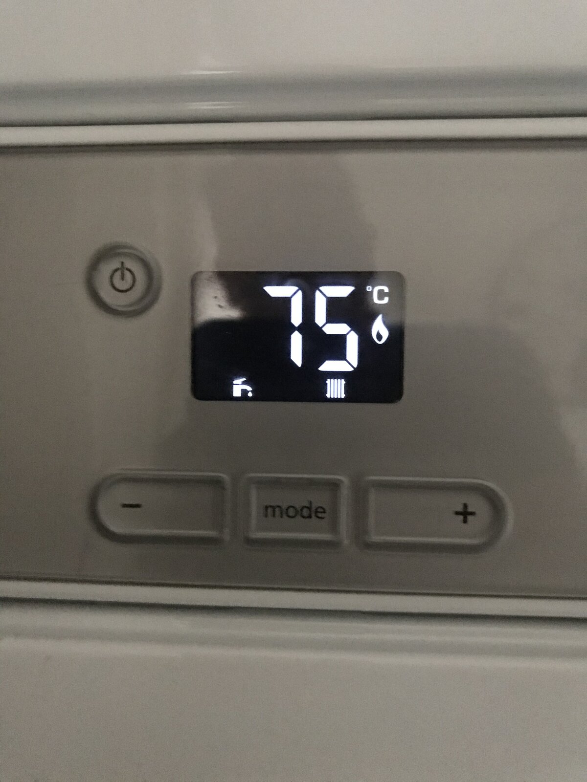

See photo. Radiator symbol constantly flashing and radiators always on
Have hive which shows hot water and radiator off. Only way to turn radiators off is to switch power off to the boiler.
Tried restarting boiler then it just settles back to same display and radiators hot
Was wondering if it was the trivalve problem. Had that in past and changed it but this time don’t even have control of temp to be able to switch off the burners
Check that the low voltage link on the pcb has been removed, if it has then probably a sticking micro switch on a motorised valve

The Hive transmitter is the thermostat, the receiver is the part wired to the zone valves, you dont have an ethenet cable connected to the hive thermostat

The receiver does not connect to the boiler it connects to the mid position valve, what you call a Tri-valve, the mid position valve connects to the boiler and tells it when to come on, nothing on any part of the Hive connects to the boiler, they may share a L&N supply but nothing else, the hive doesnt directly control the boiler

What everyone is trying to say is that your problem is with the 3 way valve not doing what it should. If the Hive is not demanding heat, then the boiler is being fed by the 3 way valve which is stuck in the heating position, or the end switch in the valve is stuck. My best guess, if the light is flashing but your radiators are not hot is the latter. If the rads are getting hot, then the valve is stuck, probably with a seized synchron motor.
