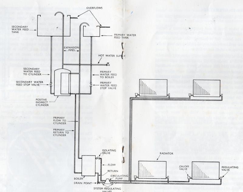

I have an old oil boiler installed 45 years ago with two pipes going to the hot water cylinder. The other two pipes going to the radiators fed by a pump which is situated next to the boiler.
I have had four quotes to in stall a Worcester Danesmore 18/25 external oil boiler. Two claim that the new pump and zone valve can be fitted just inside the house where the new boiler pipes will come through.
The other two claim that there will have to be a new pipe installed from the loft area down through the house to the new boiler, this clearly will involve decorating costs. Who is correct?
Hope someone can help.
I am guessing but its just that a simple guess as you havent provided enough information, that you have a shared return for the HW and CH circuits in which case yes you would need another return pipe to achieve fully pumped individual control of both circuits, the fact that two companies have both mentioned that this is required would make me think that it probably is

Just put more info on, this may help.
Just put more info on this may clarify situation.
That's just a standard set up. The instructions say the feed and expansion pipework should be connected at the boiler, so fitting a new feed to the boiler, from the f&e cistern, could be the right approach.
That diagram dosent help much, it's not specific to your installation as is. Could be the vent pipe isn't piped correctly but only 2 spotted it.

My present system has two independent circuits one for the hot water cylinder and the other for the central heating, so there are four pipes coming out of the existing boiler, in the loft there are two tanks and the hot water cylinder.
