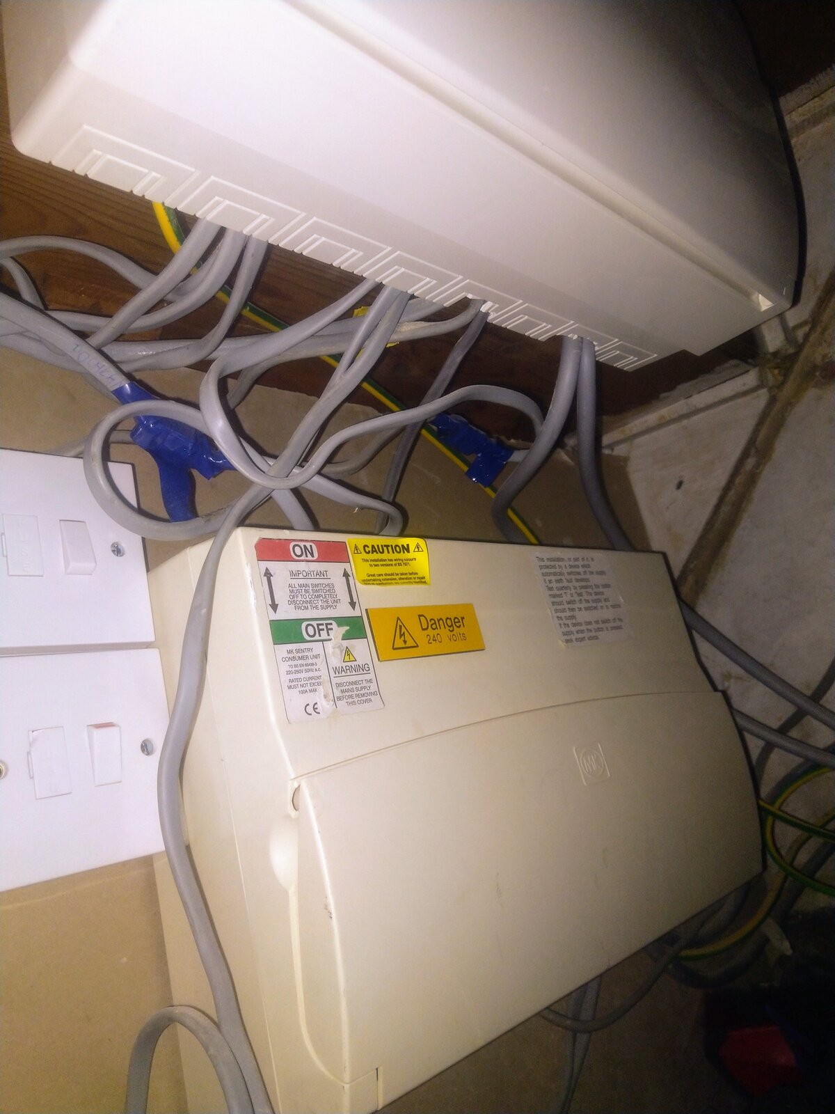

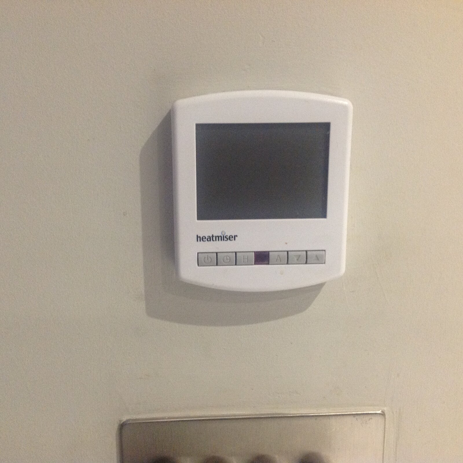

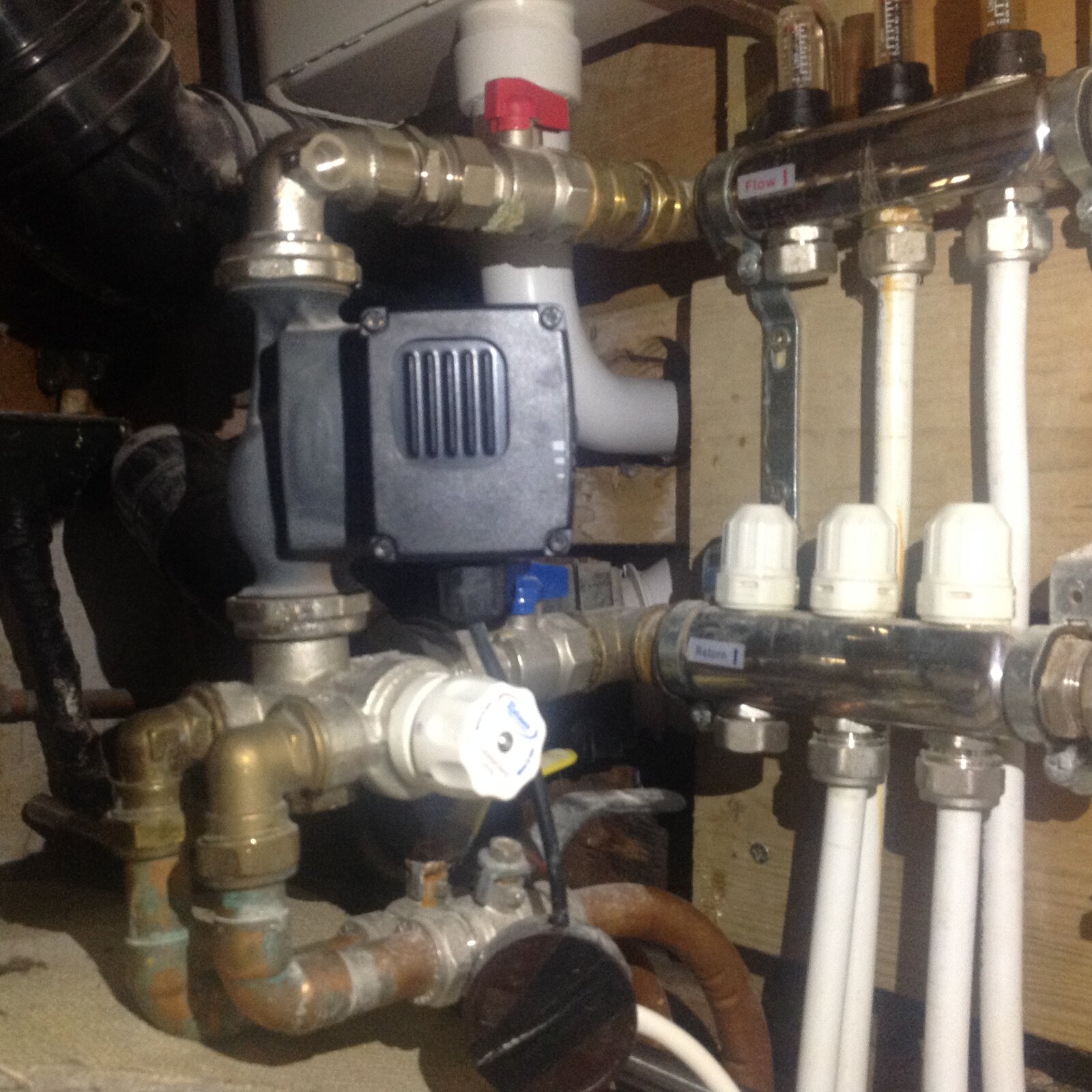

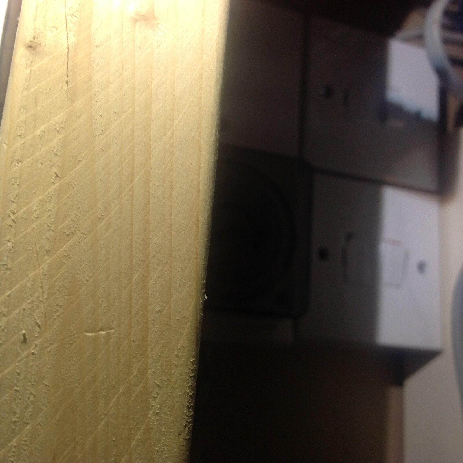

Whatever is controlling your ufh is causing the problem, the pump running and boiler on is just a symptom, can you post a pic of the ufh controller box ?
Hi I have looked where the UFH manifold is placed and I can't find any controller box also looked upstairs where the boiler is and nothing there. This is the picture where UFH is stored and plug socket for the pump. The system was already installed when we moved in 2 years ago and never had a problem with it and was only serviced 5 months ago.

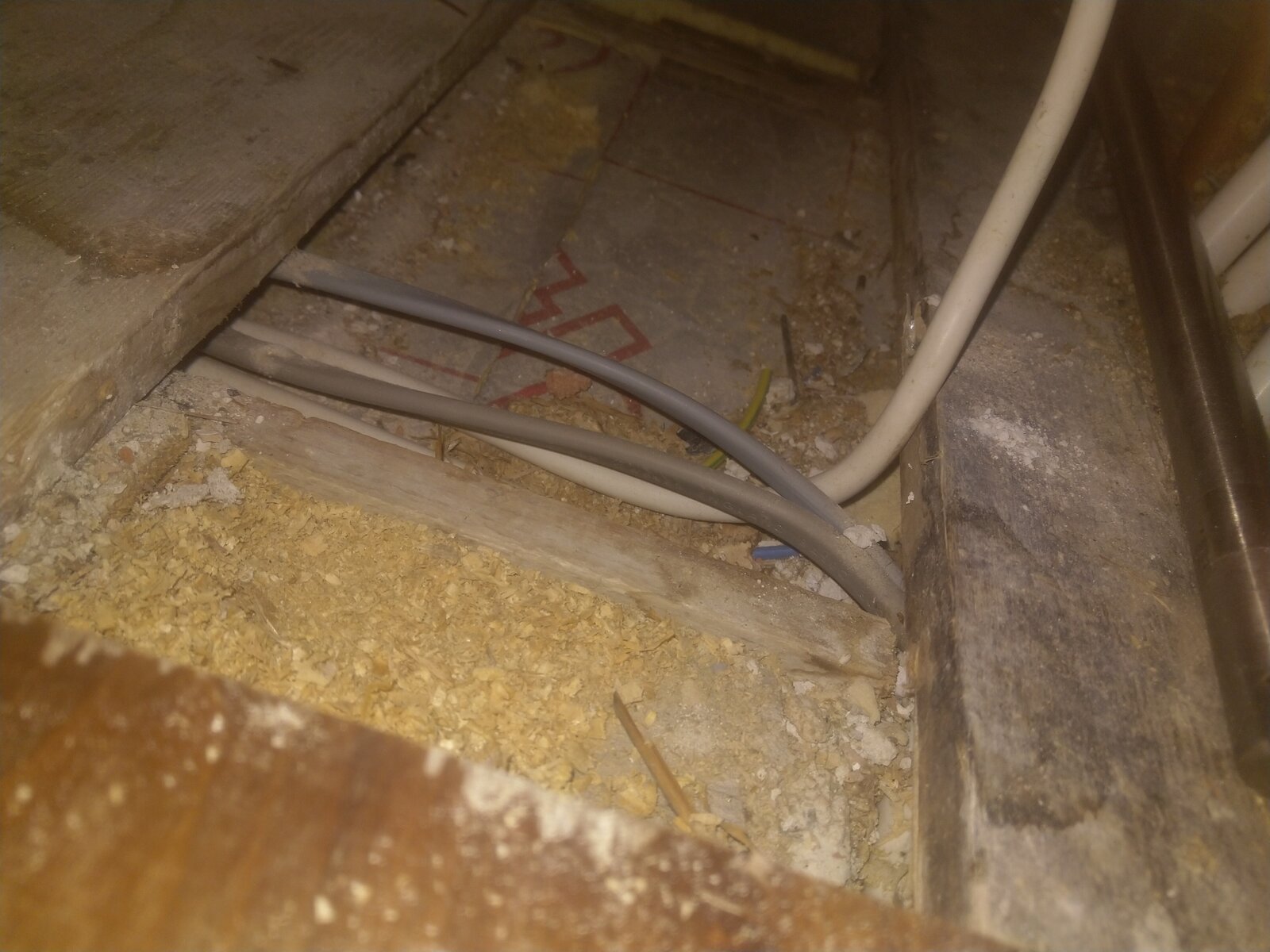

There must be a connection between the ufh and the boiler , any other controls/valves/plastic boxes anywhere?
It’s getting a switched live by the sounds of it. Something must be causing it. As per picssso, anything else controlling it?
I can find anything looked upstairs next to the boiler and in the cupboard behind the boiler. Checked where the fuse boxes are and nothing. Ive noticed when you switch the pump off from the mains and thermostat also turns off.
Only fuse boxes and plug socket for pump.
Other pic is wire from the pump going to plug socket.
Thanks for your help

sorry the pump is connected to the wall socket the one in the picture that is in the off position.
There’s a switched fused connection outlet next to the consumer unit (fuse box) what’s that for?
Yeh Im not sure but going to open it up and see what wires are in there.

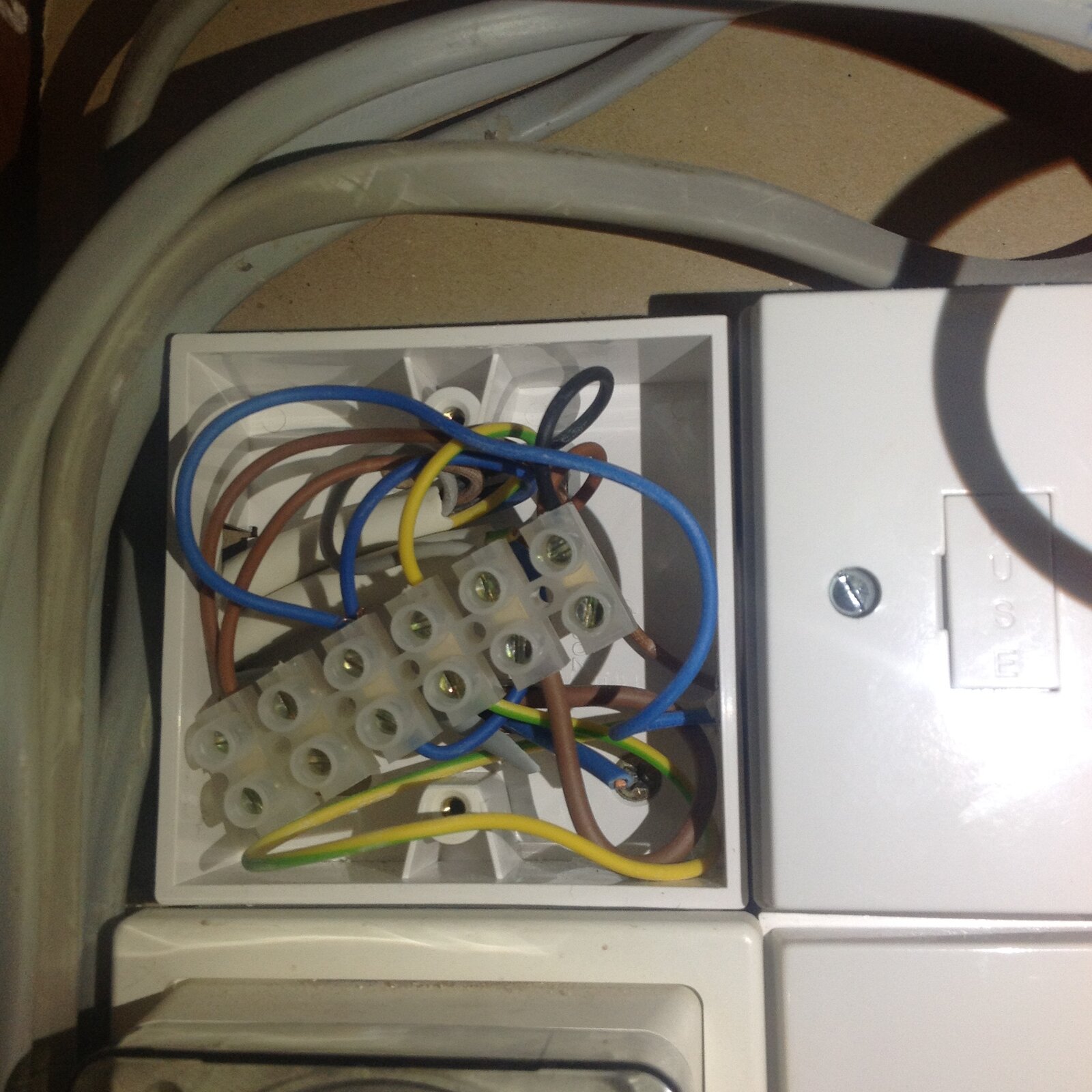

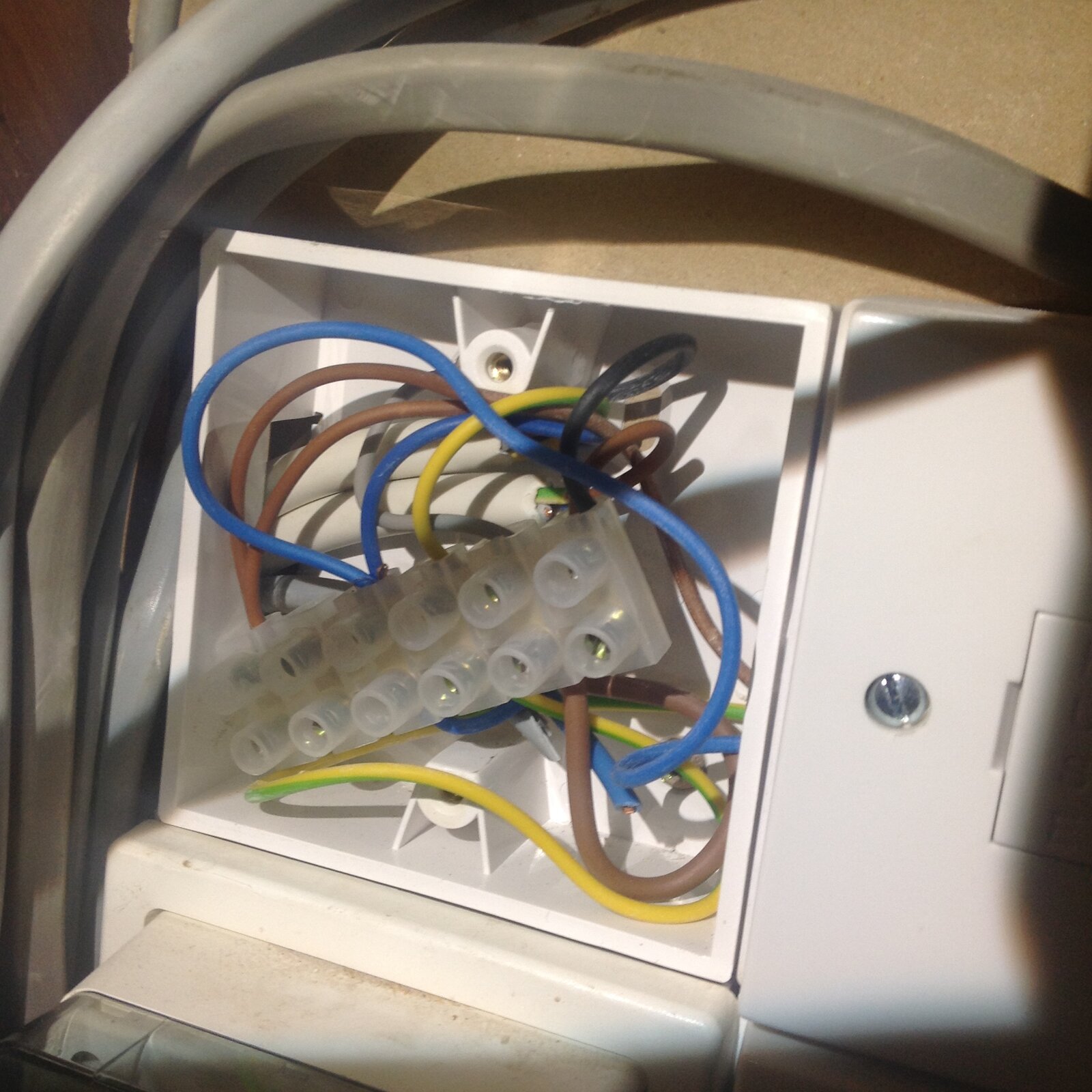

Sorry guys what a plonker I might b? I found the control box next to the pump wall socket. It was inside the blank socket to the left.
The pump switched wall socket has got 3 wires going into the control box.
Hi guys I woke up today to find the UFH pump and thermostat to be working correctly. I know there is an intermittant fault somewhere because thinking back I had the same issue with the pump not switching off and calling for the boiler central heating to stay on months ago but I didnt realise. So I guess it will run fine for a while then I will be back to square one. :cry:
