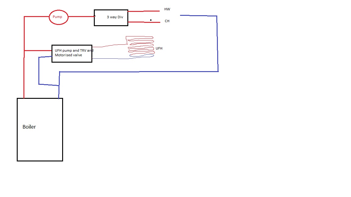

Hello,
I have a standard Y plan CH system with divertor valve for CH or HW or both etc. I have installed UFH downstairs and this currently has seprate 2 way motorised valve, pump and TRV. It is plumbed into the boiler downstairs and comes on when CH heating is called for, so all rads and UFH heating come on as one zone.
If I were to add a 'UFH room thermostat' to control the on/off of the underfloor heating could I in theroy call for CH at main timer, switch off rads by lowering radiator room thermostat, and switch on UFH pump etc by calling for heat from 'UFH room thermostat' ?
My worry would be that the UFH heating pump etc is behind the main CH pump when you would normally place all the zone valves after the main pump etc..... see pic of my current layout.

Major Ball Supp... S plan on three circuits required. UFH takes ages to warm up and ages to cool down so should come on independently of the main heating circuit.
OK so I wouldn't exactly say major ball sup or diy cock up as the Y plan was already in place. I can change to S plan if required. I was asking if the independent thermostat control would work so I didn't have to do that??
What you have installed will never work properly. Neither will just adding a thermostat.

Let's hope this 'proper forum' will advise the use of relays when using multiple circulators (pumps).:)
