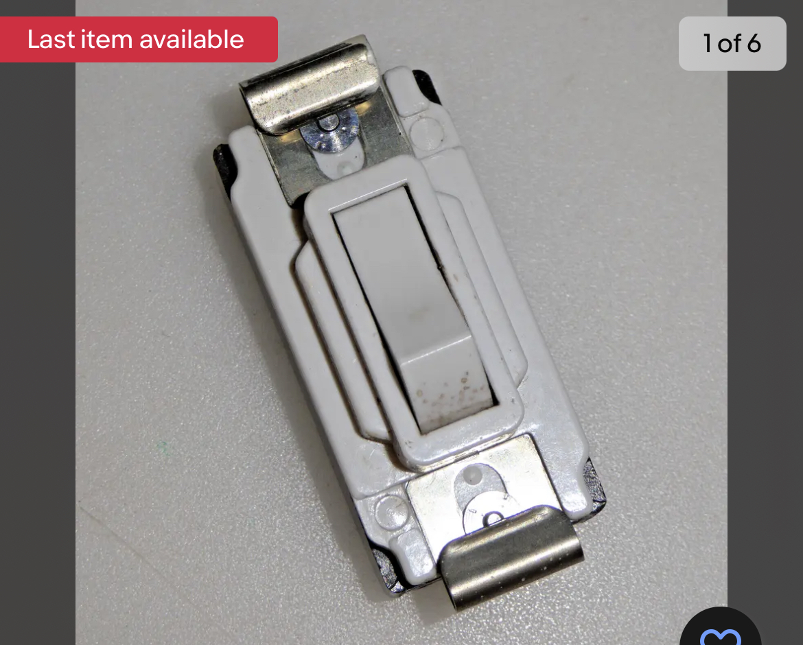

The installation is in a bowling clubhouse. The installation is original fit from the mid 1970s and is T&E buried in the fabric of the building. The room which has the issue has 3no. 100W 8ft fluorescent tubes on the ceiling and is controlled by a single one way MK grid switch.

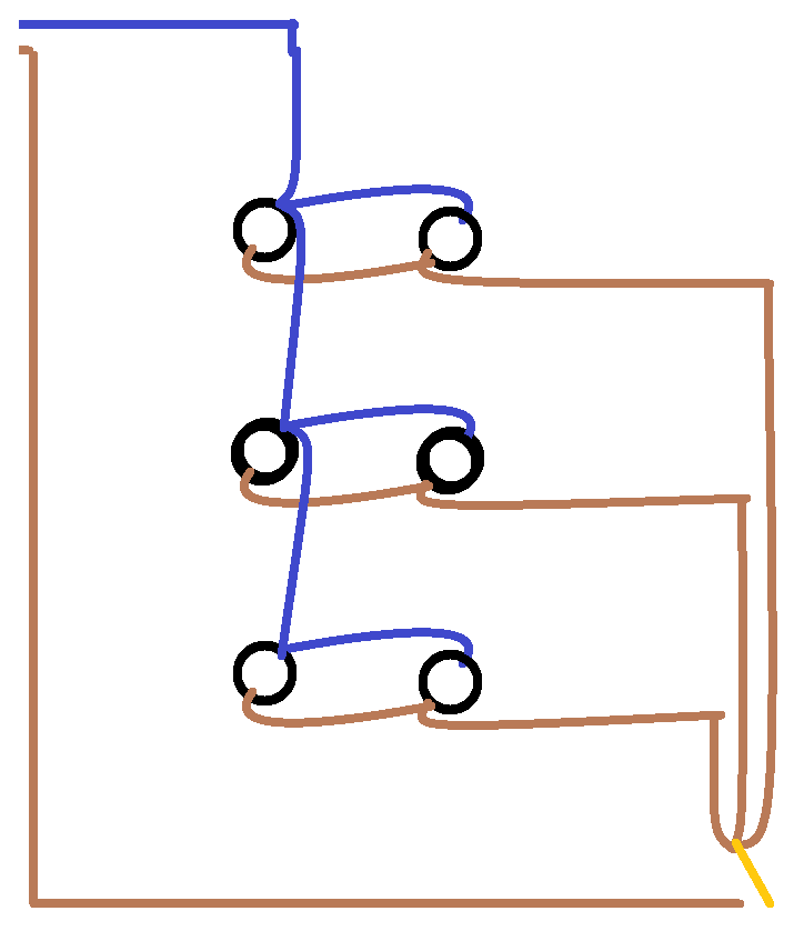

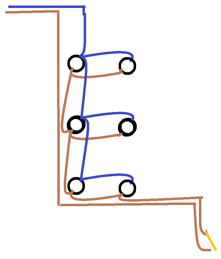

Had same thing when changing from twin RCD to RCBO, wired in tube and singles in this basic arrangement, it was something like 5 rows of 4 70W discharge lamps at about 20ft and neutrals at that high level, dropping down to the DB in the adjacent space. the live wiring in trunking round the walls at about 8ft with other circuits. The live drops were one single in tube. All wiring being 7/0.029" the MCB being C25 and electrical tests were perfect.
never did suss out the actual mechanics of the problem but rewiring sorted the problem
It was one of those 'why on earth did they ever run all the way round the trunking when they were running into the tube fitted for the purpose' situations.
Not only that but due to the time and access equipment restrictions we even reused the existing wire with one joint.

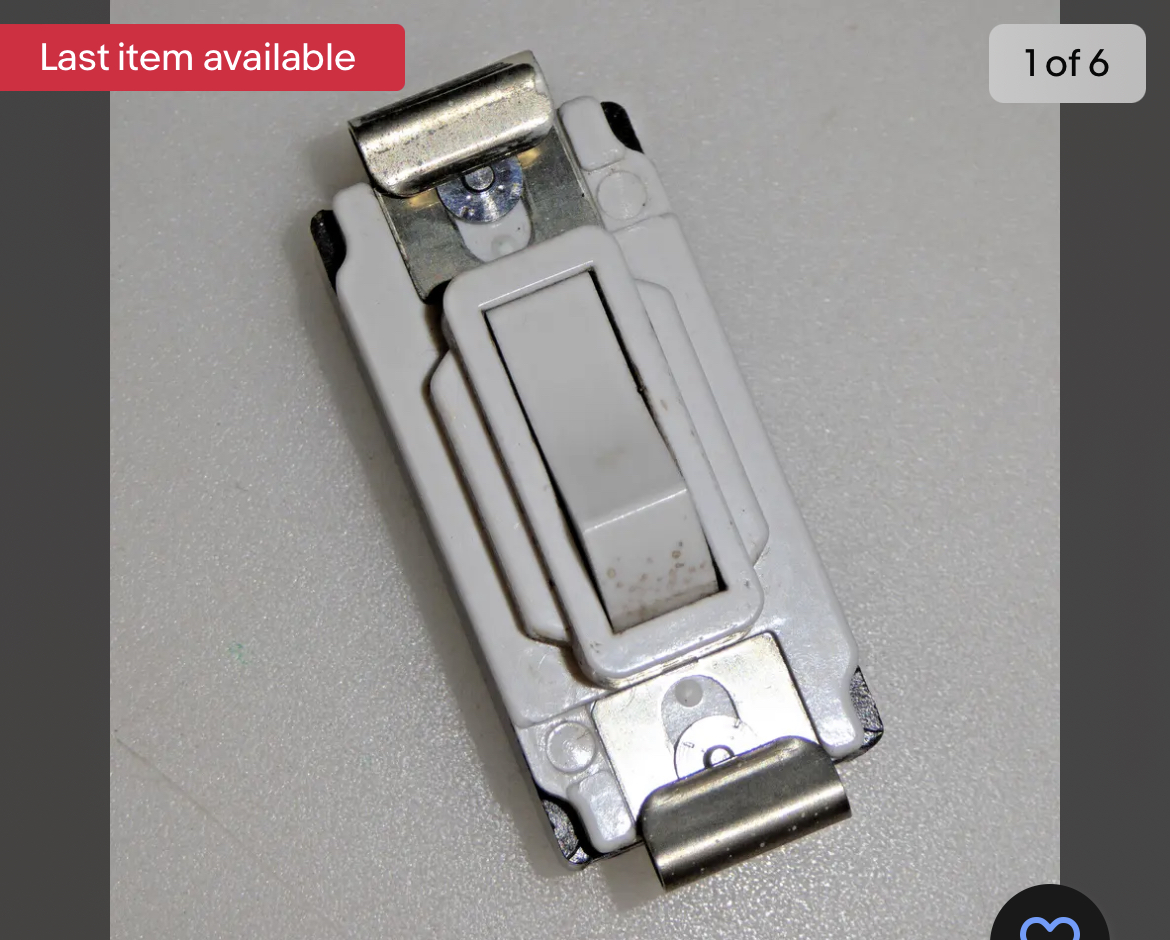

Yes an arching switch is a known problem for this.
I did wonder about the switch but it feels ok and I can’t hear any arcing. Even when I jabbed the switch so it opened quickly it still tripped. If the weather stays poor I’m going to go and have a look tomorrow.
