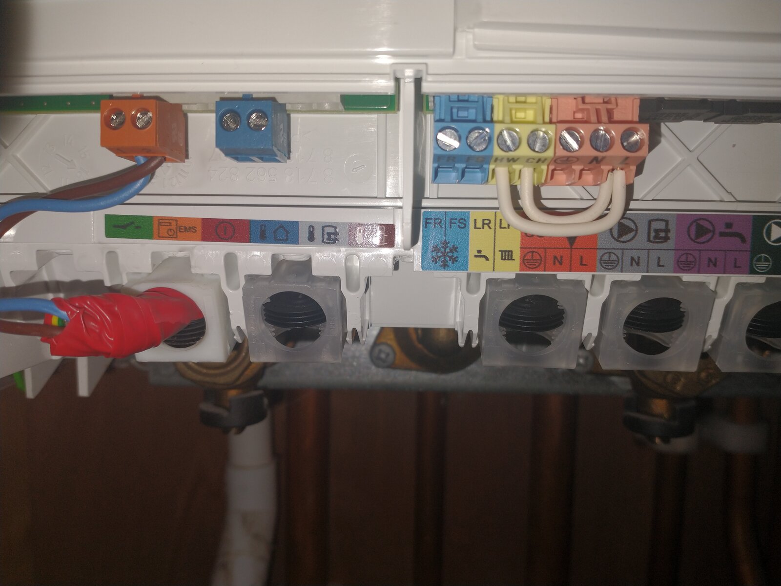

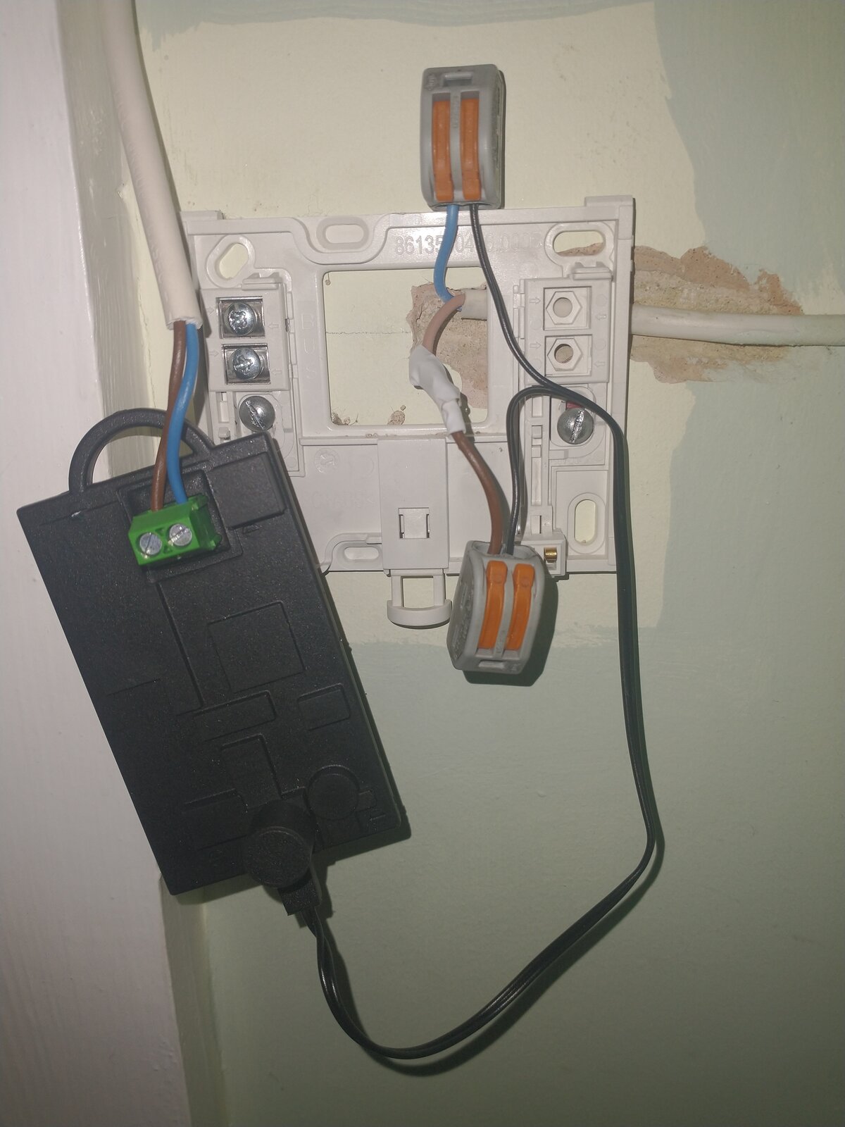

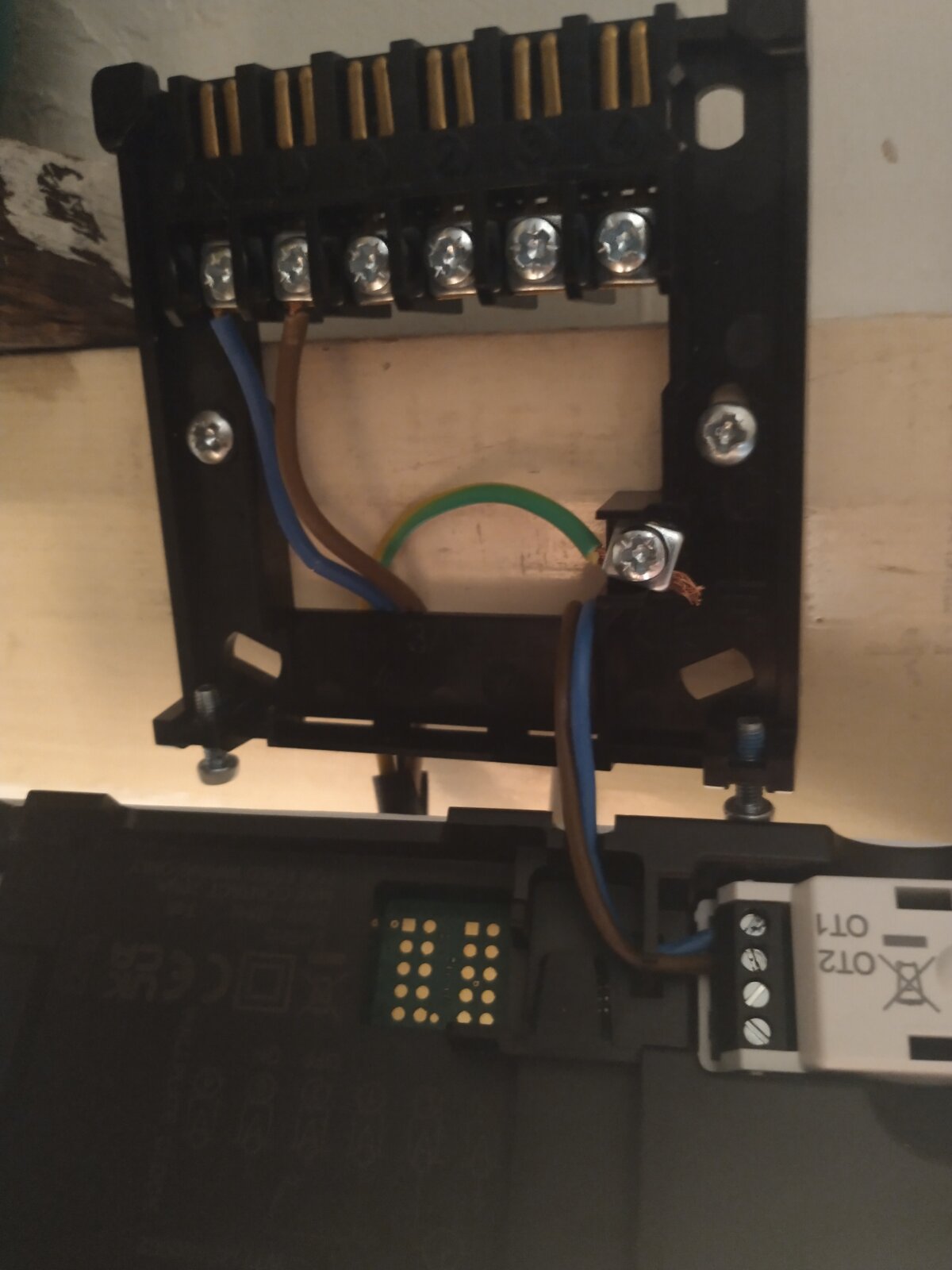

I have the same boiler with the Nefit converter and Drayton Wiser Hub and it is not working as expected.
I thought the boiler would be off until a schedule starts or a lower thermostat threshold is breached. However, the boiler appears to constantly cycle on and off to maintain the temperature the boiler set at (currently Eco mode 61 degrees centigrade. I think this is equivalent to constantly on.
My initial thought was a loose connection, but it all looks fine. I can see pulsing 12v coming out of the Nefit converter and solid 12v going in. The Hub is powered up and all the Smart TRVs are working fine. I previously had a Worcester Wave Thermostat which the Nefit converter has replaced.
I obviously done something wrong, but it is such a simple setup I can't work out where. Any ideas?
Hmm. Do you have the 30i or the OP's 34CDi?
Did you add a short link between Live Out and Live Return (for CH) - or alternatively have you tied the relay wires that were going to the thermostat together (should be equivalent)? I think shorted Opentherm wires would also be equivalent to constant demand, so check for that too.
Might be worth posting a picture of your wiring - both the live side and the EMS connector.
I have the Worcester Bosch Greenstar 30Si Compact ErP boiler.
I haven't touched any wiring on the boiler and was hoping not to!

Different boiler to me, but looks wired correctly (makes sense if it was previously on EMS). I can't see anything wrong with what you've done and I'd expect that to work based on my experience with this adapter unless there's a sneaky short circuit.
I initially set mine up for relay control and then Wiser switched to Opentherm mode automatically when I wired that adapter up. It was easy to tell that it was working as it would use low temperature water or just run the pump when there was only a small temperature difference to the set point. The newly updated app doesn't actually show me the operating mode - I assume they broke something. It might possibly be worth running through setup again - hopefully there will be a screen where it shows Opentherm being selected?
