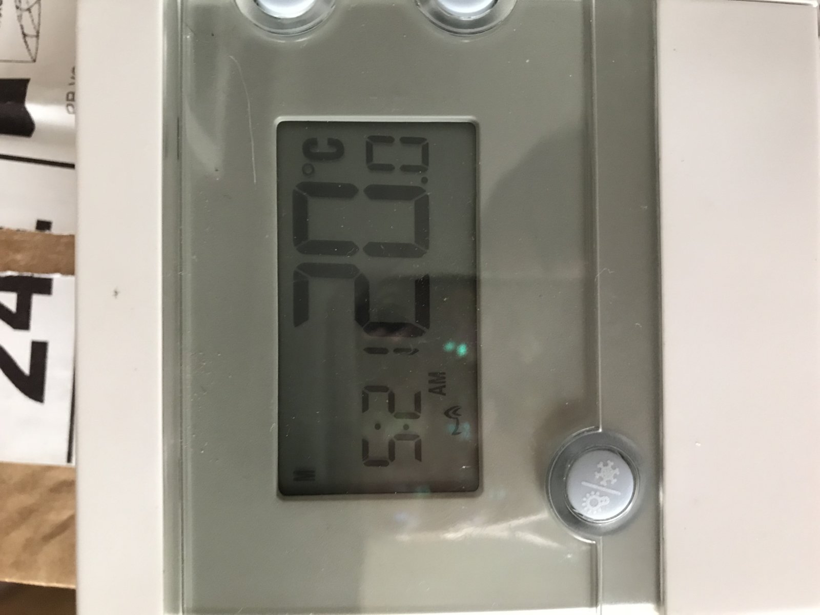

So I have a main 30 eco Combi boiler fitted with a salus RT500BC.
So the hot water works fine - ignition light comes on
I’ve bled the radiators
Reset the thermostat and re synced it
Radiator light is on when it should be but the ignition light stays on for about 1 minute before turning off
No heat at all from any radiator

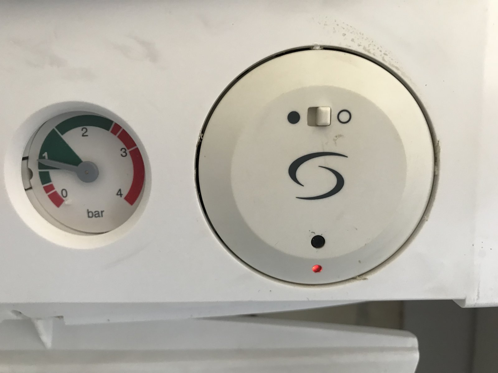

I guess that you topped the system up after bleeding the rads?
No I didn’t top up the system, how do I do that??!! Never had to touch my boiler before!!

What does the gauge read on the front of the boiler and are both the dials turned fully to the right?
Yes I’ve turned them right up to the max
What I don’t understand is the fact the water and ignition is perfectly fine but the radiators aren’t?? I thought an ignition was an ignition for both??!!
did you look at the gauge ? ignition
It is for both, something is stopping the central heating coming on, did you put new batteries in the stat?
Sorry where is the gauge?? I’m looking at the dials that control the heat is that right??
Yes I replaced the batteries twice in the thermostat and re synced it

put the heating on at your stat them post a pic of the front of the boiler panel with the flap down so we can see what is happening
Ok
