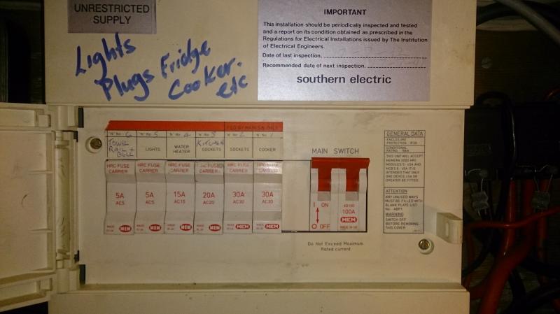

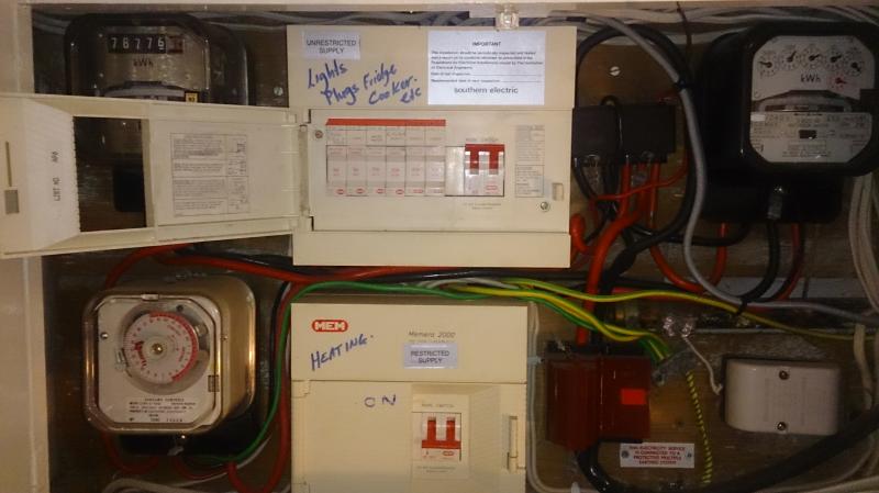

Hi would really appreciate some advice, this morning I woke up and no sockets were working, except for in the kitchen Wich are on a Seperate fuse. I assumed the fuse was the problem so I tested by by swapping the cooker fuse with the socket one as they both 30a and same result, cooker working but no sockets. Have unplugged absolutely everything and reset the main trip switch, I don't know what else there is to try, I assumed it would have a reset button or something but its an old board with a few rows of fuses and only 1 main trip switch. Really can't before to get a sparky out at moment, any ideas? Thanks

The problem clearly isn't with the fuses, then, which presumably means that something must have happened to the wiring. Unfortunately, I fear that you're probably going to need an electrician.

Yes, I agree that it is pretty odd for it to suddenly happen, overnight. There shouldn't really be any other 'components' - basically just cables from the fuse box to the sockets - so something presumably must have become disconnected or broken, but goodness knows how. Indeed, if your sockets are (as is commonly the case) arranged in a 'ring' circuit, then very few single faults would result in every socket losing power. I don't suppose that there are any furry animals with sharp teeth beneath your floorboards, are there? :) Maybe some other people will have some ideas!

Thanks very much for the advice! Sockets and kitchen sockets were indeed labelled the wrong way around! Thanks for your time guys very much appreciated. Would have been gutted to have paid for someone to come and tell me that! Great idea would never have thought of that, cheers

Glad to hear that - but before you get too excited, if you're saying that the fuse supplying the sockets had blown, then there is the outstanding question as to why it blew in the first place, seemingly 'spontaneous;y' in the middle of the night. There may therefore still be something not quite right somewhere (aka it might happen again unless you can find, and rectify, the cause).

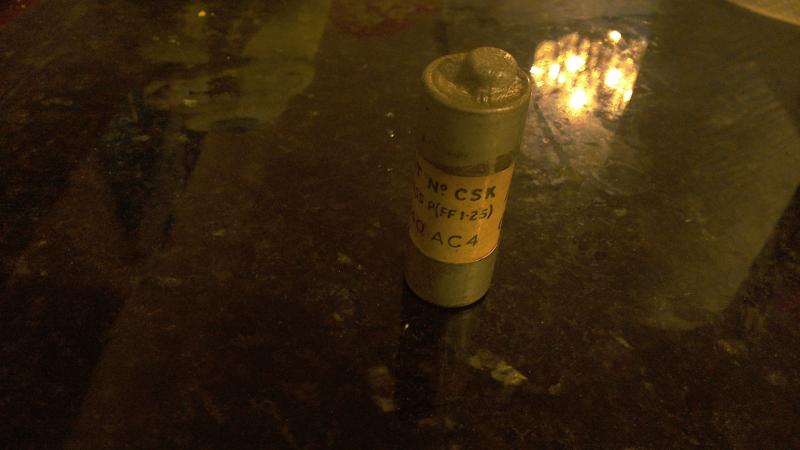

John, If it was the circuit labeled kitchen then it was a 20A circuit that failed.

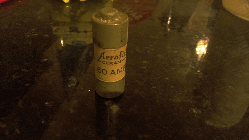

Years ago our main fuse (60/80A can't remember) blew one evening with nothing except the TV and a few lights on. The DNO guy replaced the old and distressed looking fuse (I kept it as a souvenir and if I can find it, I'll take a photo). He told us it wasn't unknown for it to blow given it's age and to not to worry unless it happened again (which it didn't).
Out of curiosity, I've never seen one of those old MEM boards before. Are they fuse carriers or do they have fuse wire inside like the older Wylex boards. I guess fuse carriers as I've never seen fuse wire for sale in the usual outlets other than the triple 5A/15A/30A packs.
The clue is in what is written on them ("HRC Fuse Carrier") :)

I agree. When our main fuse blew I was fearing the worst. We had only been in the house a year or so and were still uncovering the previous owners DIY attempts. This was over 10 years ago now and I'm in danger of taking this off topic, so:
Our old fuse which blew for no reason one night:
