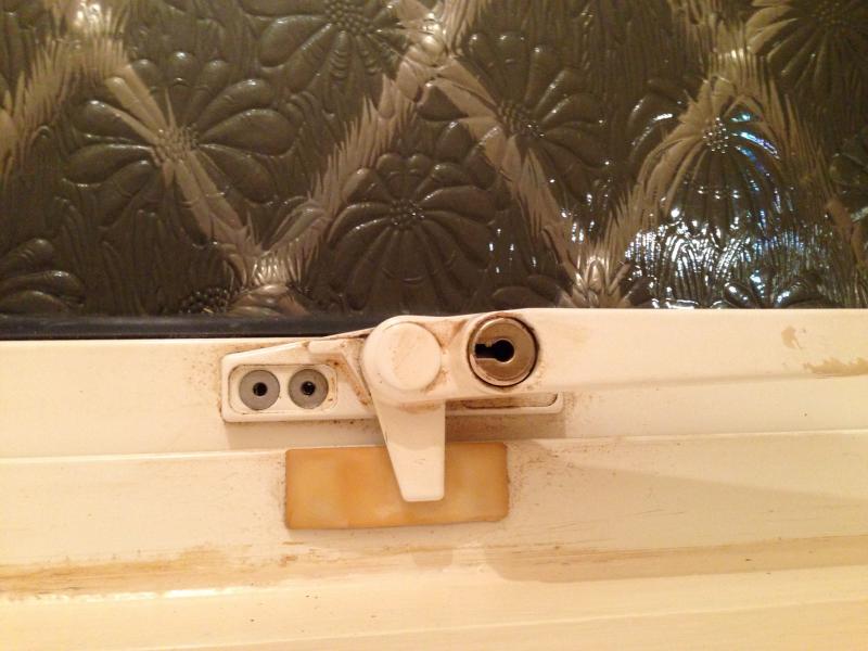

I am currently changing the window handles on a lot of the windows in my house. There’s no internal mechanism, just cockspur handles lodging against the back of a wedge. The first set have been no problem at all: tiny Phillips head screws that I’ve just taken out and put back in with the new handle:
Picture 1:

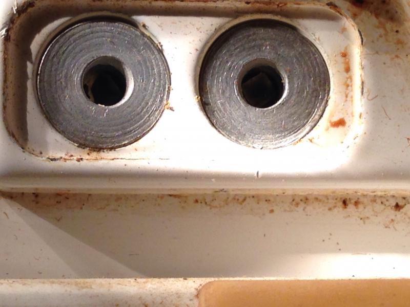

However, I’ve come across a batch with a screw I cannot seem to get out no matter what I try. I’ve asked at hardware stores and locksmiths, and ideas have ranged from them needing allen or star keys (haven’t worked), to someone suggesting I’ll need to do a tap and die to get the screw out (seems a bit over the top).

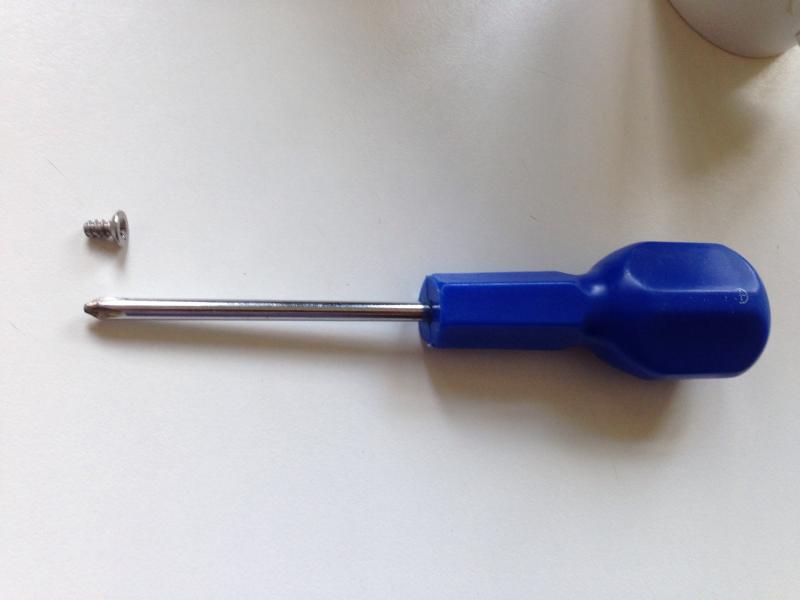

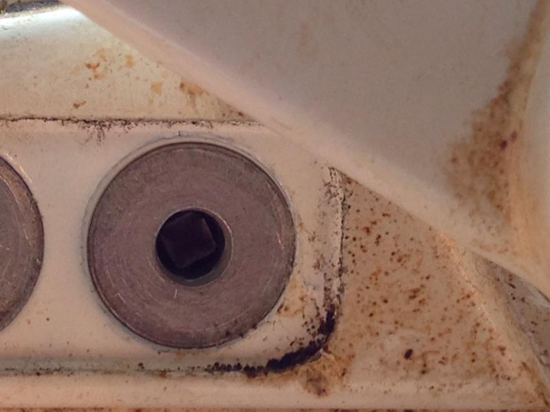

I’ve attached a picture of the handle here (Picture 2), and a more close-up shot that tries to show what it looks like inside (Pictures 3 and 4). I did try to unlock it with a square-shaped screwdriver bit last night. It was the closet I got to getting anywhere: the piece fit, but it didn’t work in the end.
Picture 2:
Picture 3:
Picture 4:

Does look like square drive bit is required [there are two sizes maybe you had wrong one] or they are riveted on and require drilling off.
Its a pop rivet, the flush fitting type not the normal domed head type, i'm sure theres a proper term for them but if you google image flush headed pop rivet you see how they work, they're kind of countersunk
That was my first thought crank39 but in the last pic there seems to be a square recess at the bottom.
Know what you mean but i'm pretty sure its a pop rivet, can't be anything much longer as the glass is right there, bet the screws only 1cm long
Thats another thing, be careful drilling otherwise i can see you needing a new DGU
