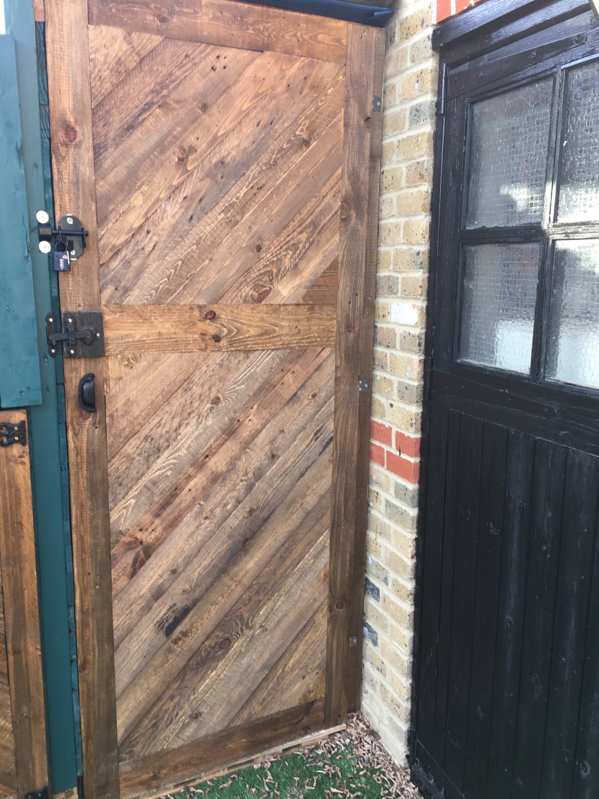

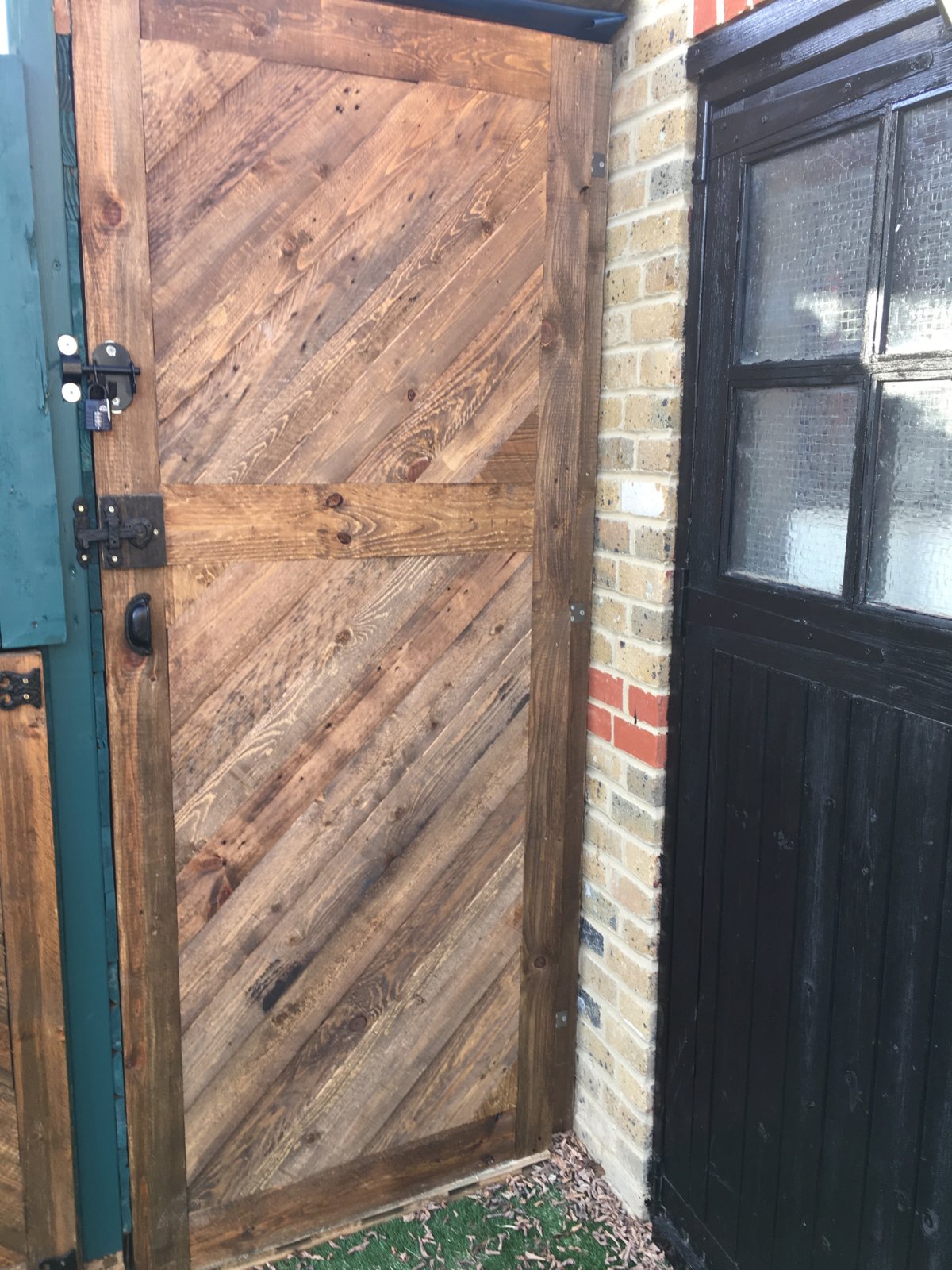

Needs ply 18mm minimum, you could put you fist thru 6mm mdf.
You could clad the face with free pallet timber which makes it look more substantial.
Did this with an external cupboard.
I was mainly worried about weight on the hinges. I have 2 hinges (not sure what they are called but they are basically a triangle that extends about 6 inches, and a small plate that fixes to the frame and is attached by 3 approx 20mm screws)
If I’m putting this much weight on it I’ll have to get another or some bigger hinges. The hatch frame to be screwed into the opening with concrete screws is only 2’ by 2’, I hope it’s strong enough!
this is the smaller of the hatches and it’s purely for junk. The other cavity I’ll put more valuable stuff there so was going to make a Z door from 2b6 and use some bigger timber for the frame.
I’m just a bit confused on how big the hinges need to be
Very little weight , mine was fixed with 2x2 inch hinges , with pallet timber on ply you get more like 30mm to screw too.
that’s a lovely job mate.
surely to get the ply in the rails you need a bench saw to cut the grooves? I’m working on a kitchen table with hand tools mainly....I was going to try a frame with ply insert but can’t see how I can get the ply to fit inside easily without some better tools
It’s that easy , screw thru ply to rear of pallet timber .
