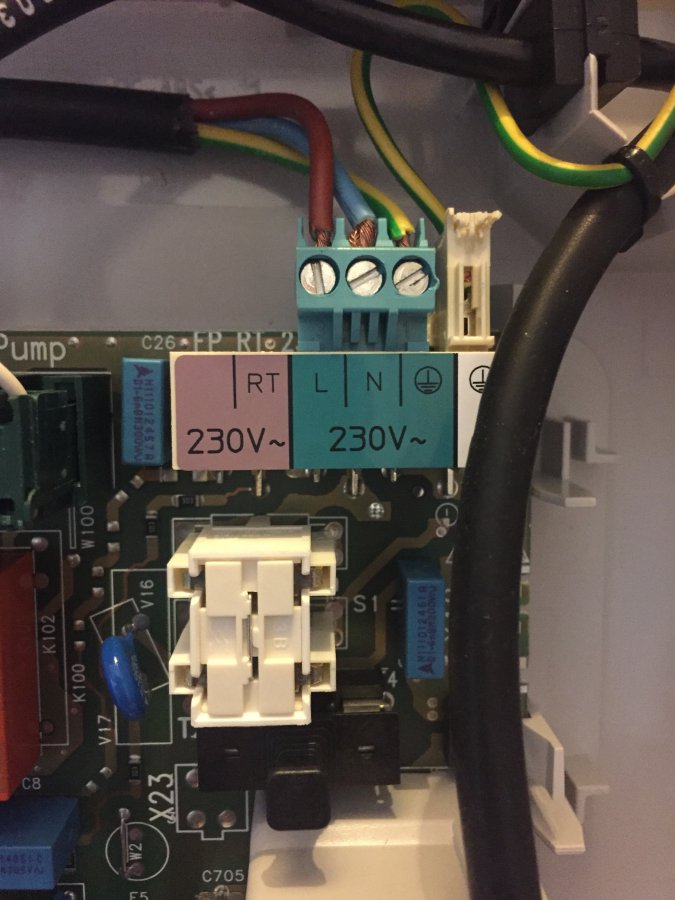

I removed the link (loop) on the RT 230V connector. I remove the connections from the eBUS terminals inside the boiler and connect them to the RT 230V connectors.

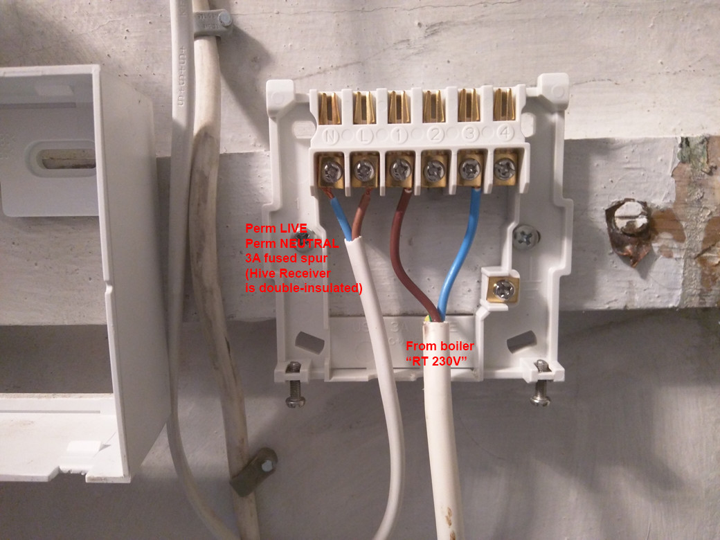

At the other end, I connect to terminals 1 and 3 on the Hive backplate. There is no obvious indication of polarity for these connections at the boiler side (see attached images)
I provide a fused 3A spur to the Hive receiver from the same power that is providing the boiler. I have not looped from the boiler to the Hive receiver since the terminals are far too small.

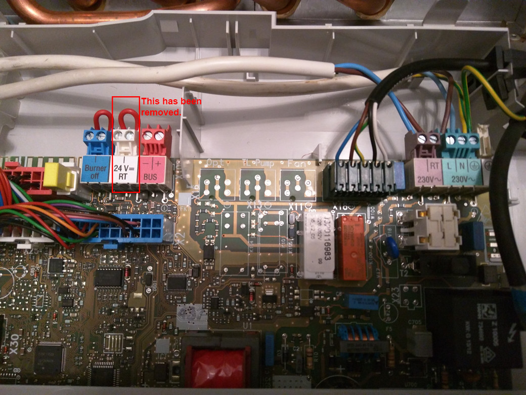

I close all cases etc. and fire up the boiler. It promptly comes on and stays on constant.
A quick read of the manual (page 30) states "If you connect a 230V AC time and temperature control to the boiler, then remove the bridge at input 24V = RT."
I re-open the boiler, remove the bridge, close it up and start the boiler and receiver back up again.
The boiler boots and stays off this time. I manually call for heat, I hear the relay switch and, the boiler does nothing.
There are no fault codes showing on the LCD display and as far as I can tell, the receiver has no effect on the boiler's operation.
I've attached images below showing the wiring - which obviously isn't "hard" - so why doesn't the receiver activate the boiler when it calls for heat (green light is on and the relay clicks)? Is it related to the previous use of a VRT392f that I now need to tell the boiler to not use the eBUS? Does the eBUS need a loop now instead?

You've connected your blue wire into an unused terminal in the boiler.

You need to put 230V onto the RT terminal when you want the boiler to fire, you are currently switching nothing to the RT terminal which is why nothing is happening.

The cable from the boiler is fixed to the wall out of the photo. The Hive receiver acts as a strain relief when closed but I should add that I would have used additional fixings on the smaller cable had I got everything working.

I took the following link and attempted to apply the same logic (terminals 3 and 4) to the RT 230v block in my boiler - it being the same model. As it is, Vaillant changed their internal wiring and layout between the two ages of the boilers so I was left with having a go. http://www.alswebpage.net/hive-with-installation-with-a-vaillant-ecotec-plus-824/
The sparky that originally installed the boiler used two three-core cables. One for power in to the boiler with an earth, the other for eBUS connectivity from the boiler to the externally located RF controller - using only two cores. I see no reason why I can't use the old eBUS flex for the switched live to the Hive Receiver (L on boiler to 1 on Hive Receiver) and back to RT (3 on Hive Receiver to RT 230v on boiler) but provide a separate perm live and neutral to the Hive Receiver from the same fused spur as provides the boiler. I'm simply avoiding putting three cables in to a tiny terminal block (L) on the boiler.

At the boiler side: I should move the brown cable currently going in to RT 230v to the live terminal of the boiler.
At the boiler side: I should move the blue cable to RT 230v and sheeth it appropriately.

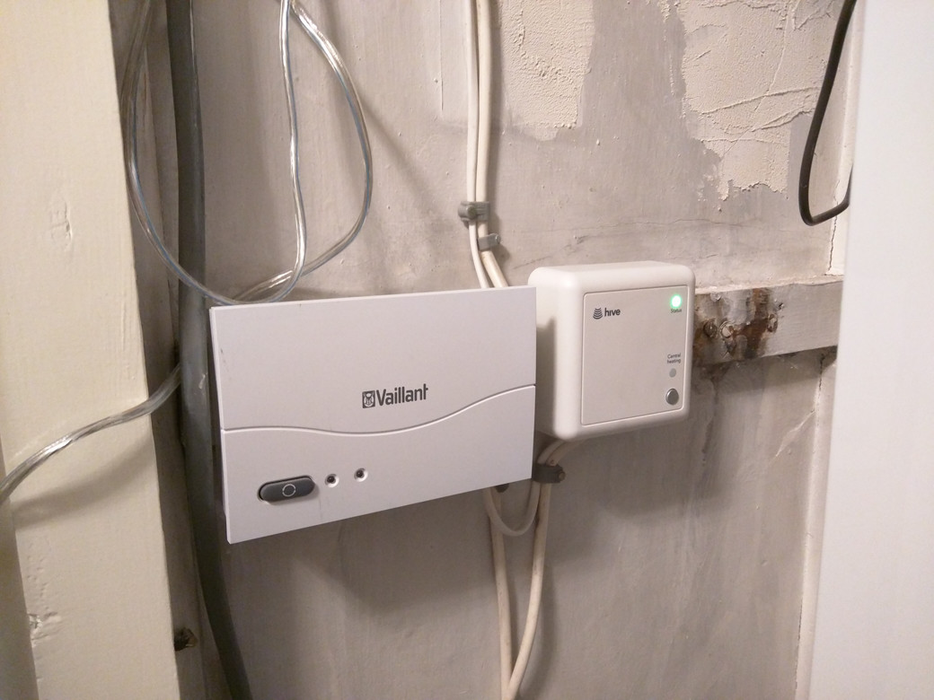

Thank you for your assistance. Cables moved and sheethed. Strain relief added (piccy). Job done and all is working now.
I also noticed some stray wire strands left from the original installer inside the wiring/pcb section which I hoovered up - couldn't have been me, I didn't cut anything.
